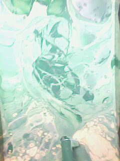

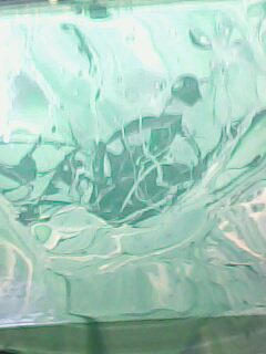

This is what my colour looked like whilst miging it to required shade. I wish I could get EXACTLY that pattern on the bonnet :roll:
Image Image

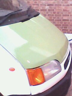

And here it is on Lola :D
Image Image Image
Image Image
Yes I painted the handle too just to see what it would look like :lol: :lol: I am only half way through and just starting on the sides of the doors with brush... getting late, but I want to have the passenger side done. Also the colour is actually little bit darker than on pictures and I still think I am going to make it even more darker during secon coat... :? If only those small insects didn't try to sit on it all the time :evil: :evil:

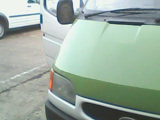

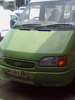

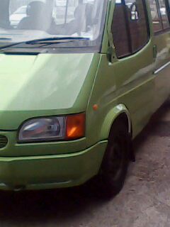

Here she is during daylight. Or should I say - her newer half :lol:
It dried a bit brighter than I anticipated, but it's still just a first coat, so I will make it darker on the second one :?
