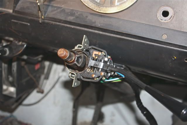

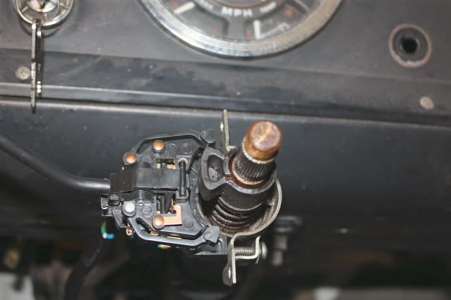

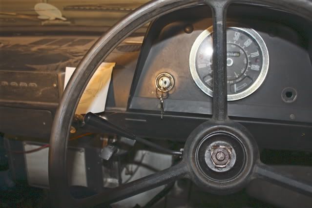

The multiswitch for the indicators, lights and horn was munted, with a horn button out of a series one landrover screwed to the dash :oops:

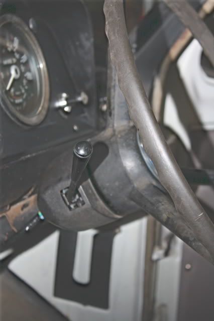

Ebay supplied an NOS unit that bolted straight up, as per NZ std, with the stalk on the right hand side of the column like so;

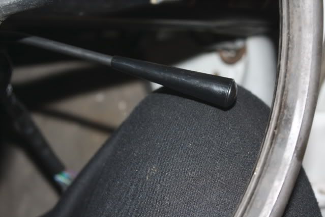

All good except for the proximity of the great fat knee :!:
Nice new stalk is not going to last long like this, it will get hooked and smashed for sure
A look at the column shows that theres a locating notch on the other side so we'll just put it on that side,
And take the wee indicator cancel bizzo and swap it over thus,
Put the steering wheel back on and ........... :evil: :evil: :evil:
That spoke across the gauge cluster is going to annoy the living sh*t out of yours truly.

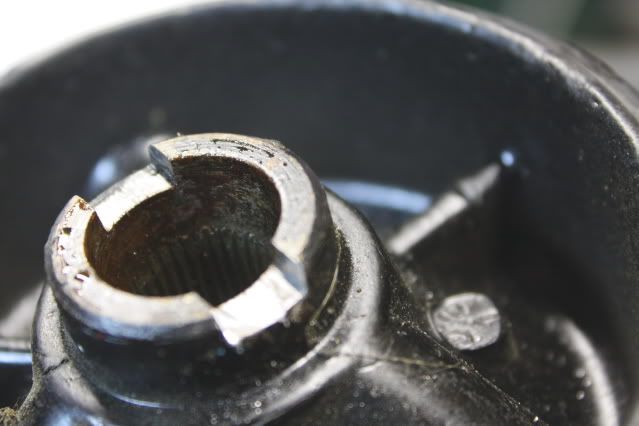

On examination the steering wheel has only got one notch in it to engage the indicator cancel lug so a few minutes work with a hacksaw and a die grinder and it has two.
Now every body be happy, everything works, and nothing is in danger of getting busted. Image
Just have to remember that the stalk is now on the "wrong" side of the column.

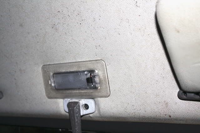

Another of the wee jobs was the interior light, the lens on the old one had gone crystalline and was falling to bits at every touch.
With no door switches finding the ignition switch in the dark could be a bit of a mission.
An ad popped up on Trademe for an inside light from a 2010 Transit that according to the seller would with a few mods fit an early Capri.
So it was duly purchased reckoning that if it fitted a Capri it would no doubt fit a MkI Transit. And it did.
Off came the wiring, the metal frame, and the spring clips on the ends, grind off most of the clip keepers with the die grinder and in it went. The trick is to just leave enough of the keepers on to lock it into place. I figured that out later, so had to glue a couple of short screws into place to act as clips. :oops:
Looks the part though, and no messing about cutting the opening with attendant risk of slipping and trashing the hoodlining.

you can turn the stalk if your carefull :wink: they are on a spline :wink:
Re: Pakeha Horse (Kiwi Mk1 Truck)
Postby not-a-jappa » Mon Jun 07, 2010 11:34 am
Wondered about that, .......... but every time I try something like that the outcome is very predictable, and less than productive. :cry:

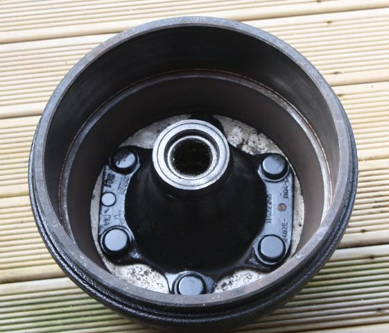

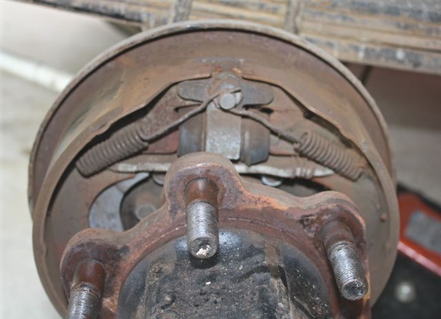

However we have made some small progress. Front brakes stripped, these were a real mess, been leaking for a long time, linings debonded, grotsville. Had so much crap on my hands I didn't dare pick the camera up. :(
Cleaned everything up, sandblasted and painted the backplates, honed and kitted three cylinders and replaced one, (only to find when refitting the balance pipe that mine had metric threads and the Indian replacement model had imperial threads :roll: ) had the shoes relined. All looks halfway respectable now 8)
Needlegun did a primo job of getting 36 years of painted over crap out of the hub centres

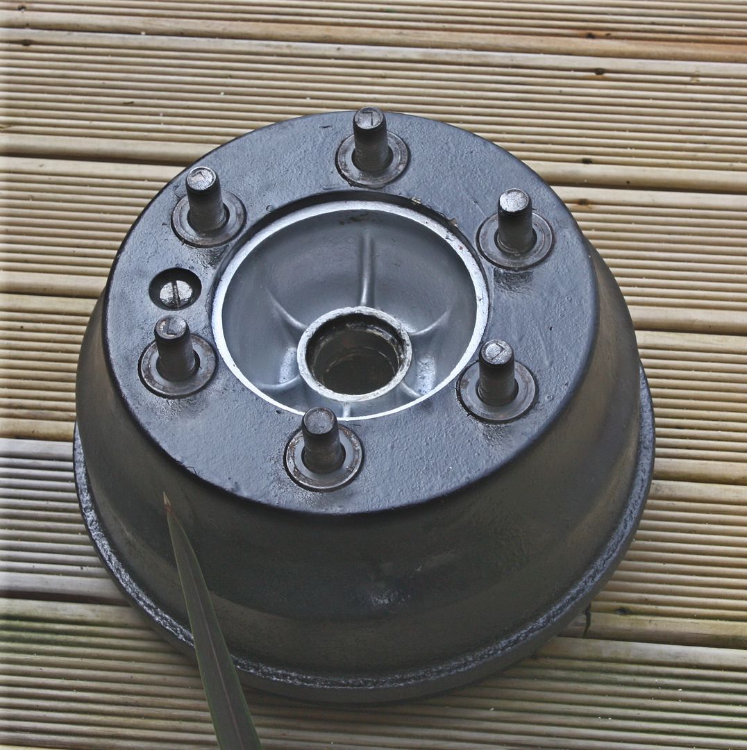

The studs knocked out of the hubs and drums easily so these cleaned up all pretty like as well.
:!: :!: One trap for young players that I fell into was thinking that I had the drums on the hubs tight. ................... A run up the road and back, and the wheelnuts were only finger tight. :shock:
:idea: Little truck is just like big truck, do a few ks and torque them up again, you won't have got them tight the first time.

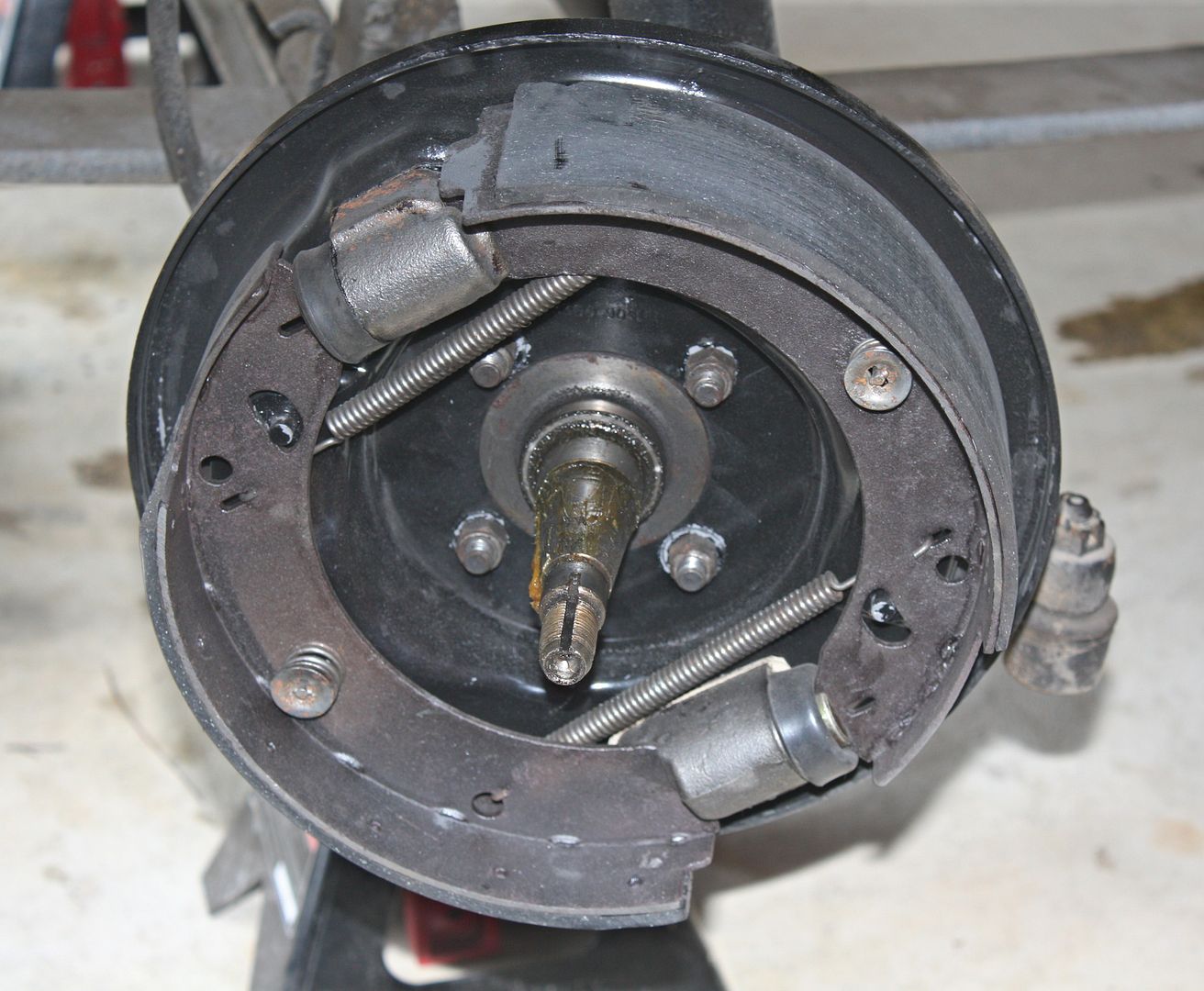

Just started on the rears, one hub came off easy, just put a square bar between the drum and the backplate and "leaned" on it and off she popped. The other was a different story, no amount of normal persuasion and abuse would shift it so cobbled up a long puller and wound it up, and wound it up, and wound it up, was watching some very hard bolts deform and had that vibe about broken steel flying thru the confined space under the mudguards when "thunk" off she came in a hurry.
However whats inside was a pleasant surprise, ordinary lining dust everywhere, JOY! linings in good shape, cylinders a bit sticky so a polish and new seals in them, a good cleanup and we'll be in business.

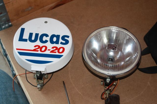

Picked these up the other day, 7" diameter 100W Halogens, brand spankers never been out of the box, bodies are cast alloy with glass lenses so they're heavy as hell. Might need to strengthen up the bumper mounts to cary them I reckon.
:lol:
Question; :?: Don't want to clutter the place up with any more wiring and switches than I have to so the plan is to put the relay into the high beam circuit so these come on with the high beams.
Is this a good idea or a silly one? :?:
