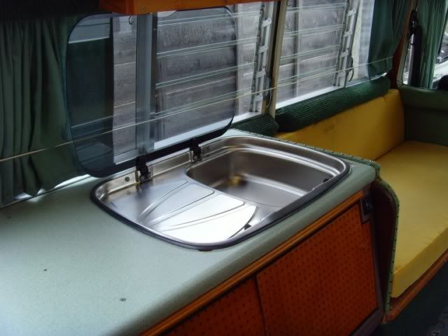

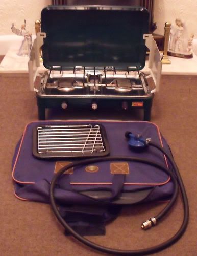

Hoping to go away for a few days next week so i`ve fitted a new sink but waiting for new tap and drainage fitting, bought a stove with a grill of ebay. Started cleaning inside and washed the seat cushions and pillow cases and had the hoover out :D

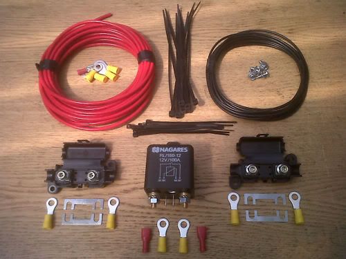

The campsite is booked up for Hookups :roll: so i`ve ordered a 100amp split charger and going to replace the battery with 125amp leisure type. Just need to rewire the radio, 12v light and the triple cig light thing so they run from the 2nd battery. The water pump for the sink and the tiny fridge is already wired.

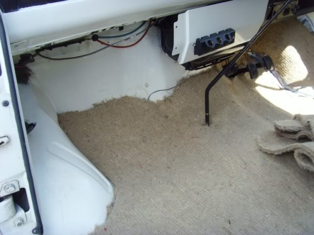

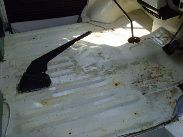

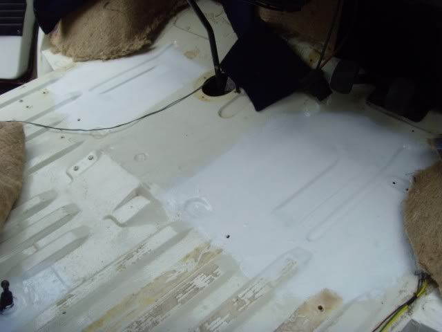

Ripped old carpet out of the front cab, found a little rust
Sanded
Painted
Sound deadening going down

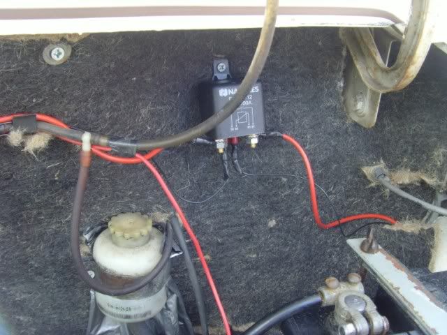

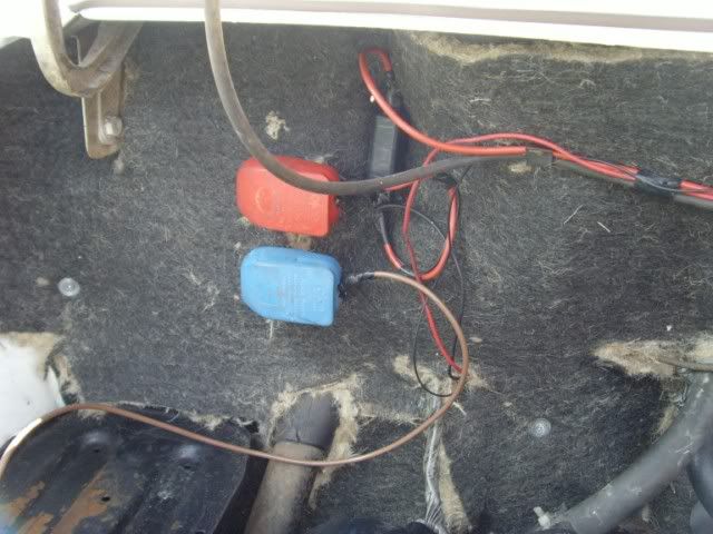

Sound deaning on the bulkhead and split charger installed

Postby Neil » Mon Jul 18, 2011 5:36 pm

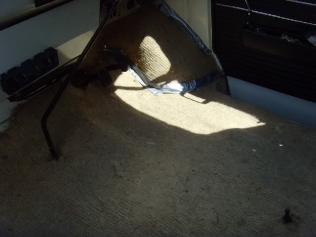

don t mind me but should that felt not be on the inside of the bulkhead :shock: :?:

Postby davev6newman » Mon Jul 18, 2011 6:36 pm
It would have been easier to do it on the inside and then covered it in carpet i think. But nether the less good job done.
Could also stick some to the underside of bonnet, if your not too worried about the look of it.

Postby montym100 » Mon Jul 18, 2011 7:02 pm
It`s not finished yet guys lol, the felt goes all the way up the bulk head on the inside just that i had to paint the floor 1st and then i ran out of spray adhesive for the bulk head section. The carpet is already cut so hopefully tomorrow the front cab should be finished, more photo`s to come
The Felt in the engine bay is Fire retardant to BS FMVSS302 bought from http://www.woolies-trim.co.uk/c-126-felt.aspx :wink:
