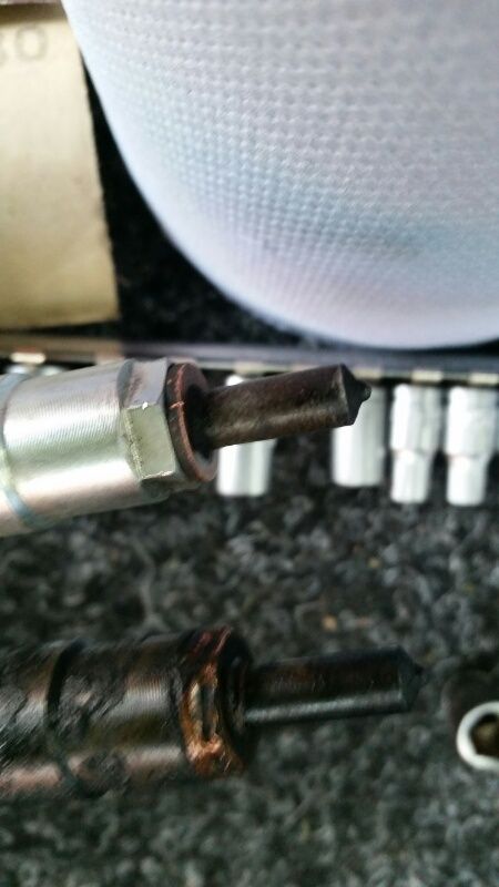

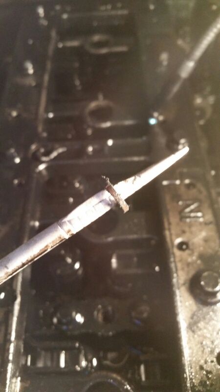

Started doing the injectors.
Old number 4 is looking a but fooked :lol:
I struggled to get the extra washer out.
Cleaned everywhere up and need to replace the rocker cover tomorrow, got some pictures of the faces on my endoscope which I'll post if i don't forget :o

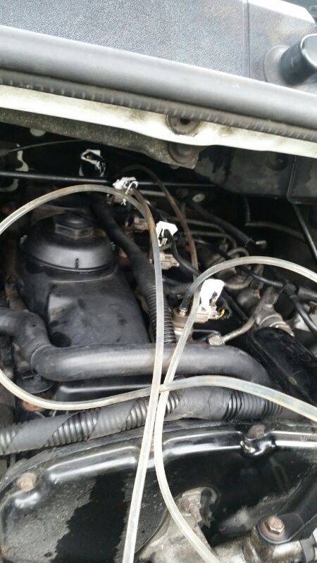

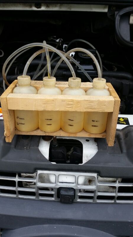

Leak off test results are in.
Old.
4 mins@tickover
1@32ml
2@34ml
3@36ml
4@51ml
New nozzles and pins on 1/2/3
28 pounds injector off eBay (always questionable but worth a go at that price)
Results
1@30ml
2@30ml
3@26ml
4@25ml
Tolerance is 25ml to 40ml
Looks like a result to me 8)
I don't have the facility to visually inspect spray pattern or measure fuel flow, ids passed injector learn on the second attempt, suspect i should have given it a good run to clear all the air out and lubricate the pins thoroughly.
Nonetheless they passed ids learn so for now I'm very happy.
