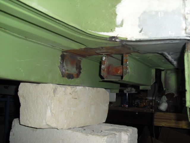

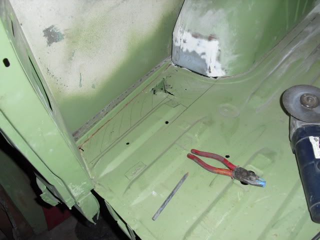

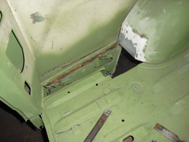

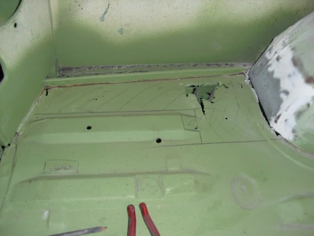

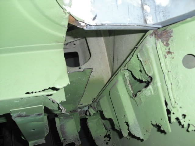

Watching from the back of the van, i saw that the left inner floor rear panel needs replacing. I drew some lines with a pencil and got
my chaser and cut off the offending metal :D
Cut off bad metal;

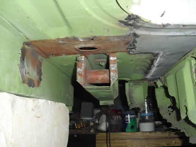

This view from below shows the extent of the perished rust;
I have already had made a new horizontal beam to go in here;

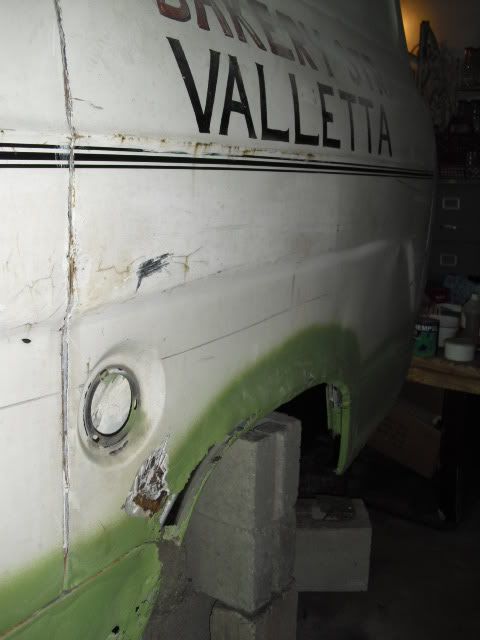

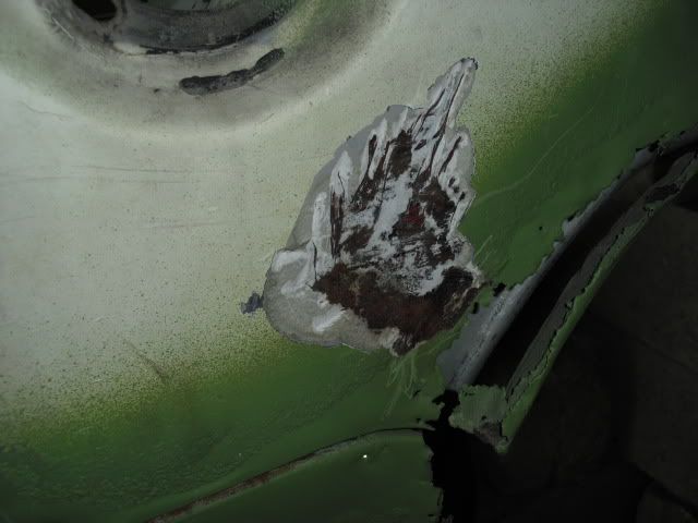

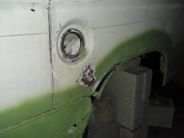

Starting to clean and Inspect the rear wing i found that it had a thick layer of filler below the petrol filler neck
and i was shocked :shock: as i had already had got a front arch wing to go at the back. And this was imposible to fit on.
remembering that my friend Karmnu was goin to break a Mk2 due to lack of space.........................................
..............................................I phoned him up to save me the rear part.................................................
................................as mine was beyond salvation................

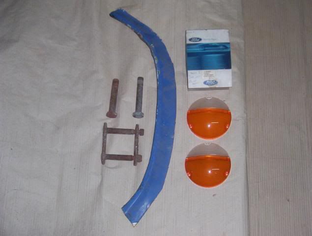

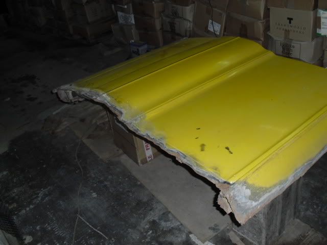

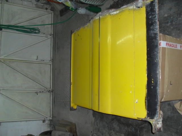

This blue part was cut off from a front mk1 wing to go to the back of the van as it has the same curves as the rear originals;
But now i 'm going for a whole wing.....

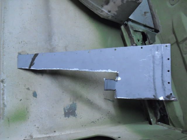

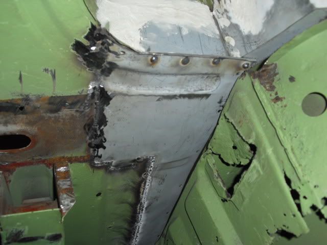

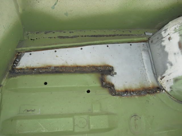

This evening after returing from work, i went to the garage and drawn a pattern of the part cut last week. I cut it to shape linished the ends were i have to weld and to the matching floor of the van and punched some holes were i have to plug weld and here it is. :)
I test fitted and it came up quiet well. :)

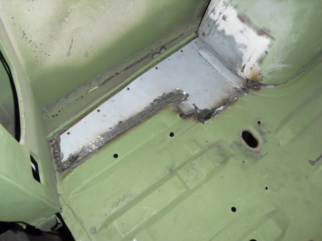

Finally i welded it in place. Tomorrow i'll linish it with my grinder. :D

Today, I linished the new part i made with the grinder;
And spot welded it from beneath to the wheel well;
Then I took hours to chisel of the rusty outrigger, and i have bruises on my hands to proof it :lol:

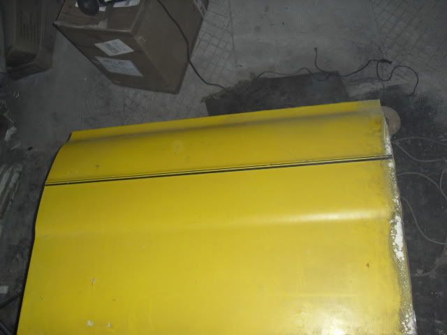

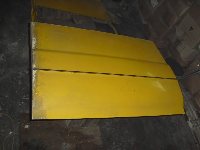

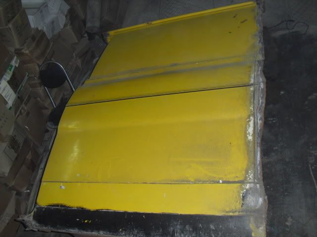

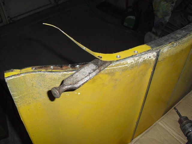

Today i decided to tackle the middle panel which i had bought. The part were the passenger's side rear s/door would be.
As you can see it has been cut a few cms from the edges going to be used. This below;

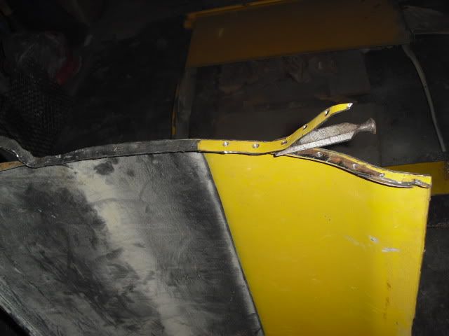

Then i cut with my grinder just the part i need, going round the edges leaving a few mm to trim off.

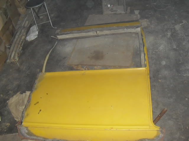

This is the usable part;
Then i started chiseling the spot welds and take off the extra bits;
This is going to take me some time to clean , so i ll contiue next week. :)
