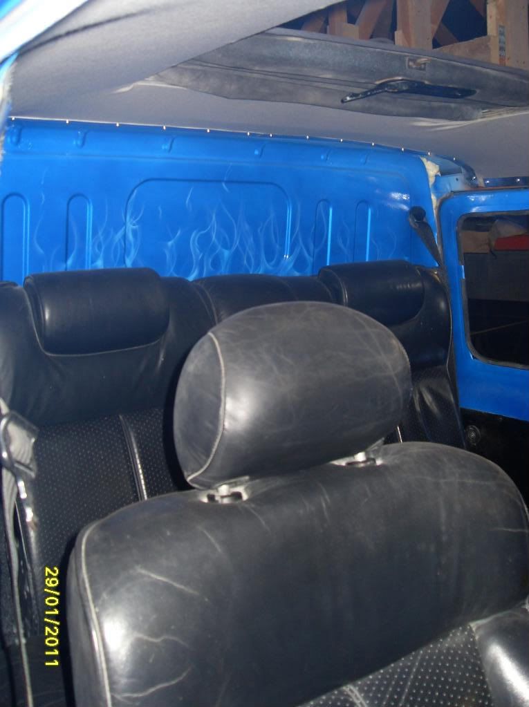

I will try and get more pics up when I can. Got the turrets in and pas pump on.Fan belt fitted.Oil filter fitted.Brake lines and new hoses fitted. The cross memeber is fouling one of the exhaust pipes so I will have adjust that.
Hope to test drive in the next few days all going well
