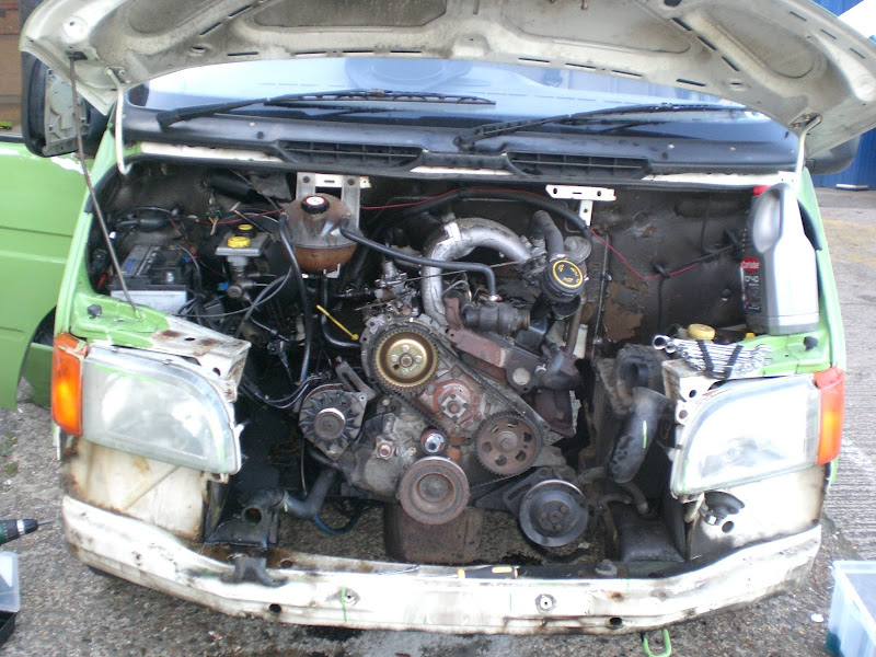

Postby AndyG » Tue Aug 18, 2009 9:55 pm
Unfortunately, despite a recent full service which included the cambelt, it does appear that the engine crankshaft is seized solid :shock: :( :roll:
Can not work out where the source of the oil leak is (yet), but I suspect it's to do with the vacuum pump :roll: (as it looks as though it's been spraying it around)
Whatever the problem was, it will definitely need an engine :!:
Posts: 27833
Postby Nadjenka » Tue Aug 18, 2009 10:06 pm
Thank you everyone! I'm starting to see it in colours again, I can't express how much your support hepls!!! AndyG has arrived and spent soooo much time here, even though it didn't bring Lola back to life, it certailnly brought back some smiles to my face as it gave me a clear idea what has to be done to get Lola on the road again. We did this to her, and looked right inside her searching for an answer why it has happened:
Althrough we did not find the answer for "WHY" it has happened, at least it's confirmed that the engine is seized. :( But - the challenge is on, 10 days to do it should be enough to get it moving (or towing) to Transitmania, it's worth a try. I am just increasingly worried that if I do make it to Billing, I'll have to bring a trailer full of beer as a thanks for all of your never ending support and help! :D Thank you all once again, I will not give up yet! :D

Andyg wrote:Unfortunately, despite a recent full service which included the cambelt, it does appear that the engine crankshaft is seized solid :shock: :( :roll:
Andy thanks for coming, I'm sure - as you said - the mystery will be resolved once we take the engine out. Can't wait to get the answer to "WHY" (note - it's not "why-God-why" anymore... :lol: ).

Postby Luke » Tue Aug 18, 2009 10:21 pm
might have been the seals in the vac pump leaking spraying the oil round - then the subsiquent loss of pressure and driving for those few minutes siezed it up :( impossible to tell unless the engines running - if you wanted to know for sure you could fit that alt & pump to the new engine and watch it - just be carefull :shock: :lol:
if you cant get the job done put the engine in the back and tow it to transitmania we'll all chip in and get it fitted and running - just let us know so someone can bring an engine crane :idea: :D
