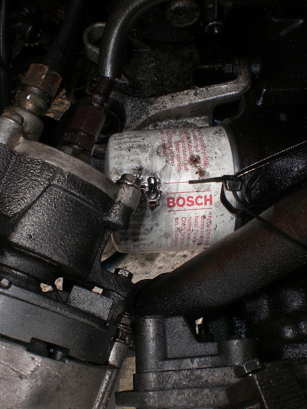

Postby Nadjenka » Sat Aug 22, 2009 11:32 am
I ahve found the hole number one. :evil: Could this be the reason? Is that under so much pressure? Alternator bolt became loose (the long one at the bottom that holds the alternator onto the adjusting sliding thing) and probably the tremble of my engine made the bolt drill thru the filter. Just the thought that if THIS is the reason and if I would stop right away ot the bloody double red there, it could have been up and running now - makes me nuts! Grrrrrrrrr :evil: :evil: :evil:
I can't believe this would cause the olil to explode all over the engine though... I'll see if I can find something else... :roll:

Postby ake » Sat Aug 22, 2009 11:47 am
The oil would have pumped out that hole at a fair rate with the engine running :(
Postby Luke » Sat Aug 22, 2009 12:00 pm
yeah 99% sure that will have been your problem :(

Postby Nadjenka » Sat Aug 22, 2009 12:32 pm
Oh, stupid woman! :evil:

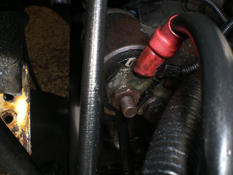

Right... It's out - thanks. I only have one spanner of the correct size though. :roll: But I talked to it nicely for a while and got it out now. Thanks. Next question - what is this:
do I need to unbolt the wiring or is there an easier way how to do it? That bolt is unaccesible with the spanner tool I have due to the bolt being too long... :roll:

Postby MR BigBeefy LDV Guru » Sat Aug 22, 2009 2:55 pm
thats the starter motor and yes the wires need to come out

Postby Luke » Sat Aug 22, 2009 3:03 pm
for the starter wires - battery off 1st :!: then undo them off the starter put a spanner on and give it a few taps to undo it that way it its tight it wont turn the whole lot round inside :D and bugger up the starter :(

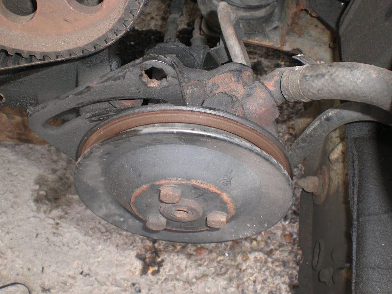

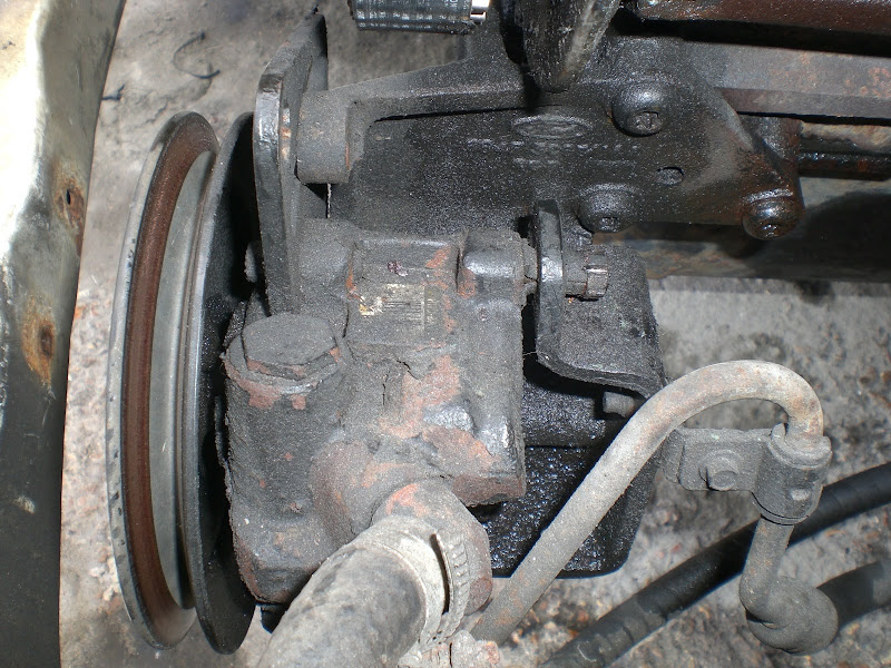

I bought another spanner sockets kit :evil: but the socket is just too shallow for it. Manual spanner does not have enough room to turn in there, I left it for now, maybe I'll have better access there after removing other stuff. I was under impression I can just unplug (somehow) the eleccy suply to it and take it out with the engine :? That's why I thought that maybe I am not supposed to unbolt it, maybe there is a way how to get the heat shrink off and I'll find a plug, but I wanted to ask before I try to do that. Thanks Fastmower, I understood and I'll try your trick. :wink:
Now I have further two questions: There are three torx bolts holding the power steering onto it. I have undone the bolt on the slider thing as suggested by Haynes, but the power steering pump (I assume that is IT) won't slide out of the way therefore I can't access the torx bolts holding the PS pump onto the engine. Am I missing something?

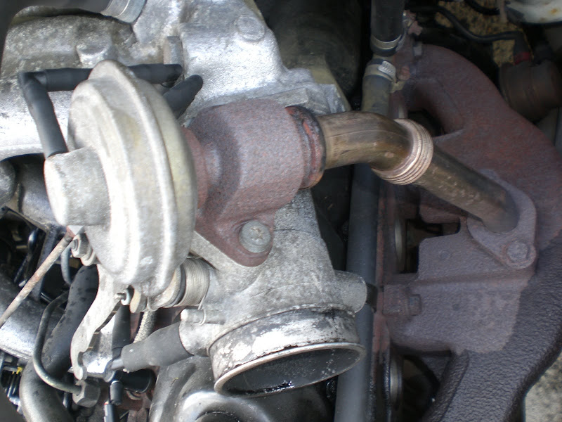

Postby Nadjenka » Sat Aug 22, 2009 3:37 pm
And the second question is about manifold. Haynes just says in one sentence that I should take off the manifold to create more room for the engine to come out. :roll: Now do I remove just half of it? Or do I remove everything on the engine so I can get to the bolts that hold the manifold onto the engine itself? This bit sould come out now when I lift the manifold
But the other side has loads of stuff blocking the bolts to the manifold. I thought I undo the bolts in the middle of the manifold, is that the way to go? Excuse my blond questions, just unsure what the right process is. I start undoing something and realise there is something else in a way. Then in undo the other thing half way and find third thing blocking the second one... :roll: It just seems I'm doing it from the wrong end altogether :lol:
