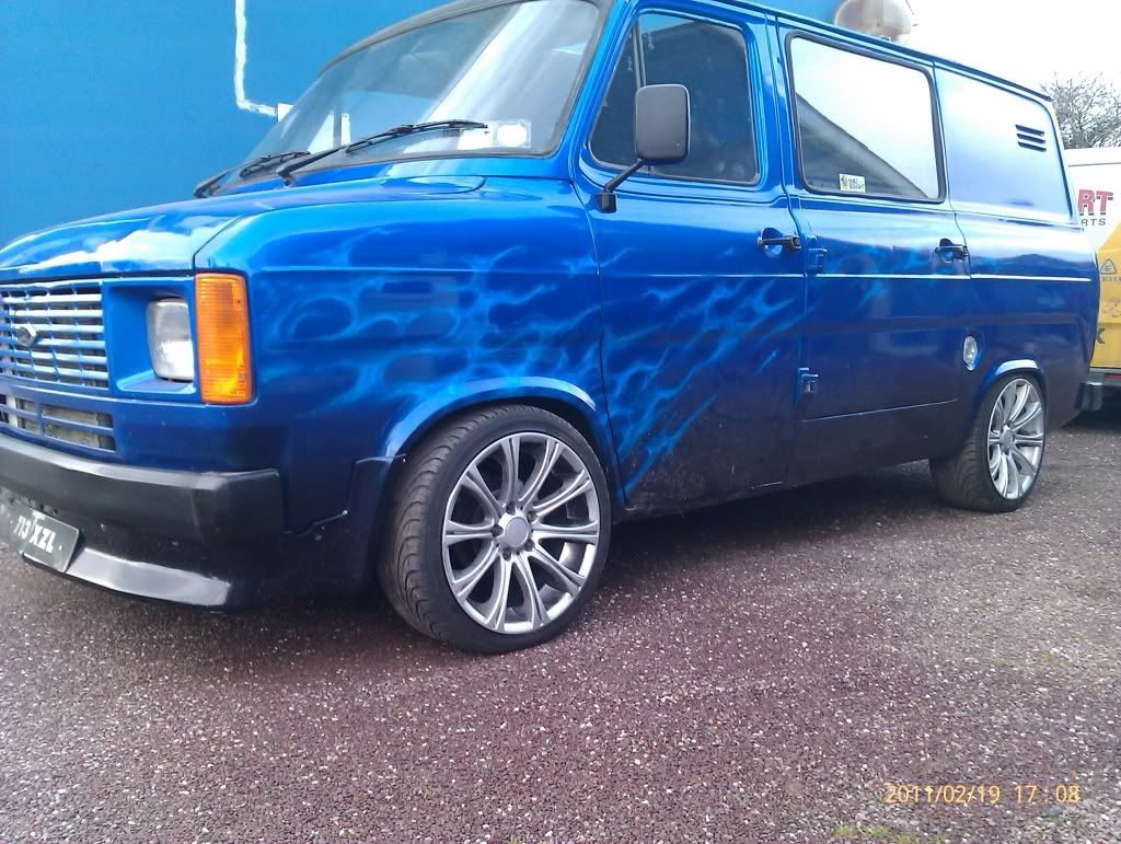

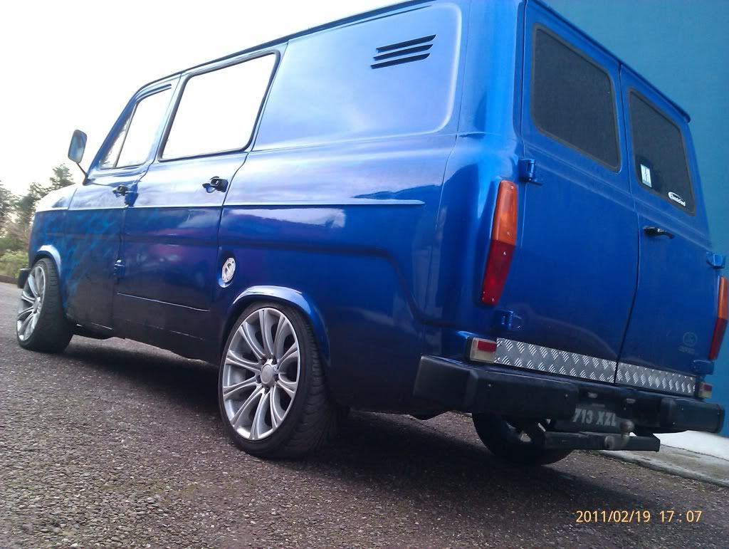

a couple of pics of it lowered.
Is it too much at the back?
Will it sit down under accelleration (loaded van look :D )....
looks fookin awsome 8) how did you get the back down?

Thanks
I decambered them.
Cosworth mk2 crew cab with IFS

I decambered them and used heavy duty front shocks on the rear to keep it level without making it too hard.
I will have to put on a panhard rod as I am within 25mm of the lip on either side.
Theres always somthing..... :roll:

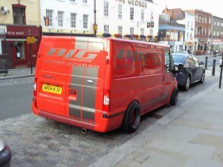

Tyre guy did not have correct size. So ties/ wed before over to try them.that Orange transit is the reason I am trying banded wheels as I am very impressed with it since I saw it first.also been doing research on airbags as i have access to hgv parts though my job.
