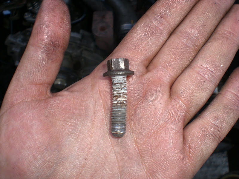

Again - I chose human approach and talked nicely to the manifold bolts :roll: Offered some WD40 and couple of swear words and here it is - the reason for my grief

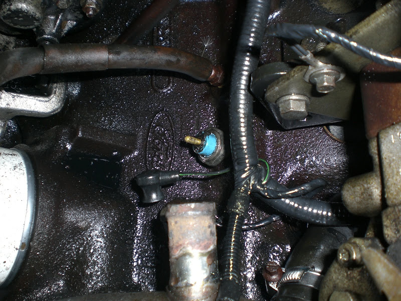

Don't know where to start on those fuel lines, but I have called the man of the day in again, because I'm sure I'd screw up that fuel pump and I don't want that. :roll: Removed half of the manifold, and back to the other side of the engine. I removed wiring from that blue pin, anybody knows what that is? I'm labelling all the wires as I remove them because I wouldn't know which one belongs where when the new engine goes in :oops: Drivers side of the engine. Can't find a picture of it anywhere, what is this?

Postby Luke » Sat Aug 22, 2009 6:51 pm
thats the oil pressure switch :D

Luke wrote:thats the oil pressure switch :D
Thanks Luke. It had earth bolted just next to it, right?
