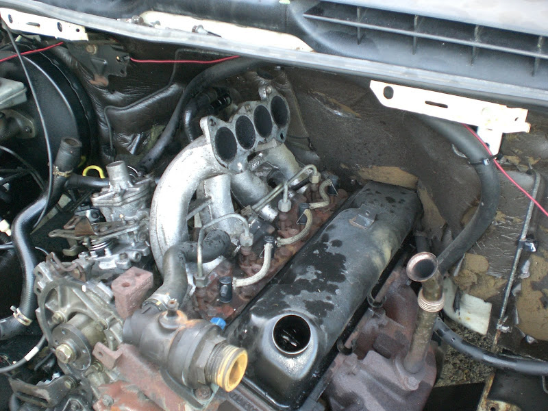

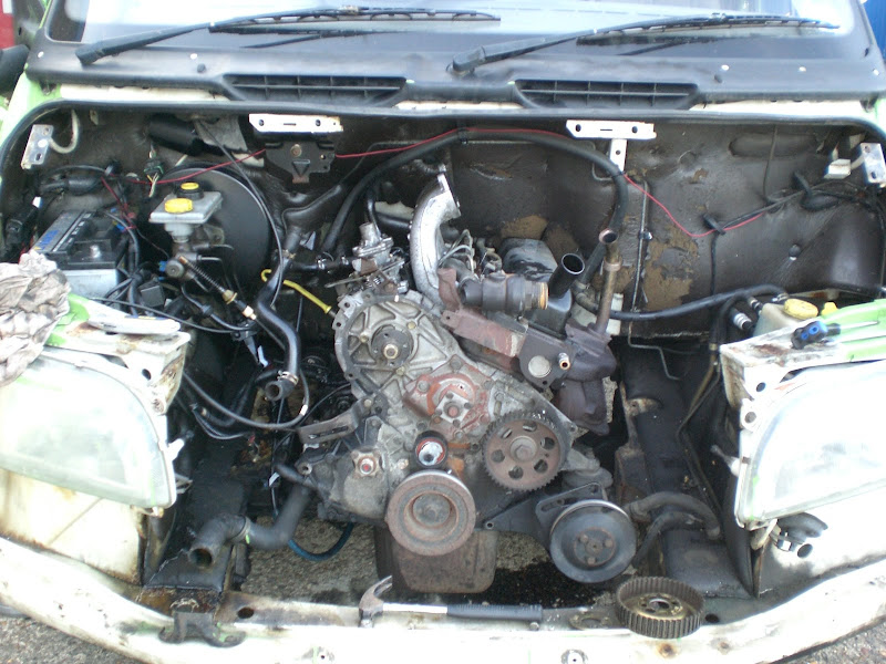

Luke wrote:not sure you do need to take off the banana manifoldhave you got the radiator out and the front slam panel off (slam panel is the bit the bonnet shuts onto)
markbradleyf1 wrote:Strewth; thats alot of work Nadjenka! Fair play to you, just watch your back lifting that heavy bonnet!
Hope the vans ready for Transitmania!

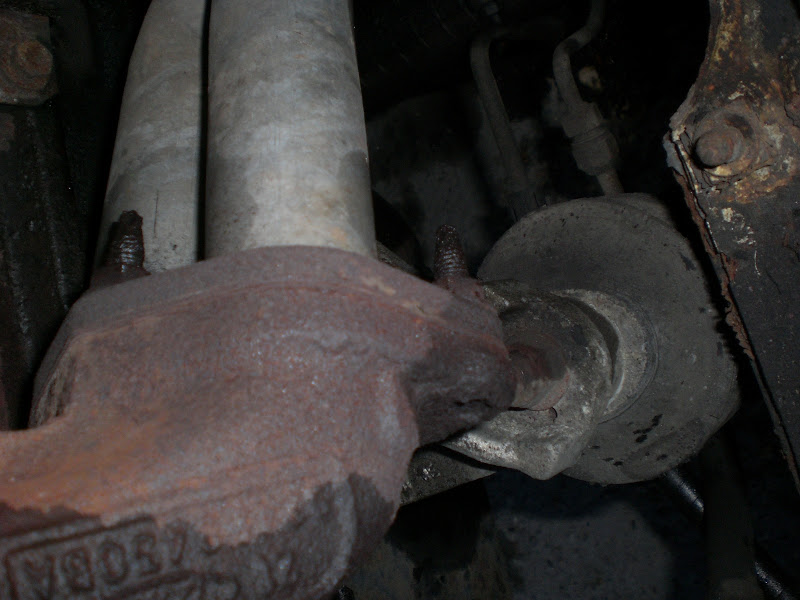

thats the manifold - yeah you can undo it thereNadjenka wrote:Those retaining bolts holding the downpipe are stuck. Can't get them off (talking to it and WD40 didn't help) - is there a way around it? What if I undo the whole rusty unit attached onto the engine?

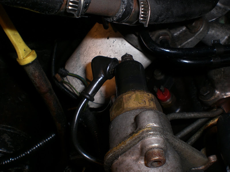

the fuel pump?? the wire will be the stop solenoid should just unplug but if you follow the wires back the whole engine loom should unplug from the van loom in 1 connectionNadjenka wrote:And - the pump again - there is a wire at the end of it which won't come off. The bolt turnes the wole rear rather than undo itself. Is there something I'm doing wrong?
Luke wrote:are you taking the engine out and leaving the gearbox in place
ah i see - i'd just break it off and crimp a new terminal to the wireNadjenka wrote:This is what I meant - I know it's not fuel pump, but it's close to itMy brain refuses to work now, sorry... And it's the black rear that spins with the bolt.
