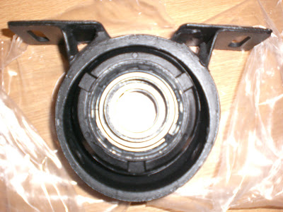

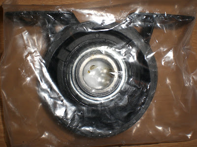

Postby Nadjenka » Wed Sep 30, 2009 7:58 pm
I called it that at the shop and he did understand what I meant and handed me the right thing :lol: The long spinning thing underneath the floor, has got two of these joint thingies and one of them is finished. :oops: Yeah, here we go again... I'll make a picture :mrgreen:
And yes, the one in Northolt. I was calling around and apparently they are the closer ones who can supply the pipes. 8) And he gave me a discount today whils I didn't ask for one... :shock: I must have looked really desperate :roll: :roll: So now it is my favourite shop :D
This one
Image Image
Nadjenka
Posts: 1723
Postby MinorMatt » Wed Sep 30, 2009 8:16 pm
Prop center bearing...
im suprised they kept that in stock! You should really replace both at the same time though, otherwise you will be doing it again in 6 months!
