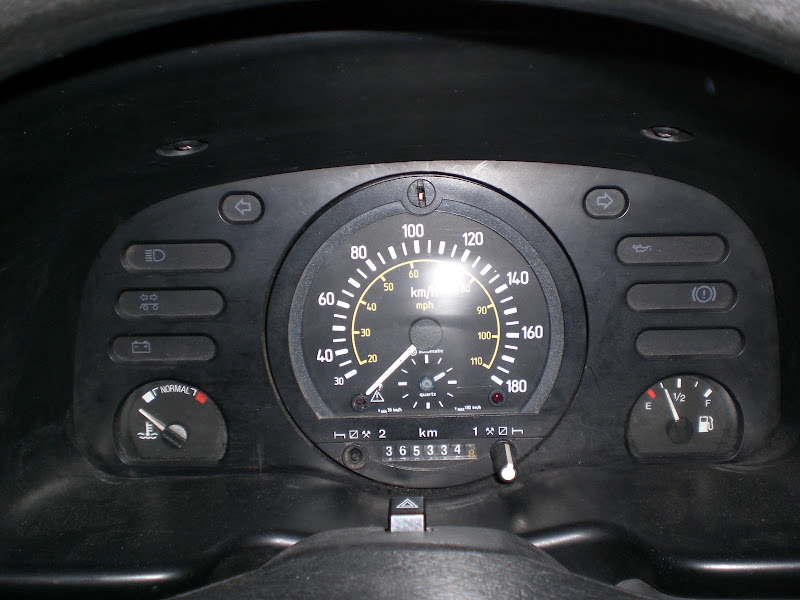

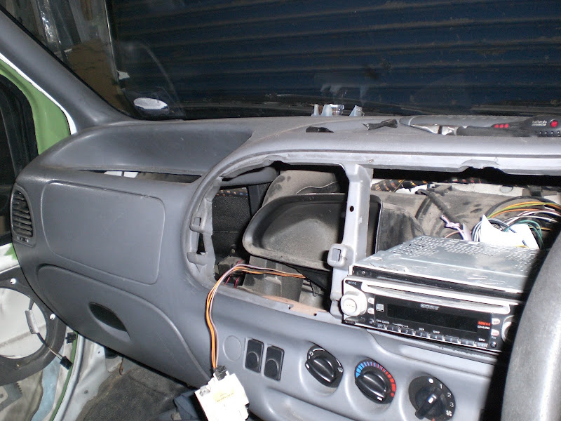

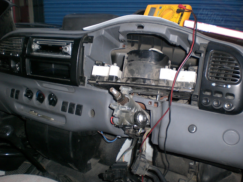

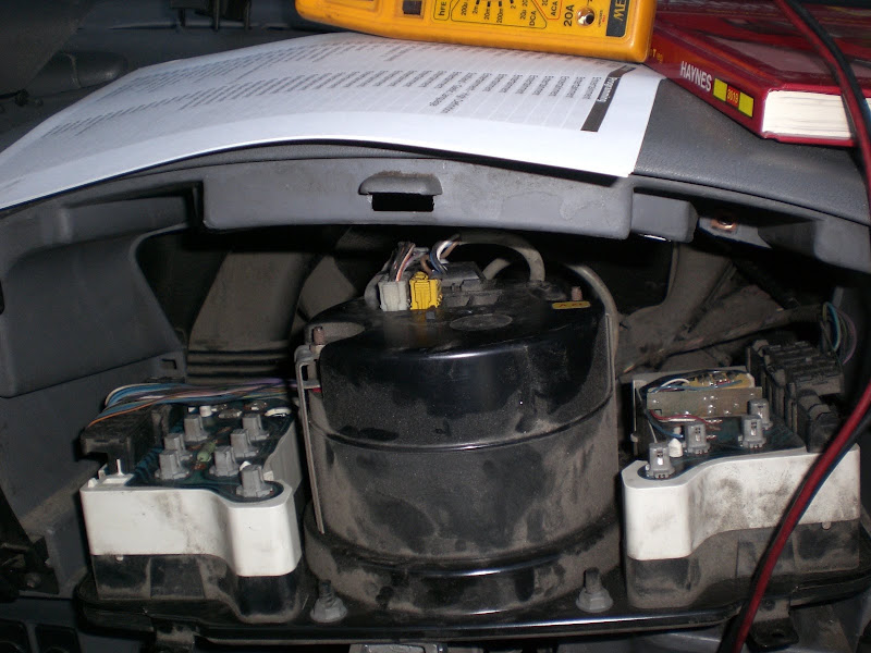

Something that was done earlier - I had that electrical problem, lights out on the dashboard and tacho, battery not charging and leaving me with non starting Lola.... :roll: Yeah, what's new... :lol: Thanks to AndyG that's sorted now. 8)

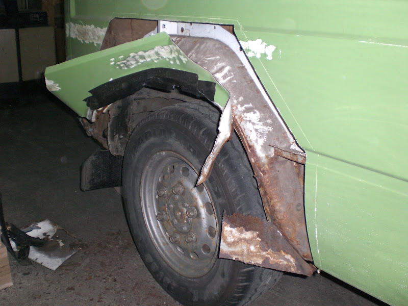

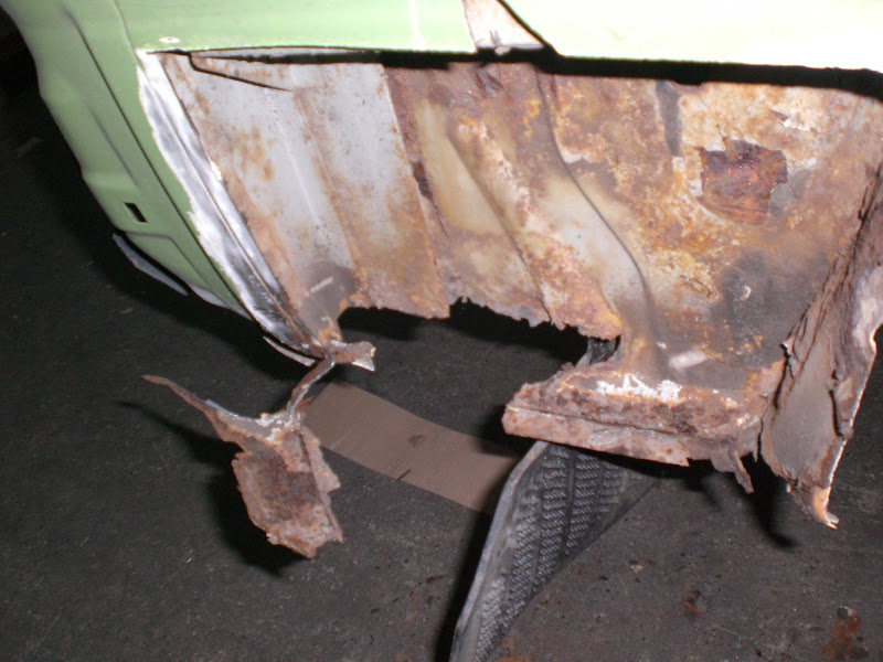

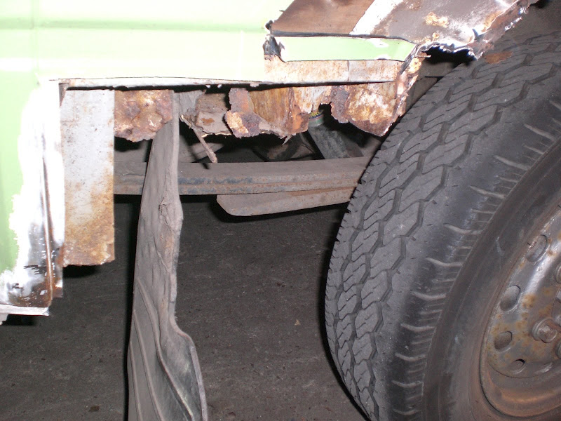

So I started on the rust. The end of gaffa tape... :mrgreen: Forgot to take "before" picture, but here you can see it at the last Essex meet,

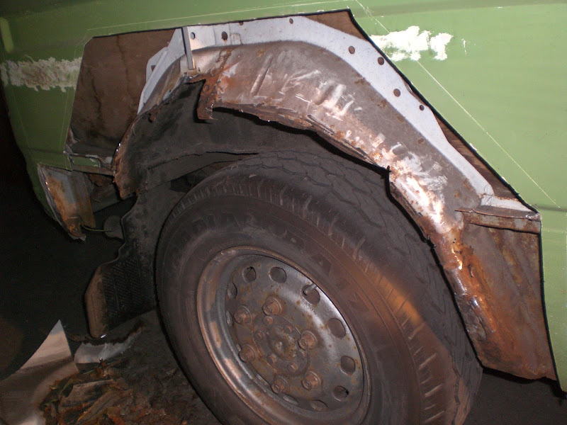

Let's cut it all out :twisted: My favourite power tool was very busy... so here we go - two cutting discs and one grinding disc later.
DON'T BE FOOLED!!! That's NOT metal :roll: Just underseal and dirt :evil: :evil:

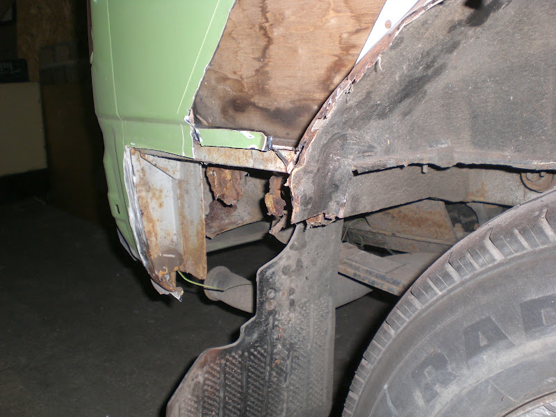

Ready. All ready for new steel. 8) Let's hope it will be in this century... :lol:

Postby dachre » Sun Oct 11, 2009 11:24 pm
get rid of that orrible rust... stick new panels on... then she'll be good for another 10 years..... :D .....yeay.... :D ...
I think one of the ways to make a Transit body last is the waxoil/rust proofing that some people use....
Are you going down that route after you put new panels on?

Postby Nadjenka » Sun Oct 11, 2009 11:27 pm

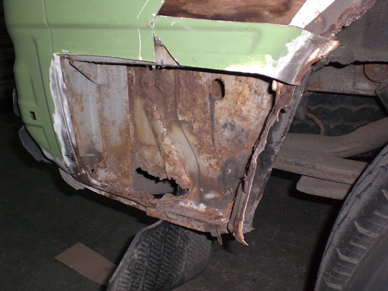

Yes Dachre, I'll have no other choice. Since I've decided I'm doing it properly - I will need to put the underseal on. It seems to be the only thing holding it together down there :shock: :shock: I thought I didn't have that much rust, but as I grinded the inner side of the box away, parts of the thick steel thingy back there has fallen apart too. :cry: There is no steel left, just very thick layer of underseal :roll: I just have to decide if I want to try structural welding too, or I'll call a professional for that... :oops:

Postby dachre » Sun Oct 11, 2009 11:34 pm
Go for it..... :D ...
No point in paying people to do the work when you are more than capable to do the work yourself.
I think all Transit go in that area...... mine did...
There's no difference between welding jobs on the chassis/floor of the van when it comes to structural/non structural joints. Just most people will use slightly thicker steel for structural use. It should all be 100% welds, no worries.

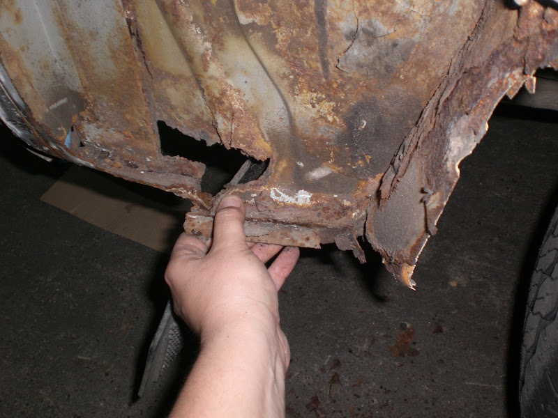

Postby Nadjenka » Sun Oct 11, 2009 11:48 pm

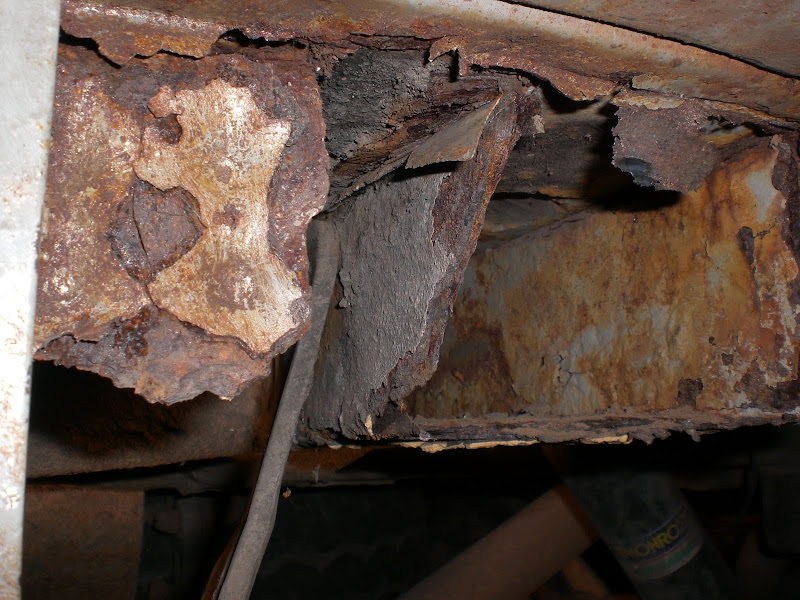

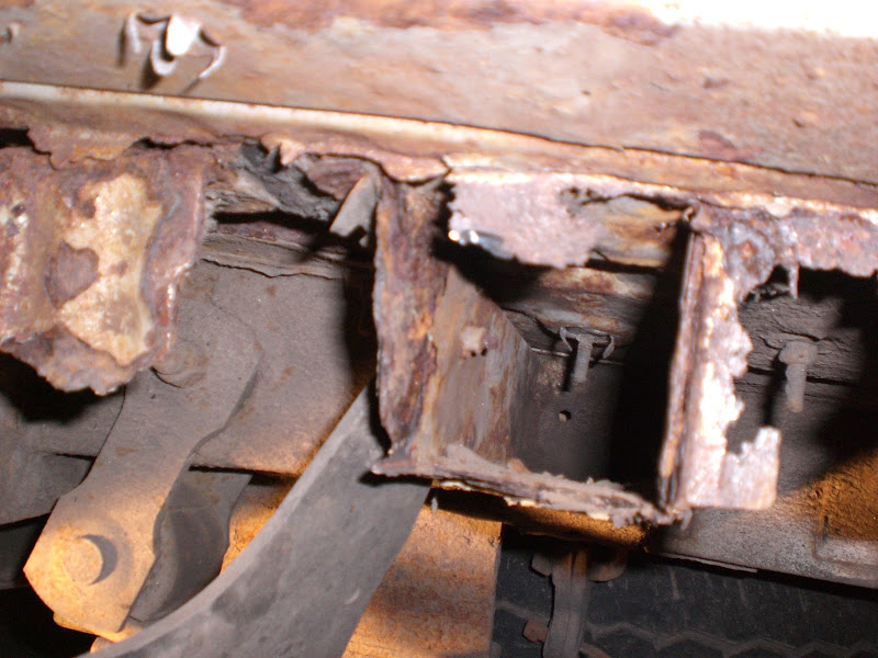

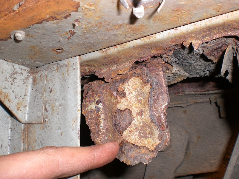

This is what I'm talking about
It's the bit the mud flap is attached to. Not sure what it is, only started to look into it. That's how it fallen apart, but I think if I dig into it, it will go further :cry: There is about 2mm layer of underseal which was holding it together.
Also this bit will come off with the floor. Luckily it's just that corner that seems to be so bad. I cleaned the rest of it from underneath and it looks solid. What is this thing supposed to be for?
It's welded to the floor and if I'd poke it it would come off :shock:

Postby dachre » Mon Oct 12, 2009 8:44 am
I think the bit you are poking is a strengthening panel that supports the other panels that have rusted away..
All of that rusted area will need to be renewed. Although the actual Transit floor looks ok from the photos which is really good.
You can buy all of those replacement sections/panels or you can make them up out of sheet steel.
I made all of those parts up myself, and i used thicker steel then the Transit originals in the hope that they will last longer.
But that area is one of the usual rust problems. A lot of people have posted there re-welding of the panels in that area in their build progress..... Me and Inty are just a few.... :lol: ...
Its a really good feeling when all that rust has been taken out and the new panels have been put back in and painted.... It means that you have your camper for years to come.
Good luck with everything.... :D ...
