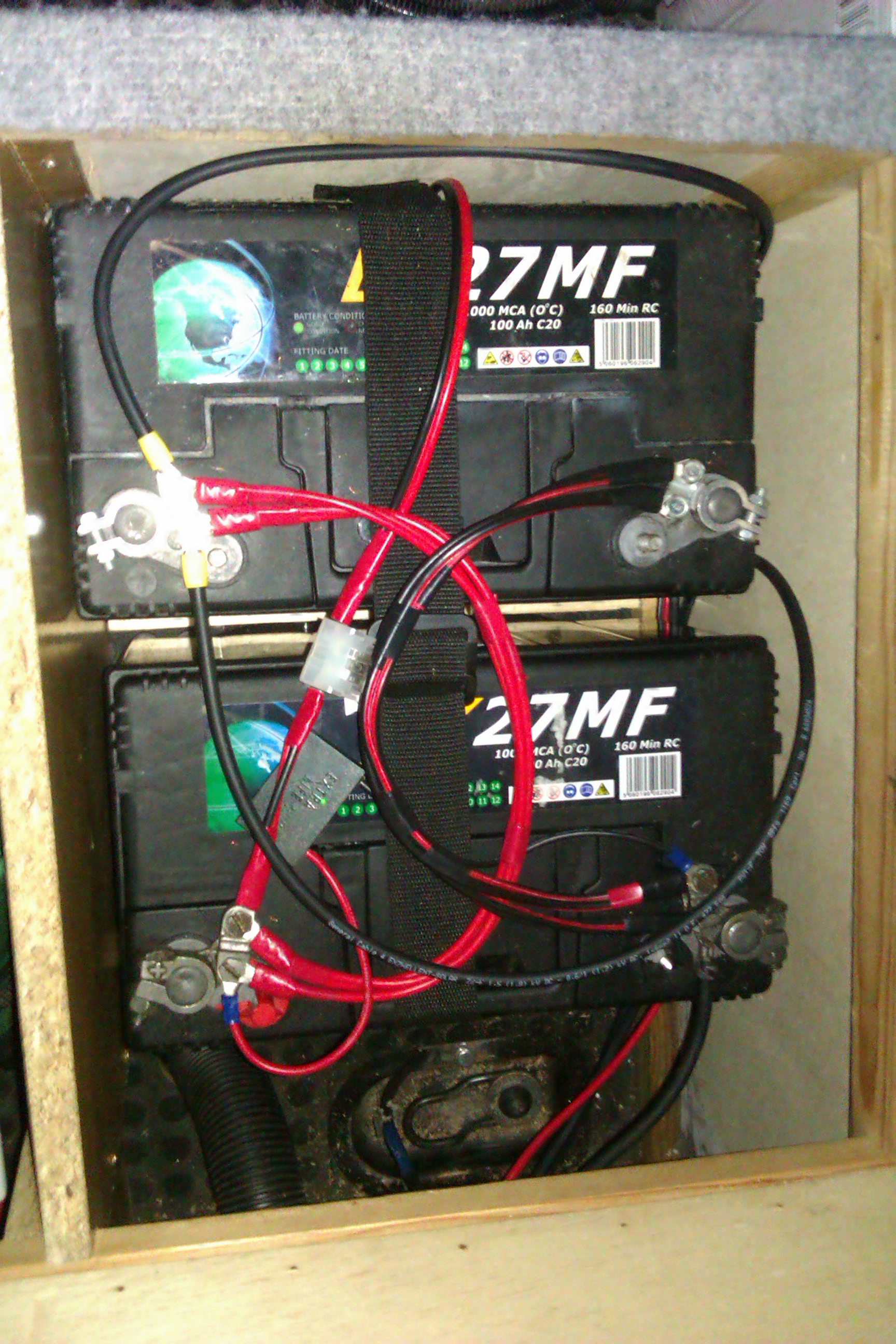

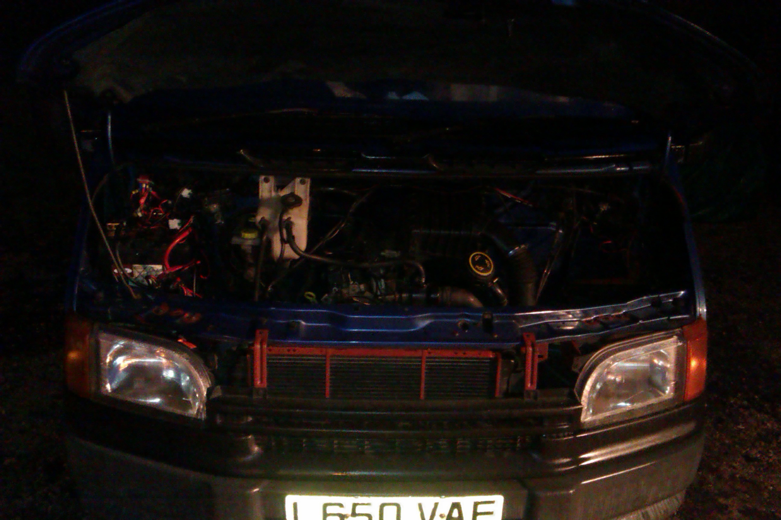

Decided to add a 2nd leisure battery so both have been moved to a sealed compartment under rear bench seat and vented through the floor with tubing. Really wanted to have it still connected to alternator so downed relay to 40amp and used existing wires (2x 4mm core) to handle current. Each cable fused at 25amp. Fingers crossed

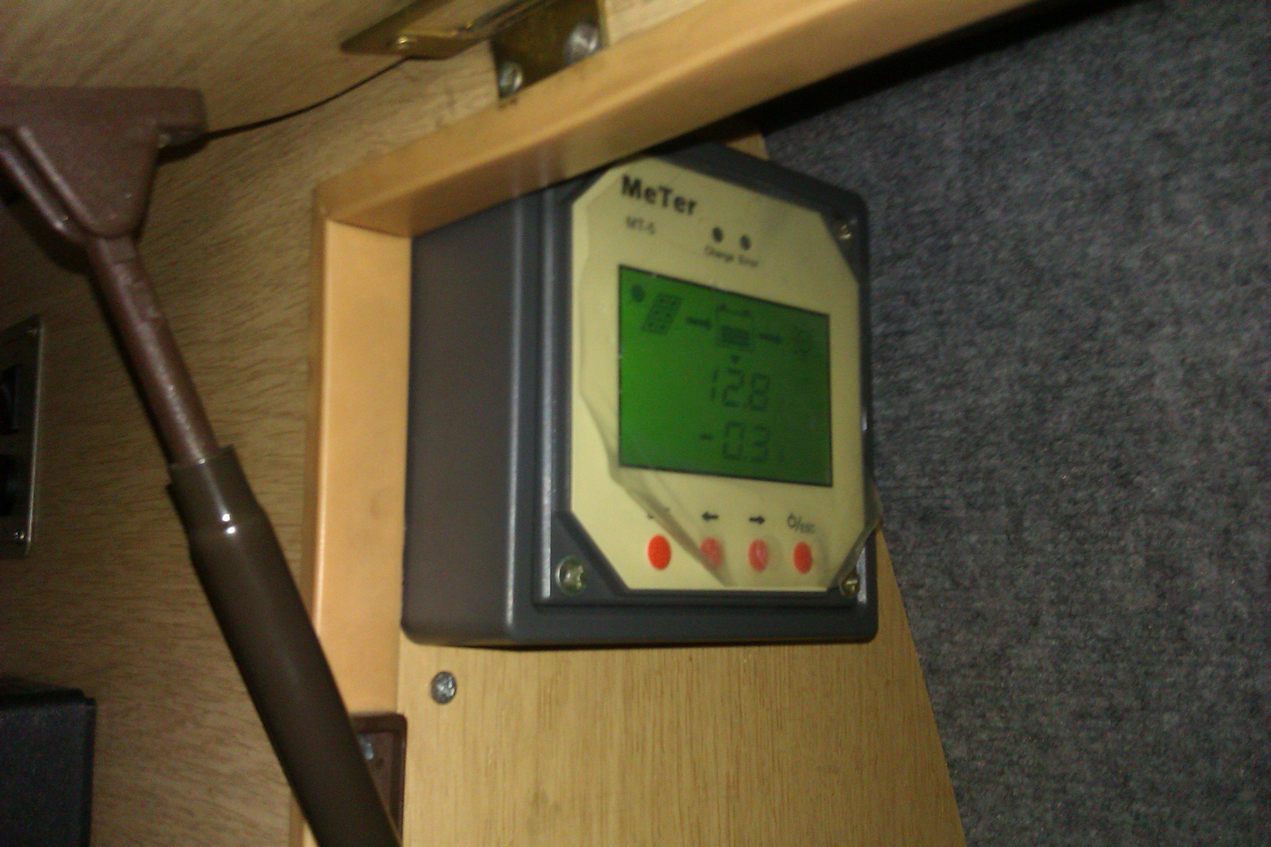

No happy with voltage drop after solar regulator. Used a lot of joining blocks, so will have to look into using fewer and making cable runs shorter for high current circuits.

Ran twin 6mm cable from 70amp relay to leisure batteries. 30amp fuses on each cable. Cable run is about 5 metres. Also added a switched before pin 85 with switch on dash to control charging.

Hooked up switched extraction fans on fridge vents and in solar regulator cubbyhole.

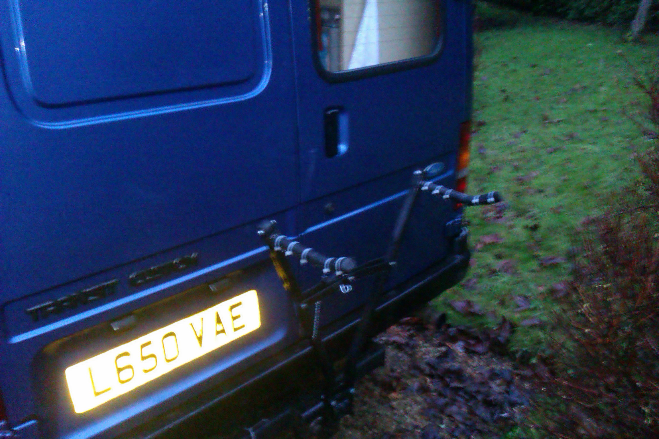

Dad decided he wanted his bike rack back so replaced with an amazon special. Will prolly need adjusting, but is adequate for my needs.
http://www.amazon.co.uk/gp/product/B00E ... UTF8&psc=1
A bit of pipe lagging to protect the metal, should be fine. Now lets hope nobody simply unhooks and walks away with it :o

Fitted new bike rack. Needed a bit of filing to make it fit, but for < £10, bargain.

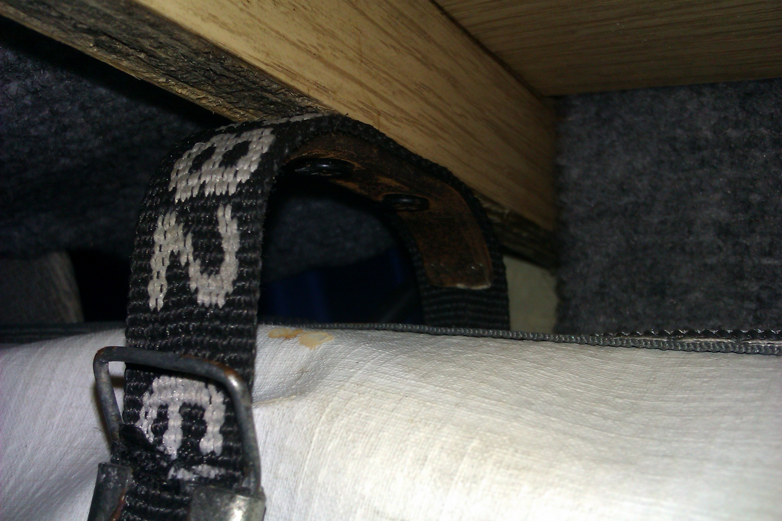

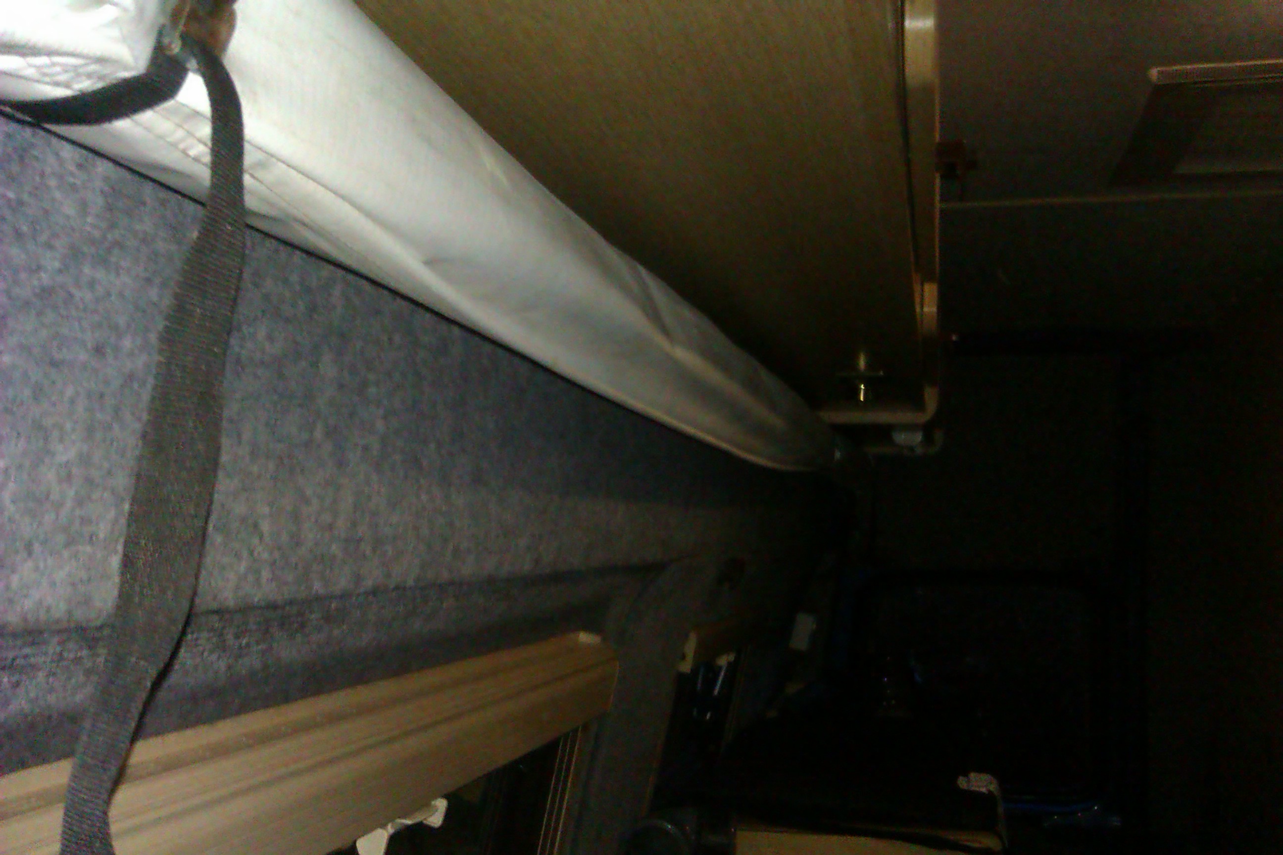

The awning mount - held up by 3 brackets.. Am thinking about adding a 4th as i worry about the water damage on the front bracket - which supports the front end by itself. Self-tapping screws used are for ceiling plasterboard (i think) and have a coarse thread with a diameter thicker than the shaft. Straps are Nylon from cycle sprint pedals.

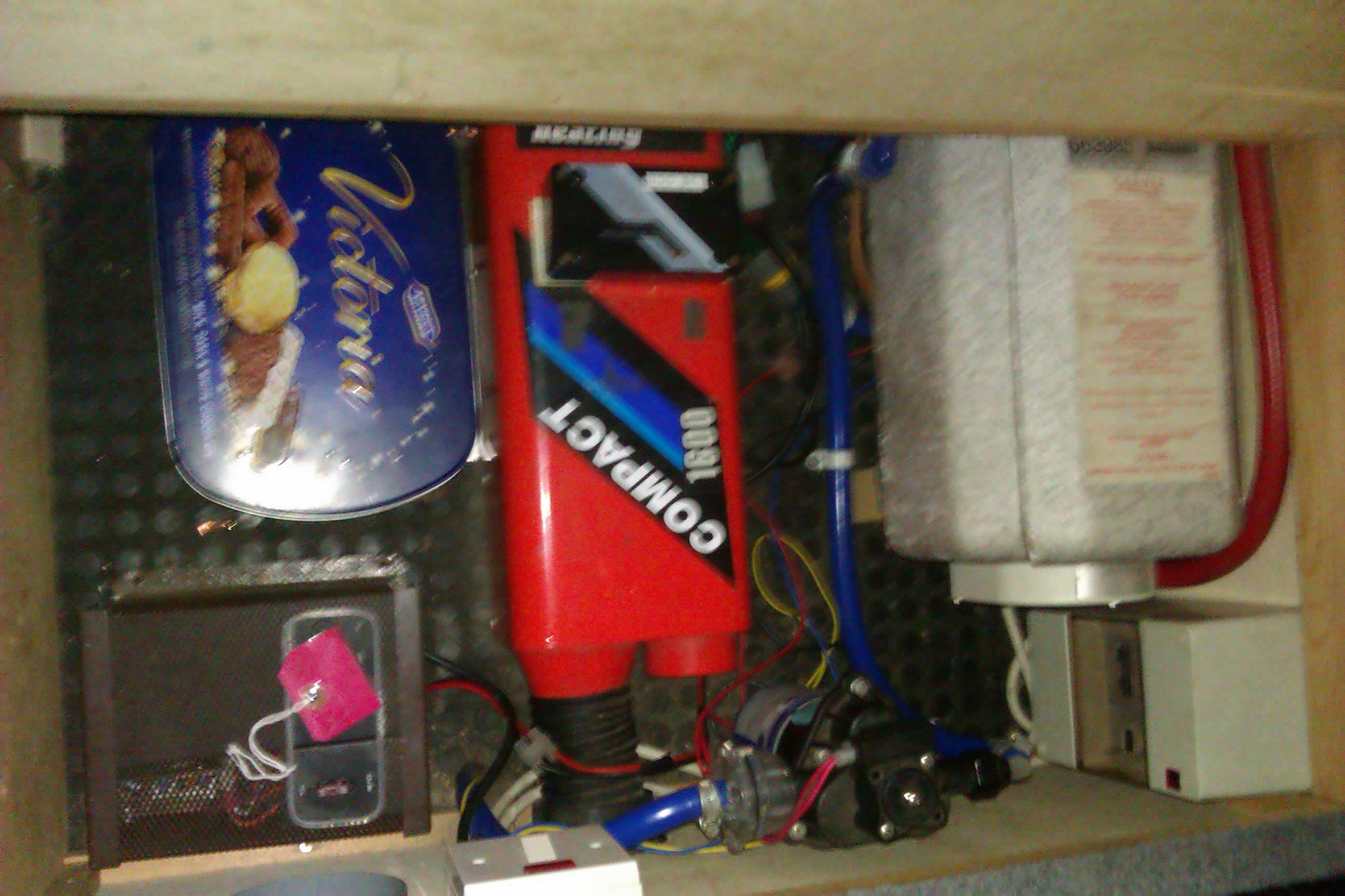

Two large black wires are coming from alternator. Fused cable runs up to the solar regulator. Other cables are made using 4 strands of 2mm cable as at time didn't have the 6mm cable. Ground is drilled into floorpan filler plate thingy. Also has a pulser fitted to keep sulphation to a minimum when batteries discharged. Not found my other one yet.
This is just the remote monitor. The regulator is behind the board its mounted to. The cupboard space has been reduced to allow enough room. A fan has been fitted to ventilate into the overhead cupboard.

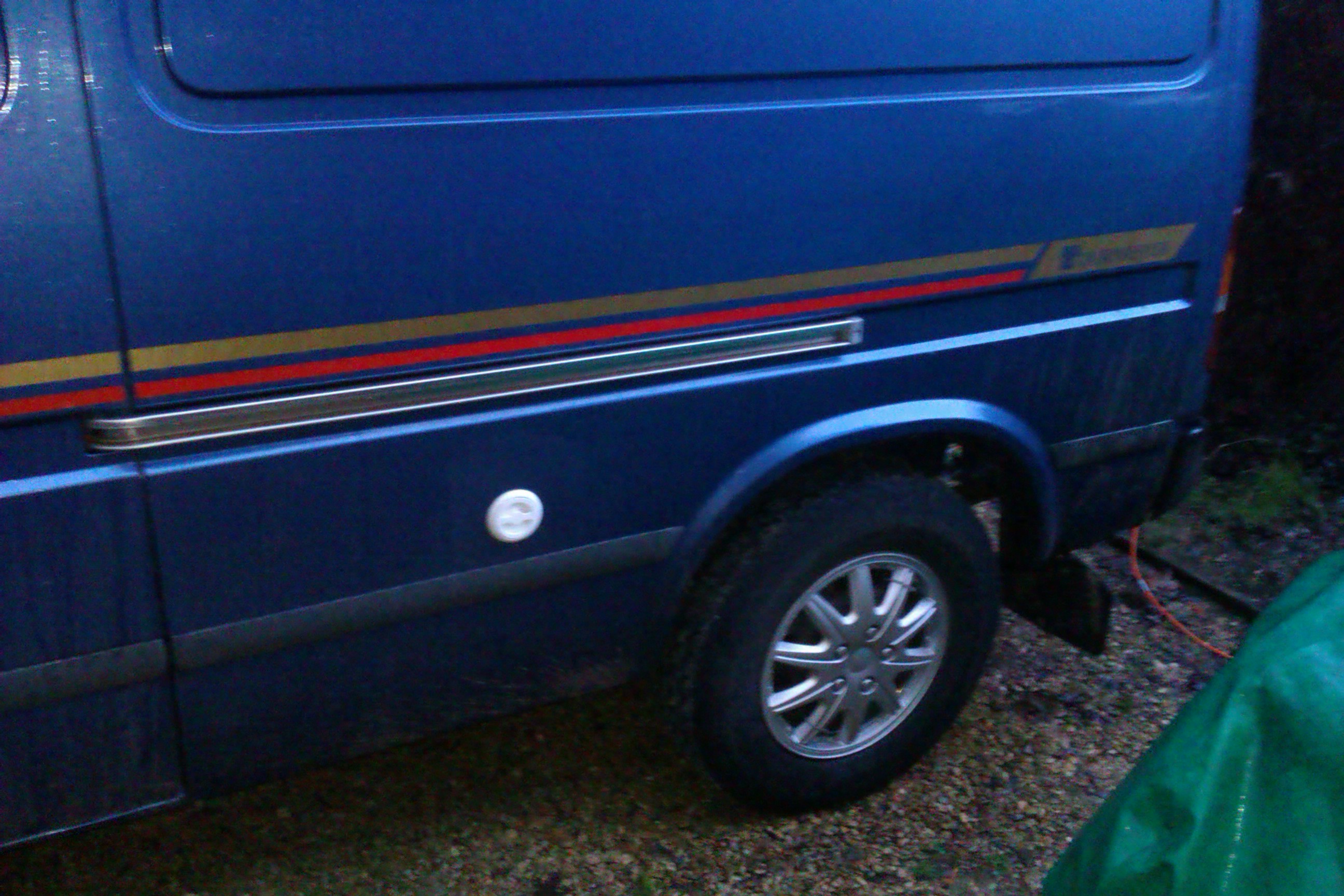

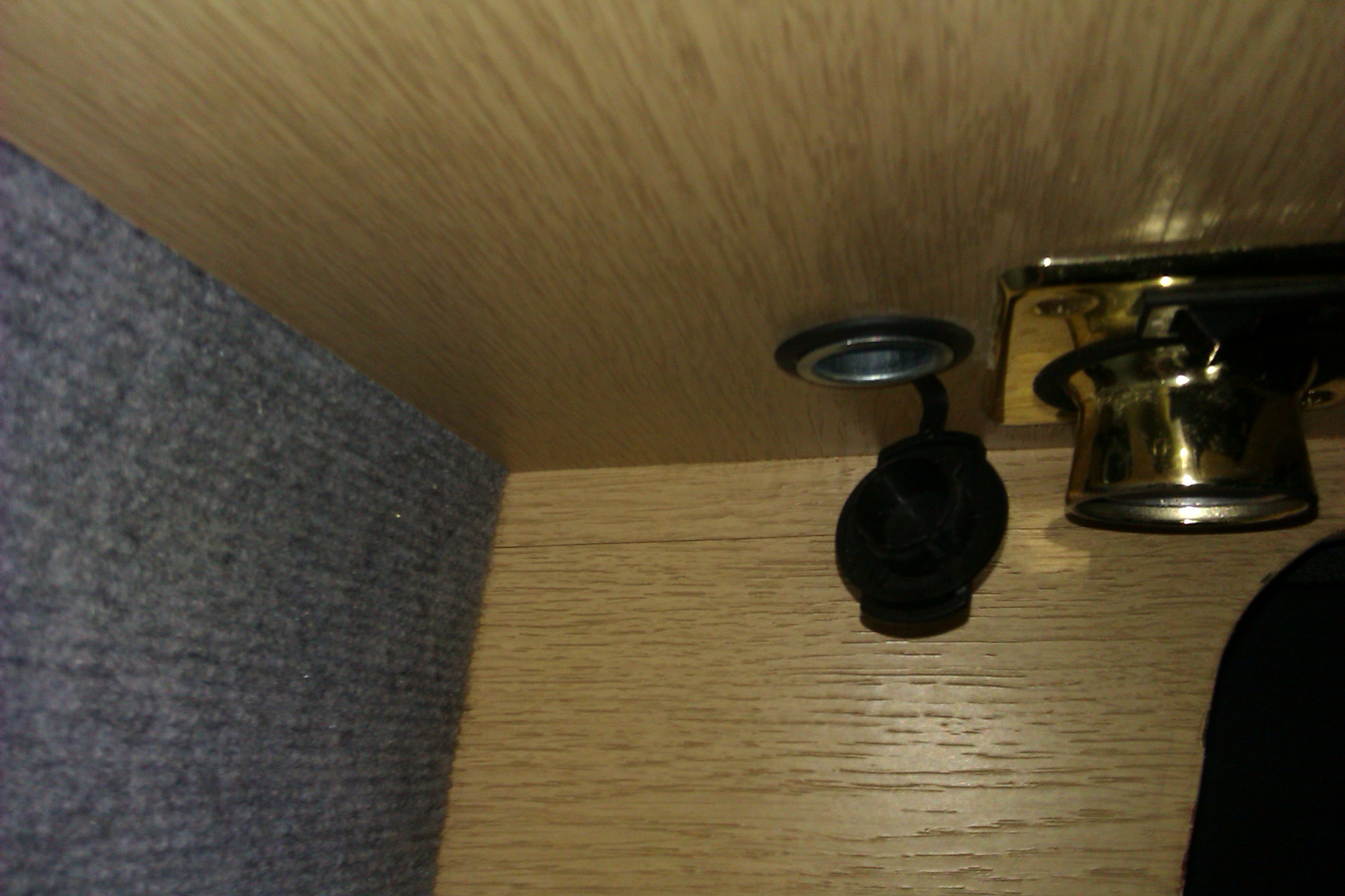

Cut the hole for gas filler using some ancient tin snips going round in ever increasing circles. Newer ones couldn't cut the metal. Chinese rubbish!
Yea! Nice wheel covers.

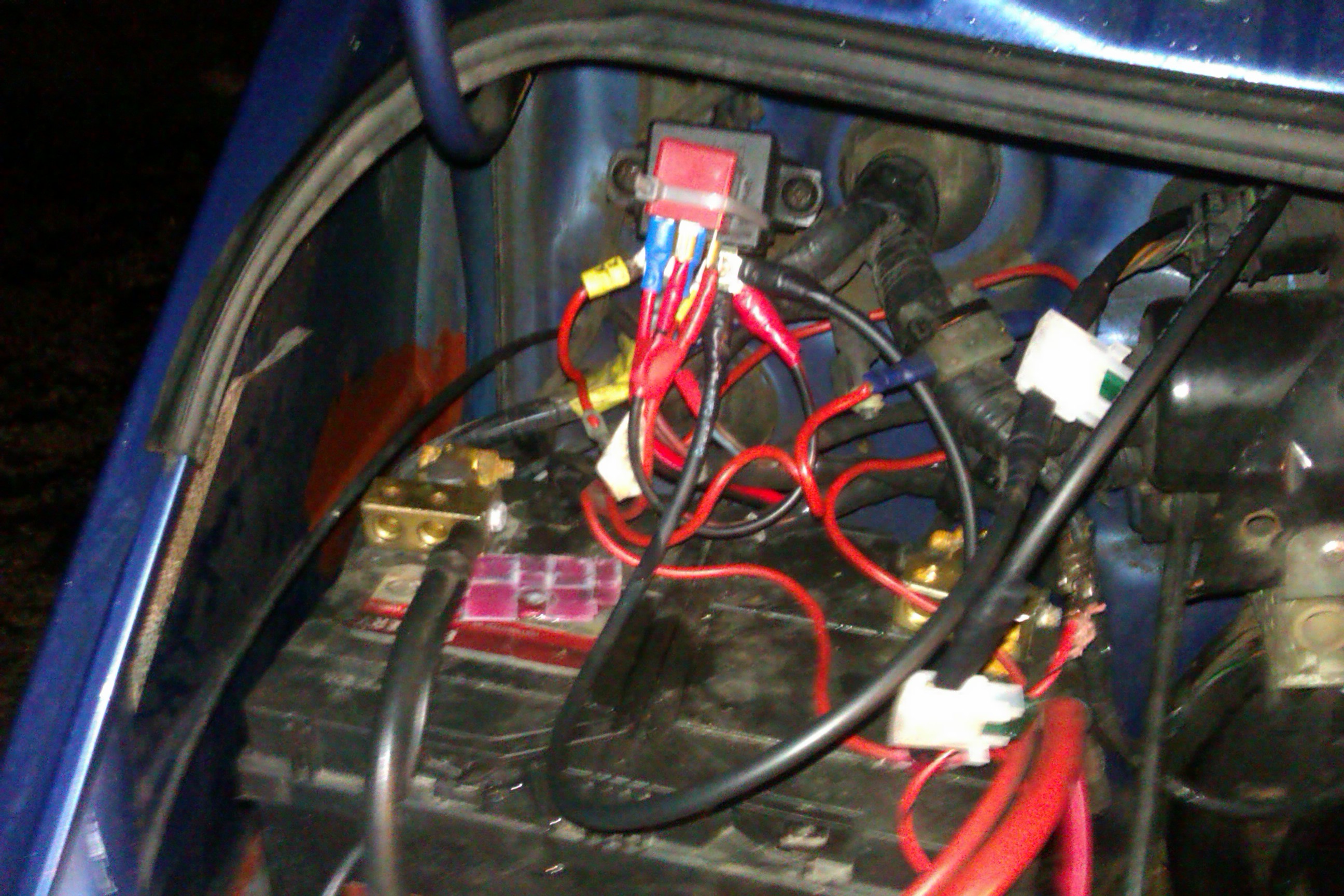

That blackjack roofing tar really makes a nice seal under there.
Messy wires. Will clean this up one day.
