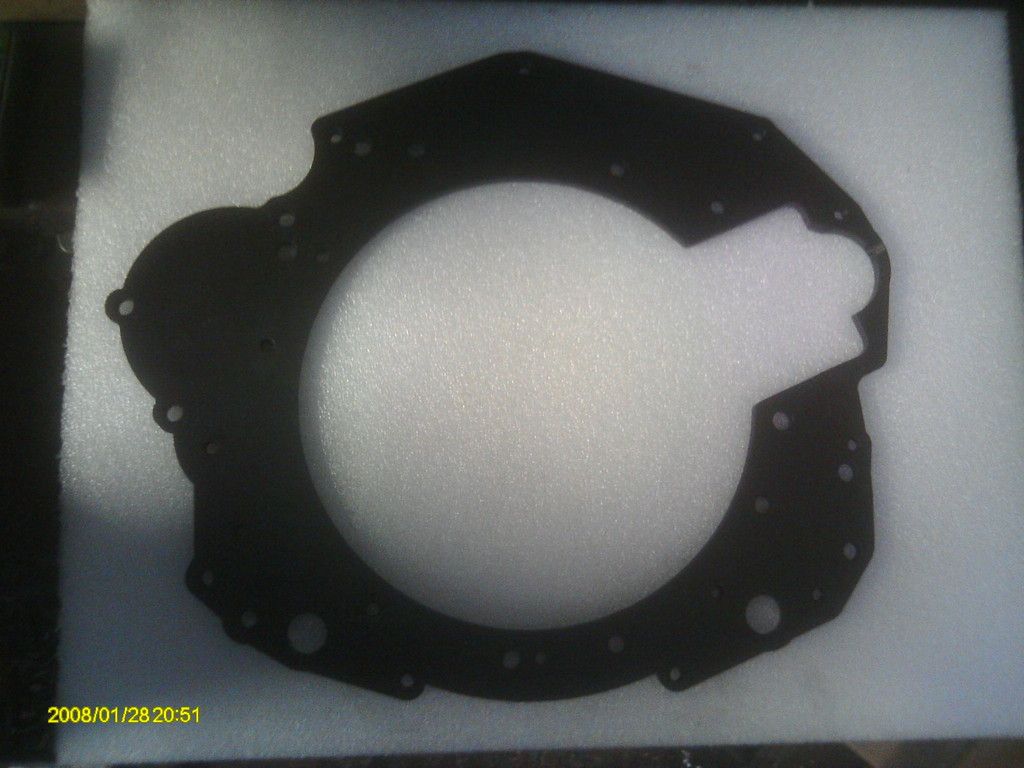

Pics of the parts included in the kit.
The Adapter plate;
The spigot bearing/housing and the clutch pivot spacer;
These parts have now been sent off the the member who will continue posting progress regarding his installation.
