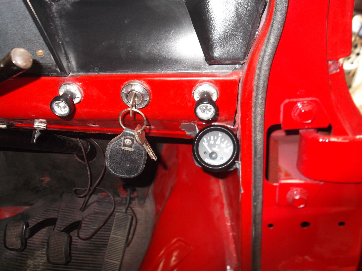

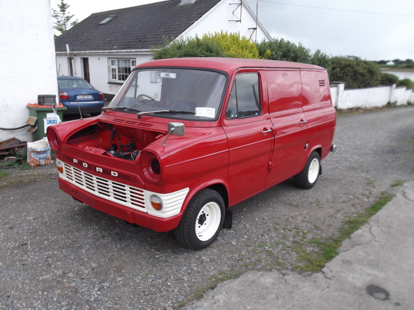

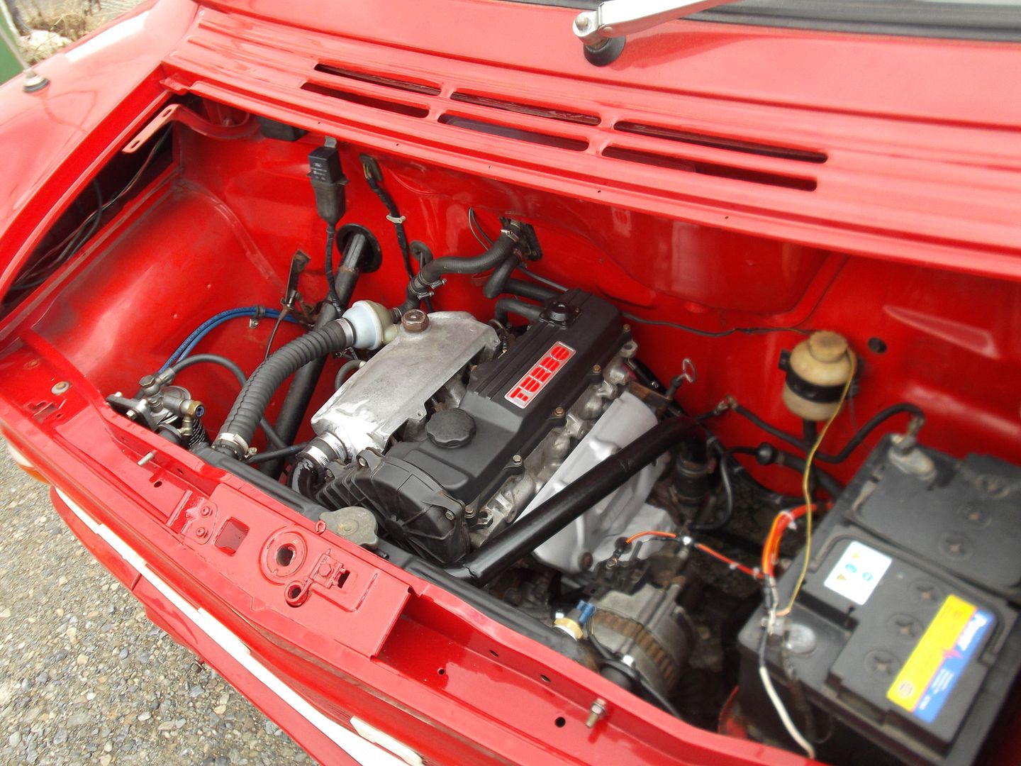

i fitted a aux temp gauge as a temporary measure to keep an accurate reading of the coolant temp on the first runs. hope to hook up the original gauge when im happy all is good.

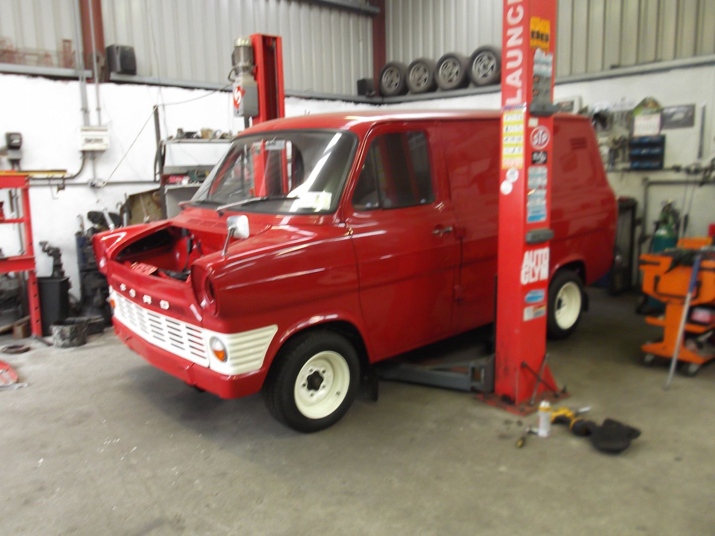

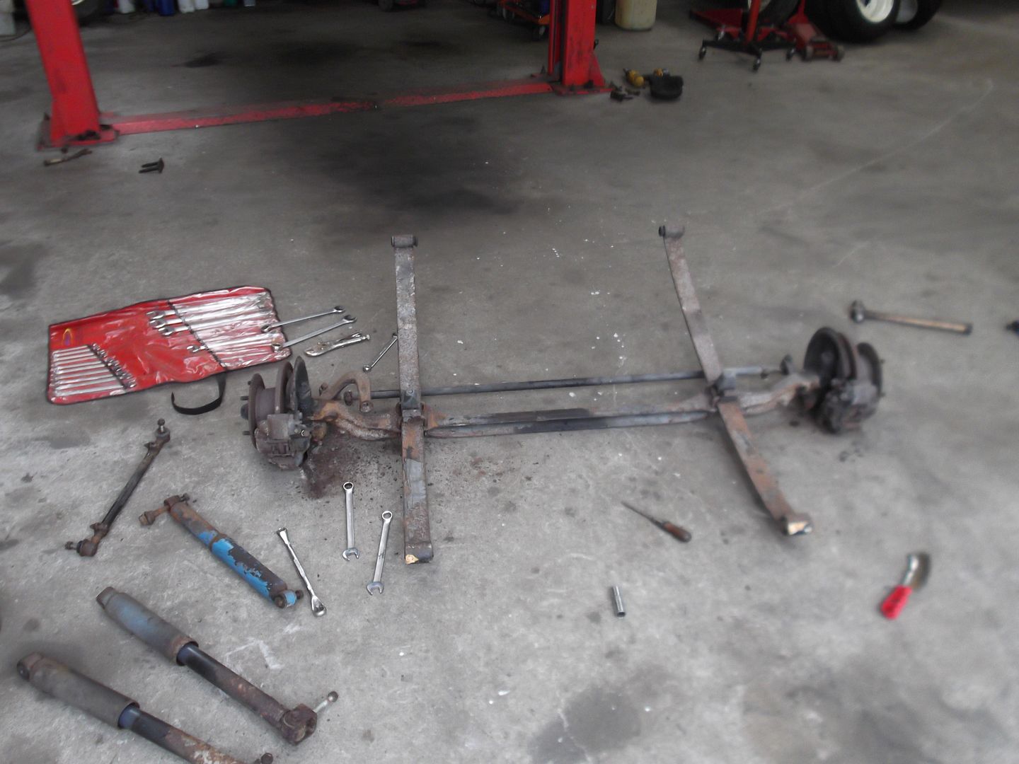

also got the mk2 front disc brake axle setup fitted.

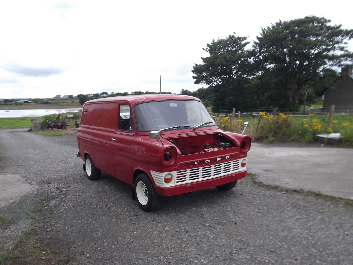

before fully reassembling the front end i loosely attached the front panel and took her for the maiden run. all seemed good and the modded flywheel/clutch setup seems to be a success.
so, happy that she was going well, all the bits were bolted back on.
van more or less finished, couple of door rubbbers still to be fitted and maybe fit a higher diff ratio and thats about it.

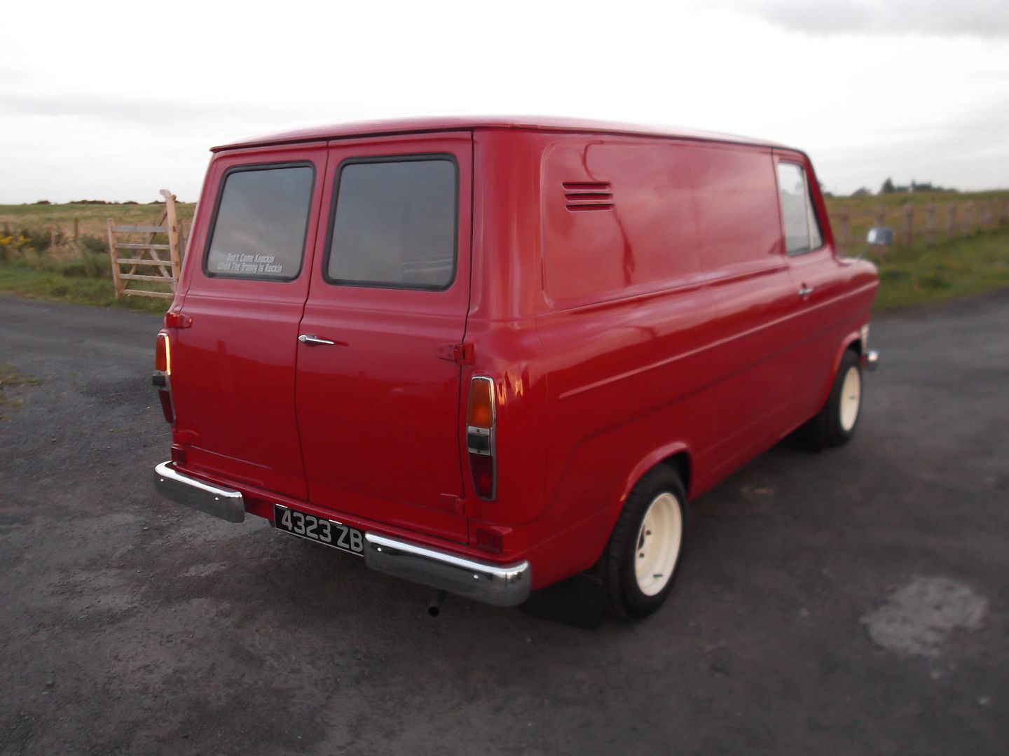

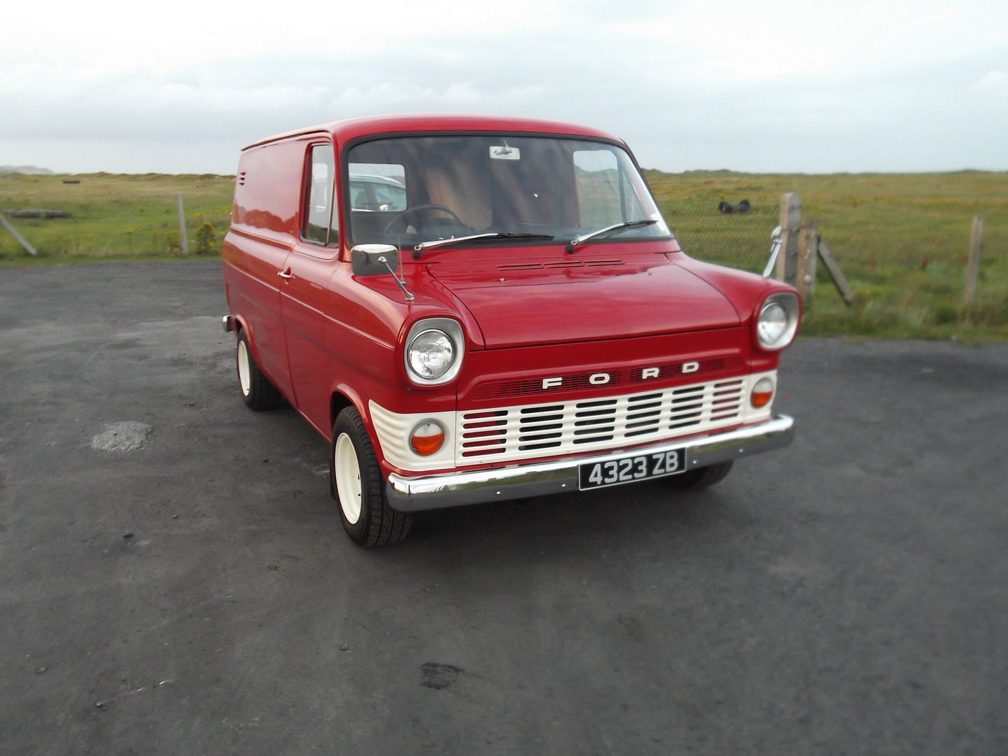

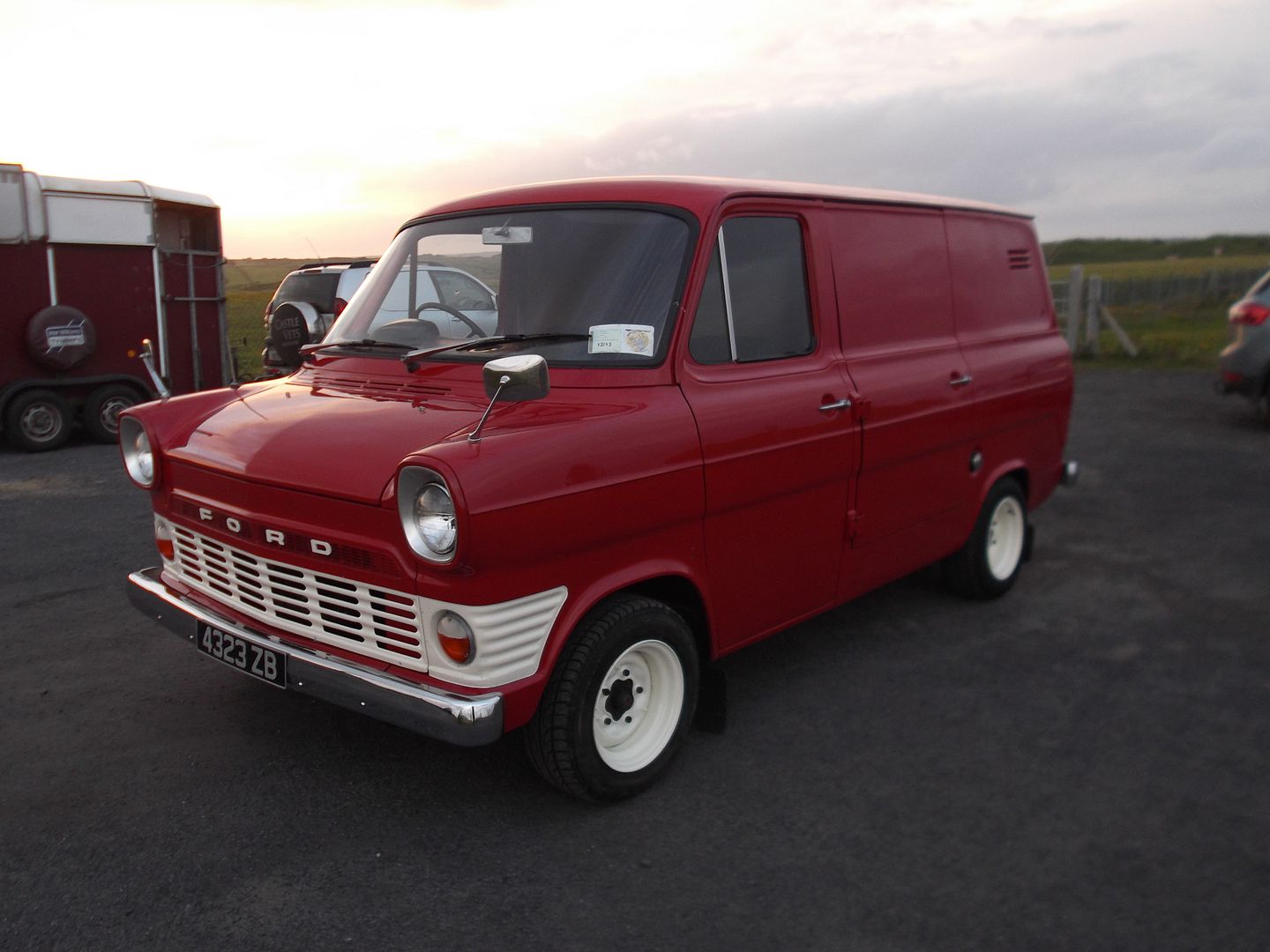

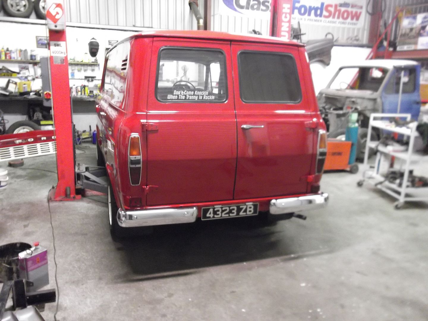

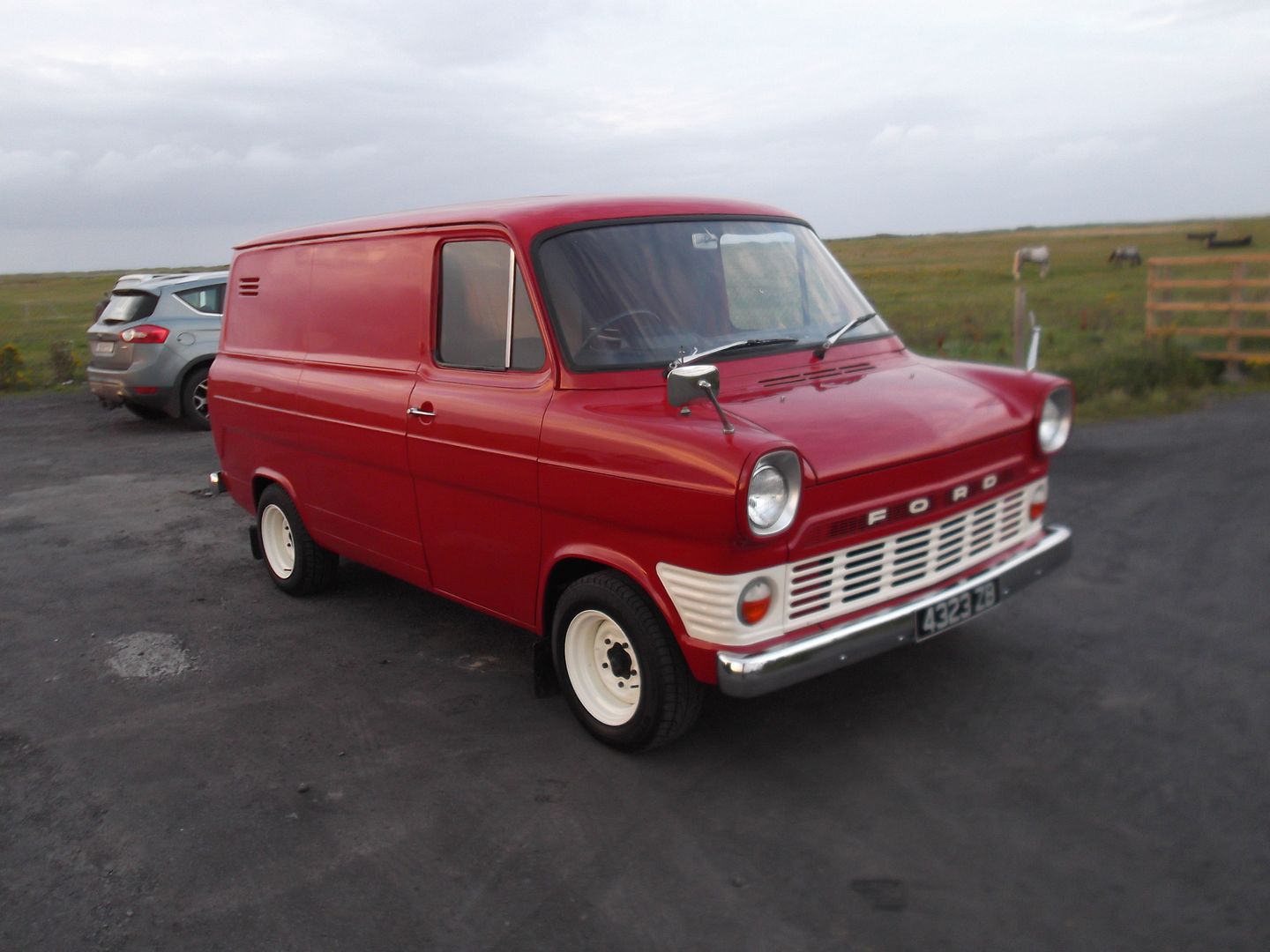

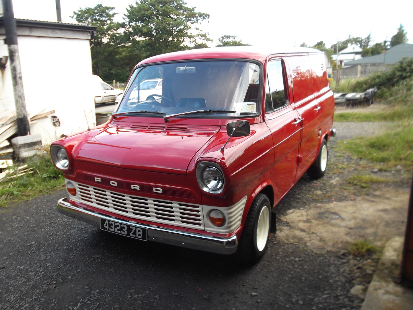

the van is now fully finished, back with its owner and on the road. hes very happy with it and the way it drives. only other thing i did was fit a 4.1 diff from a swb mk2 2.0 pinto van replacing the original 4.4 ratio. this left the van sweeter on the road and it cruises easily at 60 or 70. id say it would even handle a 3.9 ok if we could find one! i must say it was one of the more enjoyable projects as the van was so nice to start with.

hes been driving it all summer luke and loves it to bits!! he actually parked up his mk1 escort and took the tranny to most of the runs and shows instead!! he doesent do any towing with it but i know from driving it its a flyer on the road up through the gears but ive a feeling that a long hill with a load on would throw up issues due to the lack of torque compared to a bigger capacity stove.
