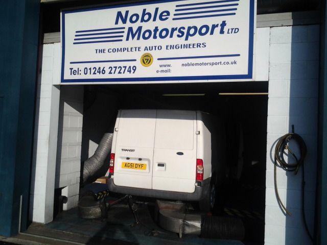

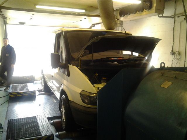

Postby Luke » Sat Oct 06, 2012 8:00 pm
Luke wrote:next step stu is going to take the van and have it set up on a rolling road 8)
well 3 months later............... took it this morning to noble motorsport
unfortunately £80 later they couldn't sort it :( but they confirmed fuel pressure is OK but its rich on tick over and lean on boost :?
they suspect a wiring fault we've put the origanal ecu back on and it does run better - i'd like to try another stage 3??? ecu on it as i'm not convinced the one we have is any good :|

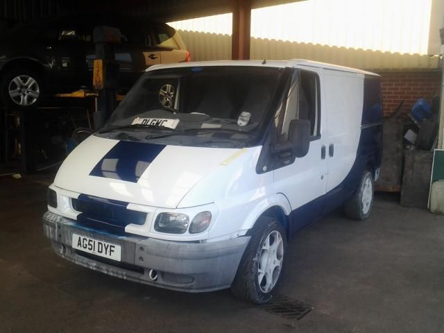

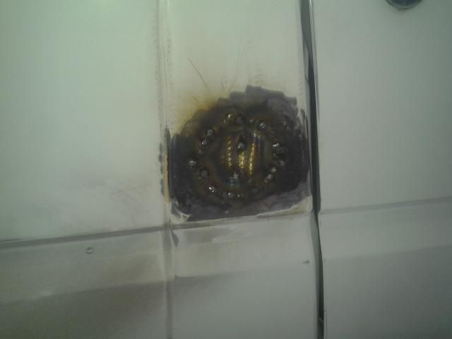

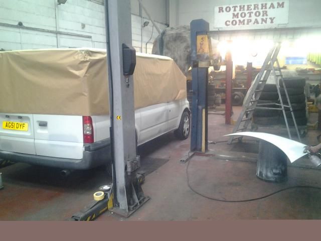

Postby Luke » Sun Jun 30, 2013 9:21 pm
bit more work on this ready for north weald 2013 8)
my contribution welding up the old lpg cap :D
while martin paints it :D
i'll not say what the final colour scheme stu's got planned he's changed his mind enough times :lol: but if he can get it done in time it'll be fully stickered up for north weald 8) 8)

Postby Luke » Sat Jul 06, 2013 11:51 pm
taking shape 8)
can you guess what it is yet :lol:
Posts: 44558
Re: MK6 SWB Cosworth YB Conversion!
Postby AlanN » Sun Jul 07, 2013 10:49 am
With a week to go, will it be in full livery Luke? Looks good as is, so far 8)
