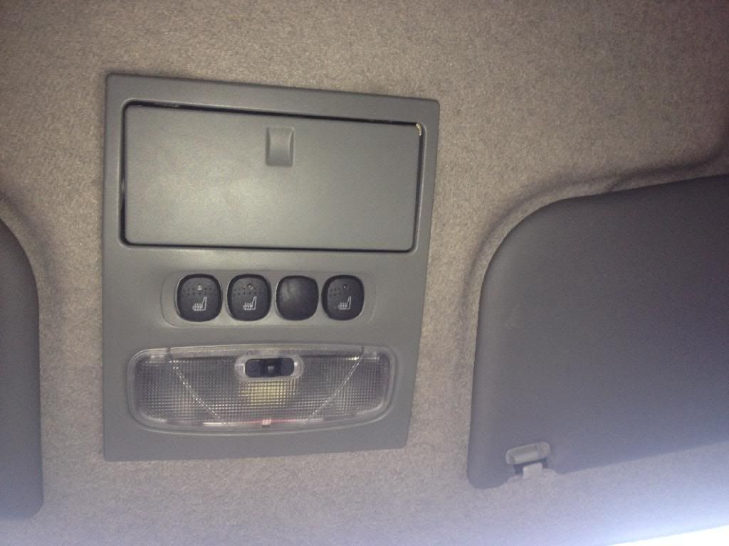

Hi mate i see on page 1 in the begining you changed the inyeriour light and fitted a new one with sunglasses holder. Where and what car /van did that come from. Thanks.

Postby Brains_transit » Wed Jun 03, 2015 12:24 pm
ossie cossie wrote:Hi mate i see on page 1 in the begining you changed the inyeriour light and fitted a new one with sunglasses holder. Where and what car /van did that come from. Thanks.
It's from a high spec mondeo

Postby Snaresy » Sat Jul 25, 2015 8:09 pm
Hi,i know it was a while ago,but how did you get over the mk6 having a single plug and the Mondeo having 2?Also did you straighten out the sunglasses holder as the one i got hold of is curved?

Postby Punto443 » Sat Jul 25, 2015 11:26 pm
I heated up the the shades holder and straightened it a bit,
The steering wheel and air bag are from a mk7 transit and only have one plug, not a mondeo :D

Postby dirtydog » Sun Jul 26, 2015 8:33 am
Did you use a hair drier or heat gun to heat it up?

Postby Punto443 » Sun Jul 26, 2015 10:54 am
Heat gun on that one, it was pretty easy to straighten :D

Postby Snaresy » Sun Jul 26, 2015 7:26 pm
Punto443 wrote:I heated up the the shades holder and straightened it a bit,
Thanks,that clears it up.

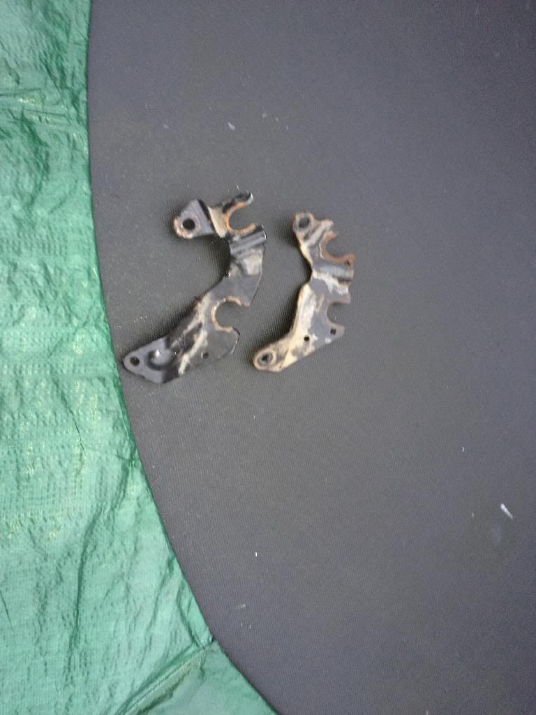

Punto443 wrote:I changed the gear cable support bracket today for the mk7 one. It made a big difference to the gear change, much smoother due to the cables being lined up at the turret properly :D
Larger ones the mk7
Going to see if I can get the ply back down on the floor tonight too and maybe some lights back in the rear too!
Are these just a straight swap mate? no need to make a adapter to make it fit?
robintett
Posts: 39
Joined: Sat Aug 23, 2014 7:15 pm
Re: My mk6 swb
Postby Punto443 » Fri Nov 20, 2015 8:43 pm
Yeah, straight swap :D

Postby PistonMeetValves » Fri Dec 04, 2015 10:37 am
Hi Punto, just got meself a new grey cable, would sticking a mk7 holder as above just fit straight on my standard mk6 and help my slight notchyness? Gona have to hunt at Inverkeithing i think haha 8)
~ PMV
'02 MK6 T280 100 in fetching white/rust ♡
Warren: 'These brakes, they're completely inadequate'
Burt Munro: 'I'm planning on going, not stopping.'
PistonMeetValves
Posts: 193
Joined: Mon Apr 07, 2014 10:58 am
Location: Rattling around Scotland!
Re: My mk6 swb
Postby Punto443 » Fri Dec 04, 2015 3:13 pm
No, it only because the mk7 selectors a bit longer it suits the angle better
2018 Renault trafic
my old mk7
my old mk6
my xr3i
Punto443
Posts: 15873
Re: My mk6 swb
Postby PistonMeetValves » Wed Dec 09, 2015 10:36 am
Thanks Punto. So won't fit or improve my mk6?
