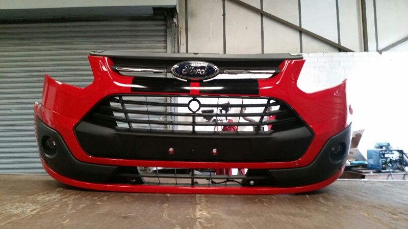

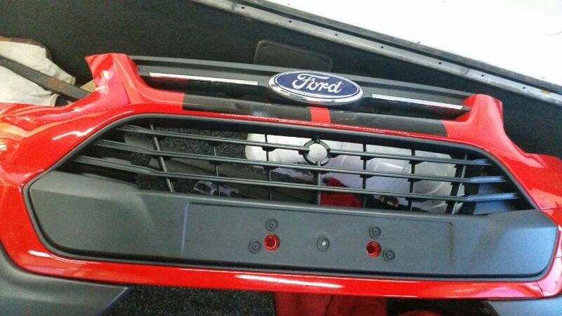

Top part of my bumper arrived 8) 2013 sport but it really didn't Lol the same shade of red, but a bit of a polish and i joined the top to the bottom and fitted the new grille, I'm happy to report it's a match 8)

Has that bumper got black stripes on.

It's a sport top section but i was scared to remove the black bits Lol.

If you want to remove the black bit and assuming its just vinyl also the writing on the roof use a hair drier to soften the adhesive and gently peel it off then use wd40 to remove any adhesive that is left before t-cut or polish,
Or get some black vinyl stripes on ya bonnet.
