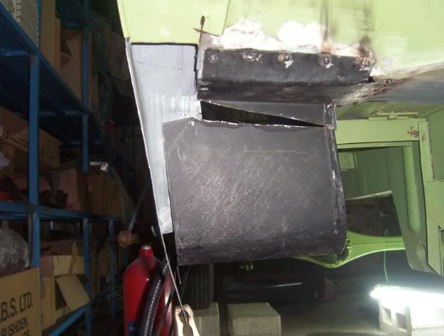

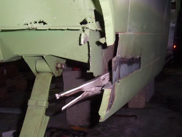

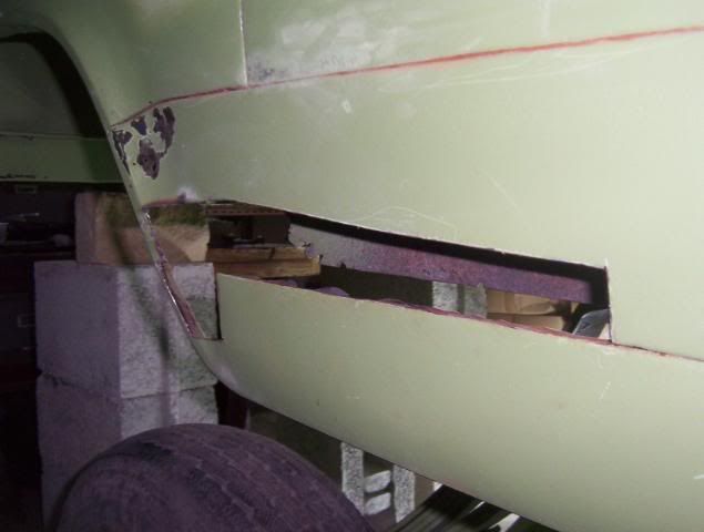

Hey guys i solved the problem, well actually Karmnu my friend solved it for me. Today i went to his place and told him my problem and he laughed as he had met this problem before. The secret is to cut an line with the chasser and then weld the upper part to the angled lip as below.................

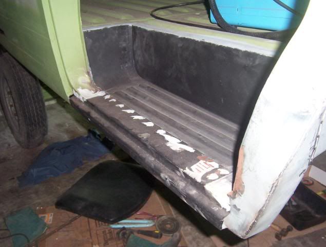

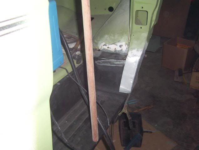

Then when i got the upper part of the step welded, whilst I was at Karmnu's yard I took some measurments of the inside height which i measured all Karmnu's vans and these were all in the region of 56" inches. Back at my van i got 56"1/4 on the other side, so [ this is a secret ] i got my wife's broom and cut excactly 56"1/4 out of the handle and placed it between the step and the top, this is brilliant as it's atight fit. Then scribed the missing metal and welded it flush in place,as you can see below. This took me 2hrs but I'm satisfied for today.

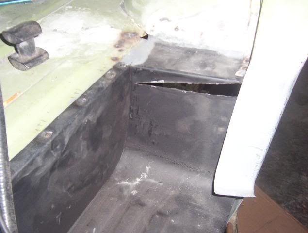

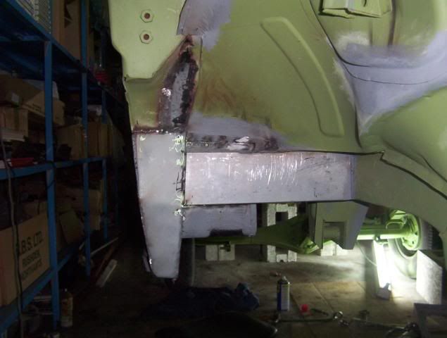

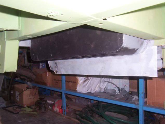

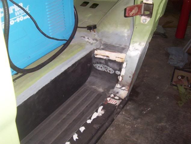

Since a month has passed, i have done very little progress as the parts i have tackled took long to do and very time consuming. So I have finished the step and bottom of step outrigger.
The Step.
From beneath.
The front outrigger.
Now i started tackling the side, and cut the rust at the back of the horizontal side were it meets the wheel arch.

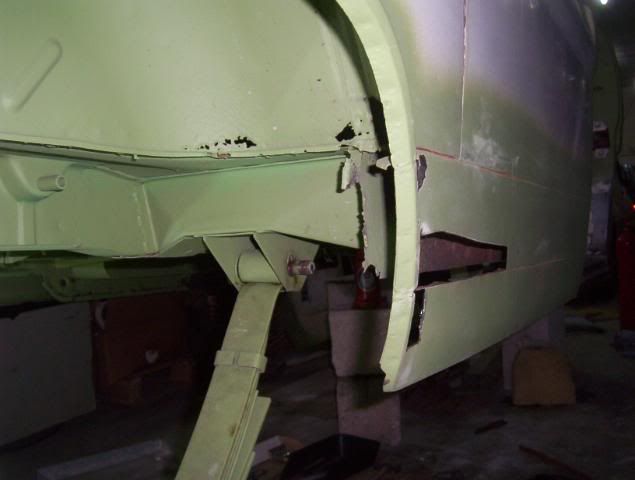

Postby malta transit » Tue Jun 10, 2008 9:26 pm

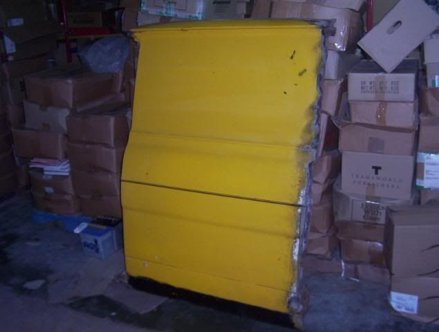

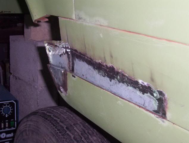

As i forgot to say, I had tried working on the outer panel to make the part of the rear wheel arch. I welded 2 new metal pieces together and when i patterened the 3rd bit, the outer lip, i could not get the original shape. Here below are 2 pictures of the progress;
As you have seen from the above picture , in the middle were i welded the middle part went in a bit, so that made my day, and left everything and gone away.
The next day, I went to Karmnu to get a spare bolt, to replace the one i'v sawn. He gave me 2 with different treads and gave me a valuable part [ blue ] cut from a front mud guard, to weld in the missing gap at the back, as the front lip arch is the same as the back { Geniuis } As i was there he offered me 2 new genuine lenses at the original price of Lm2.50 each [ 5.50euros each ] whom i could not refuse.
