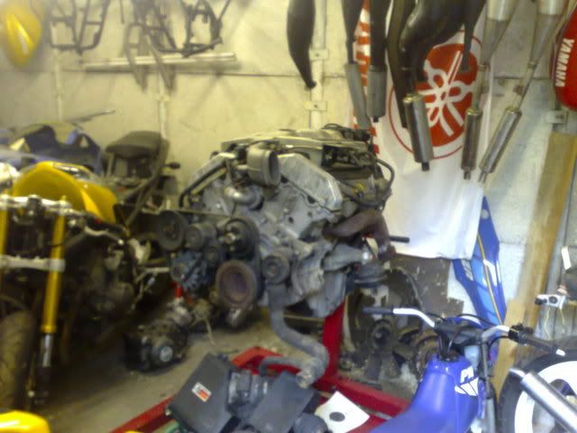

ok sensible post time..got the engine on its stand and in the workshop...
going to fit a new waterpump, fan belt, the engine mounts and check things like plugs etc while its on the stand.
got a few questions.....
does the oil filter fit in the transit engine bay on the extension arm its on in the granada?
do i need to change the sandwich plate to run an air/oil cooler?
does the viscous fan fit in the transit engine bay or am i better running kenlowes?
does the granada steering pump work with the transit rack? the granny one has a a 2-pin plug on the bottom, any idea what its for?
where do people take the servo pipe to on the engine?
ta...

Postby Luke » Sat Jul 31, 2010 9:55 am
cant help with all of these as my engine bay is slightly different but...........
mine i just did away with oil cooler - i was gonna fit a seperate air/oil one but i havent yet
dunno havent done it yet
i dont think it does - wouldnt in mine anyway to i used sierra twincam fans just cos i'd got some lying about
yes it does - the plug on the btm is for variable assitance - low speed parking or something it's not connected on mine - i think its just a relif valve - not all grannys had it
back of the plenum - i converted one of the old egr pipes

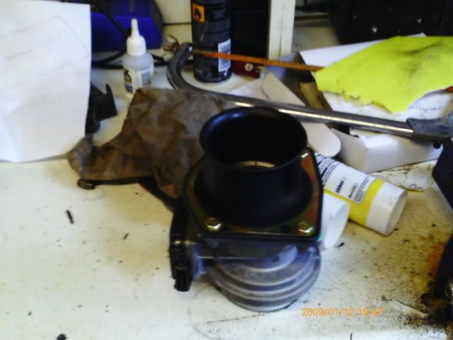

making slow progress....as usual :roll: got the engine mounts off the lump and the manifolds...coo....arent the valves small :?:
have cut the trumpet out of the granny airbox so i can fit a cone filter from caprisport. going to get a fitting tigged into the egr pipe from there too, that will be the vaccuum for the servo.

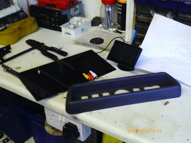

what's all this then, carbon fibre? LCD monitor? shhh....its a little something to rival AlanN's plastrickery.
more on this soon :wink:

Postby Luke » Mon Sep 20, 2010 1:06 pm
Gavin wrote: going to get a fitting tigged into the egr pipe from there too, that will be the vaccuum for the servo.
can't you use the existing pipe ? just cut it off an join it :?: you arnt keeping the egr are you :?
Posts: 44557
Re: cosworth swb mk4 project....
Postby Gavin » Mon Sep 20, 2010 4:26 pm
i guess.... but it looks neater, little bit of bling for 15 quid :lol:
