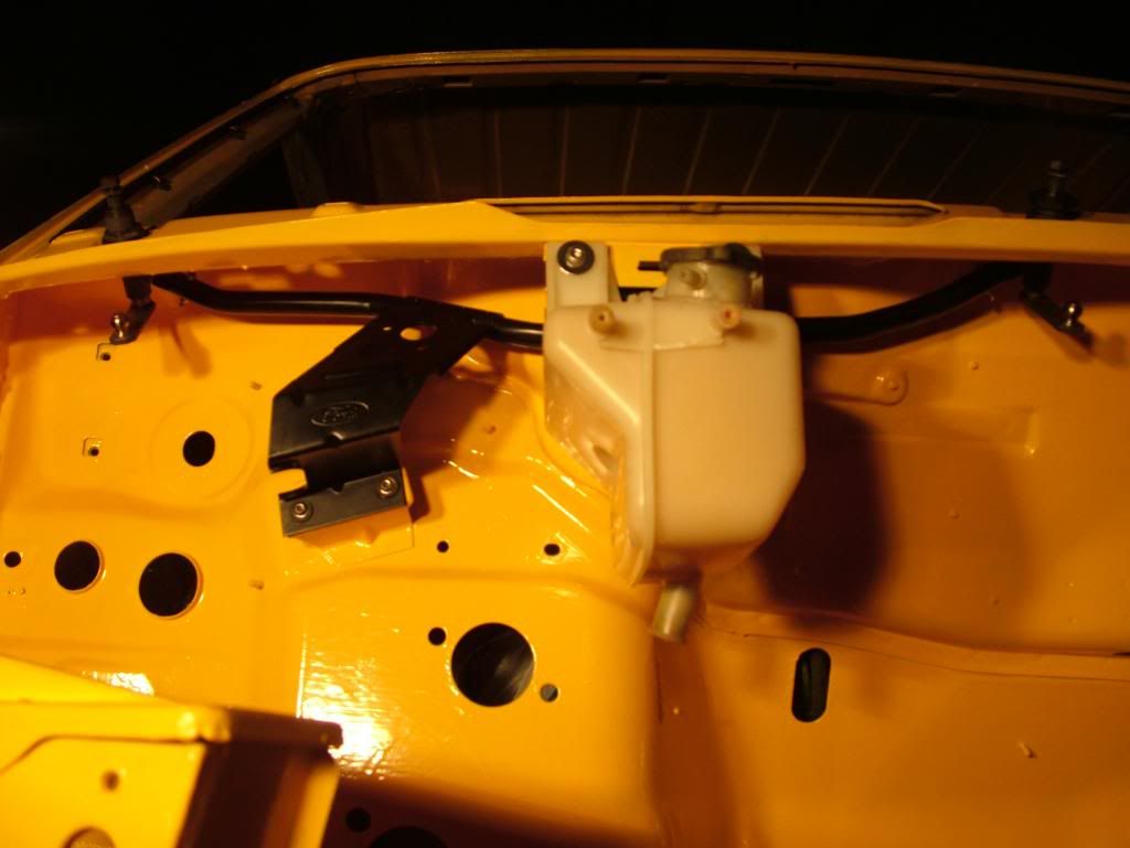

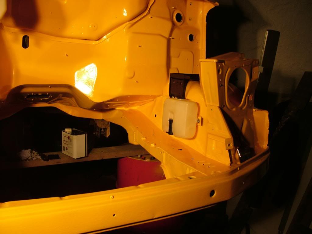

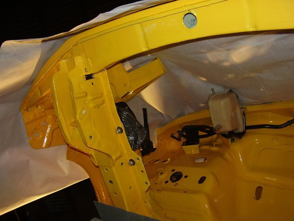

Postby Mr RVM » Wed Mar 26, 2014 12:21 am

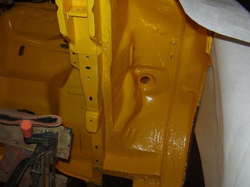

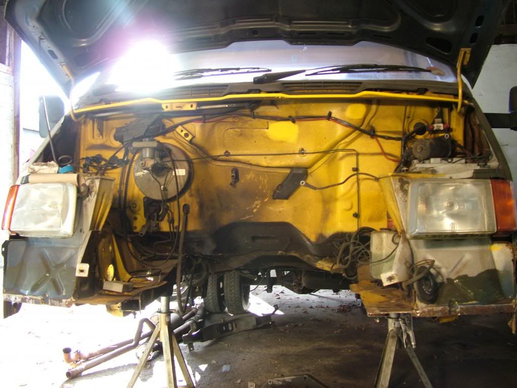

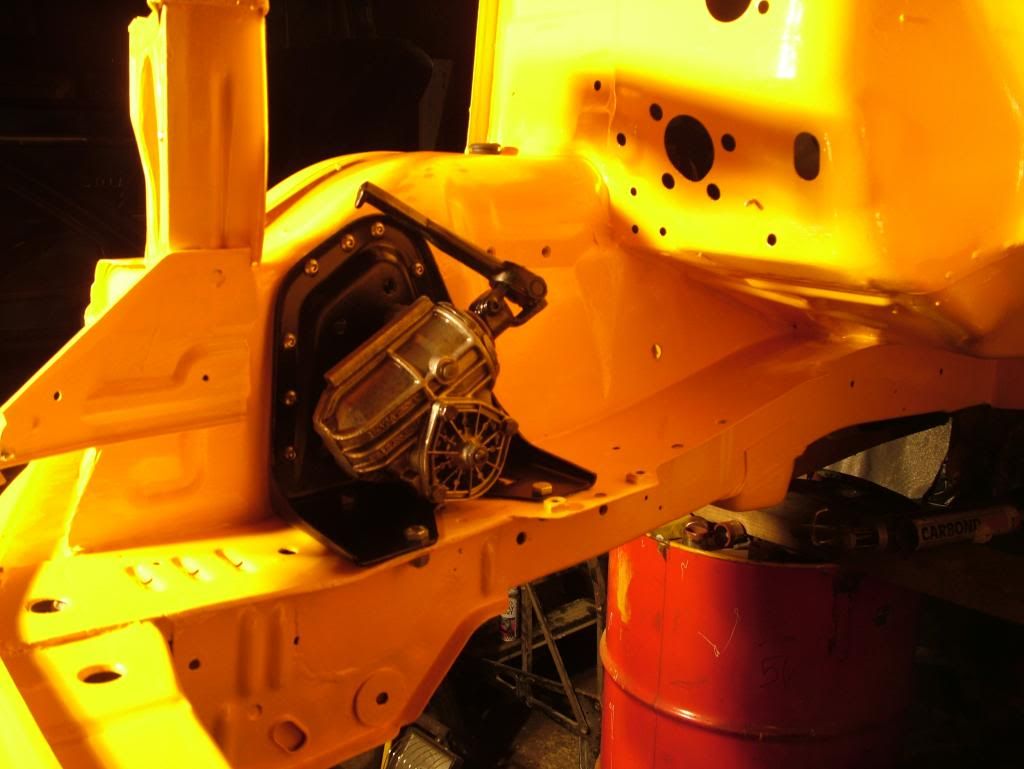

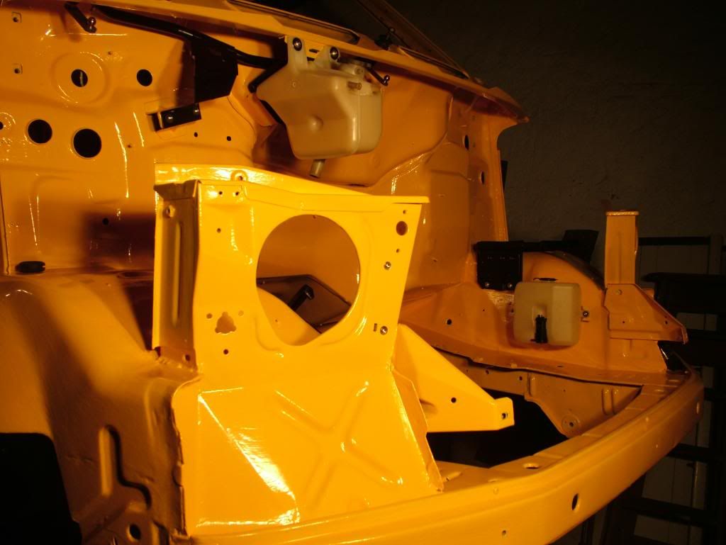

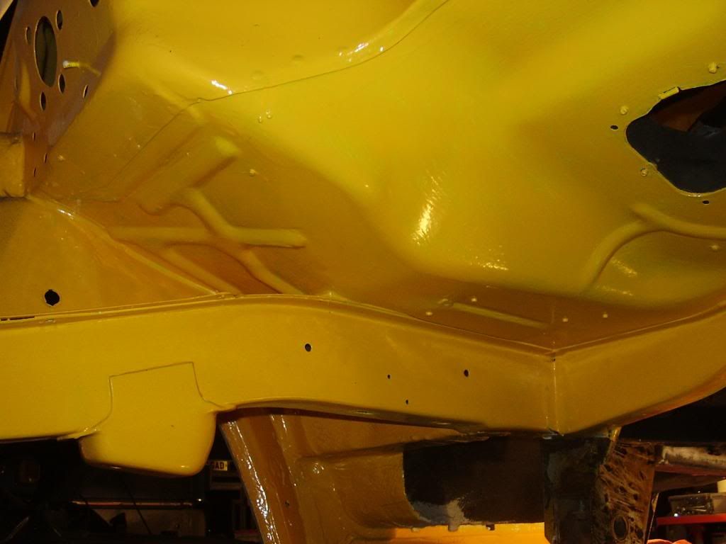

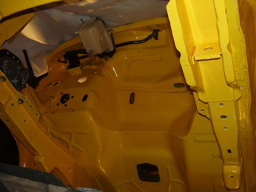

Got a couple of pics that mate took the other day before I got there so here they are...
Looks a bit better with crossmember cover on :D
Lookin a lot better than it did :lol:

Postby 6wheeler » Wed Mar 26, 2014 8:31 am
Is that brush painted, looks great :D
6wheeler
Posts: 67
Joined: Fri Mar 14, 2014 9:06 pm
Re: Gaz's Mk3 truck
Postby Mr RVM » Wed Mar 26, 2014 9:59 pm
Yeah painted by my own fair hand with an inch and a half soft pure bristle economy (screwfix no nonsense) brush :)
To be fair the photo's make it look better than it is but I'm quite happy with it :)

Postby 6wheeler » Wed Mar 26, 2014 10:07 pm
Fair Do's, looks tidy, do you know what type of paint it is cos its got a good shine to it.
6wheeler
Posts: 67
Re: Gaz's Mk3 truck
Postby Mr RVM » Wed Mar 26, 2014 10:28 pm
6wheeler wrote:Fair Do's, looks tidy, do you know what type of paint it is cos its got a good shine to it.
Yeah its "Hammerite" smooth Yellow and it shines like no other paint ive ever put on with a brush :) 3 coats (flatted with "scouring pad" after each coat before it gets too hard ie within 48 hrs)

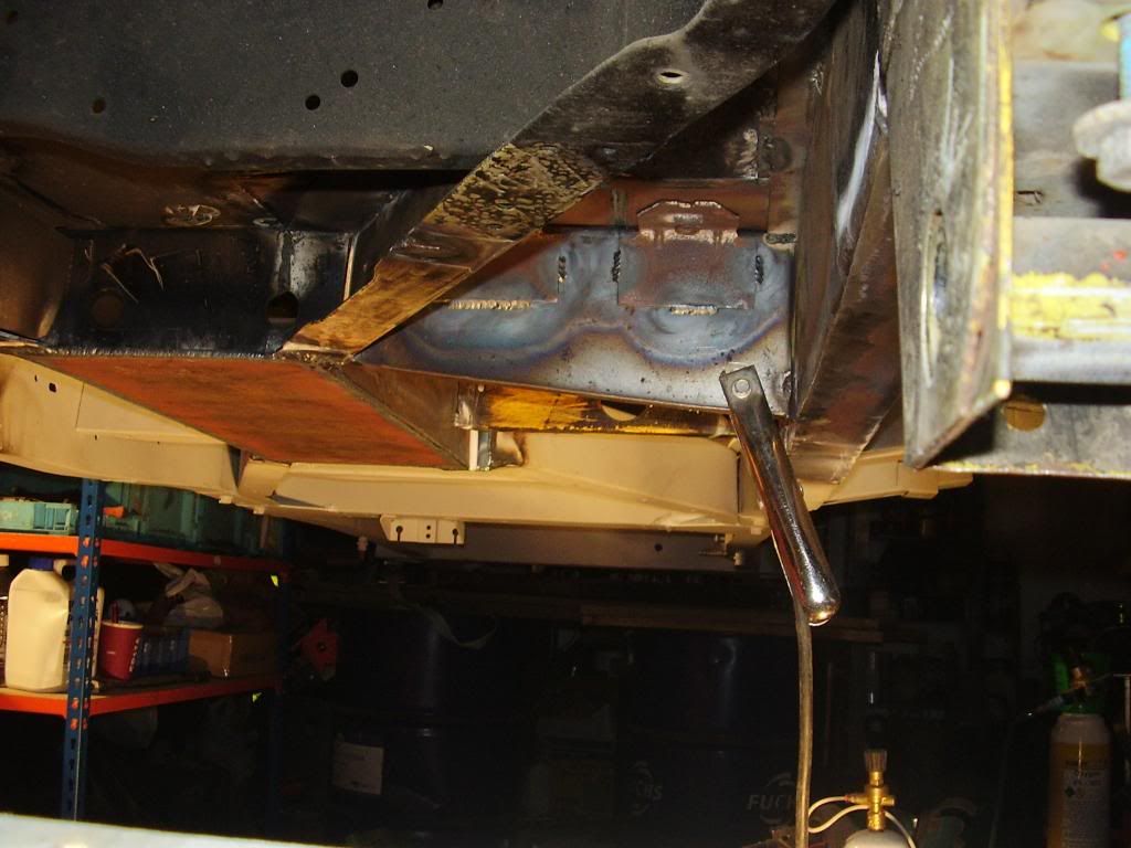

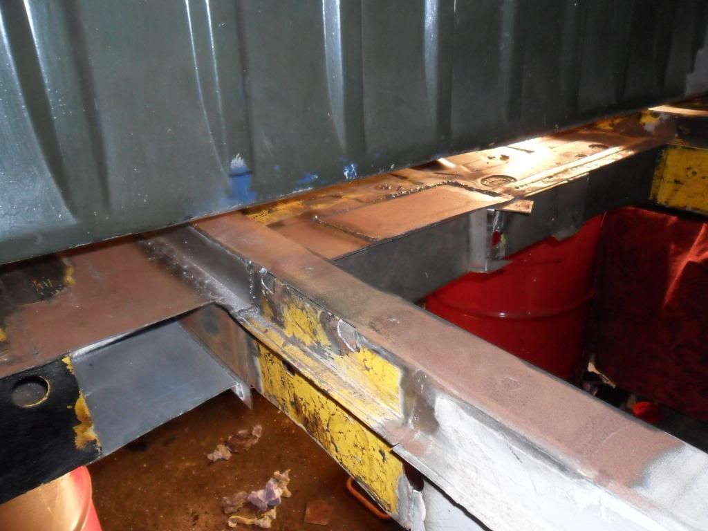

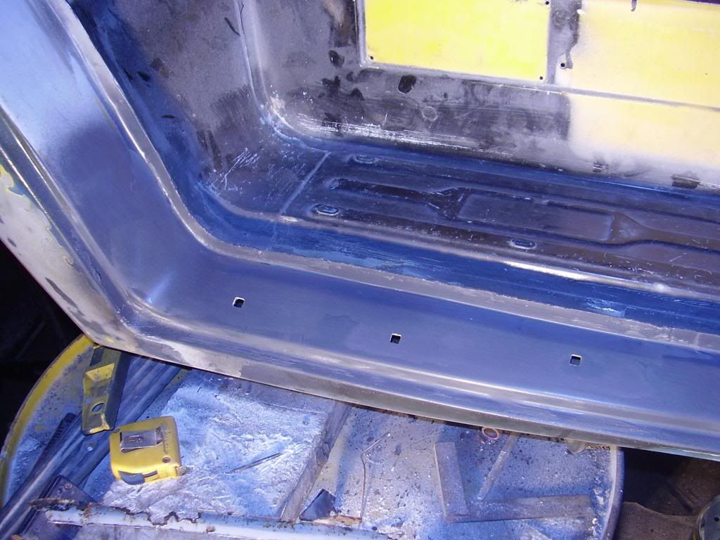

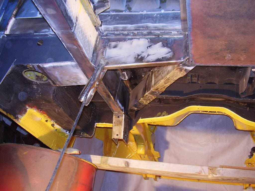

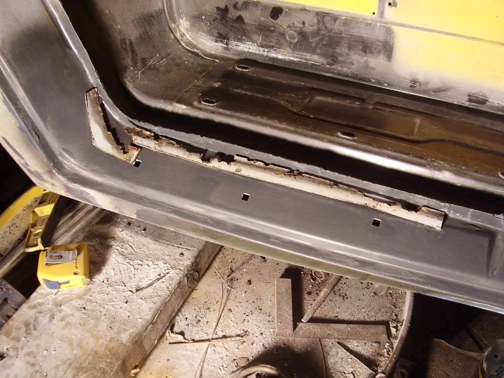

Postby Mr RVM » Thu Apr 24, 2014 1:27 pm

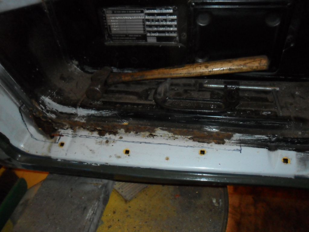

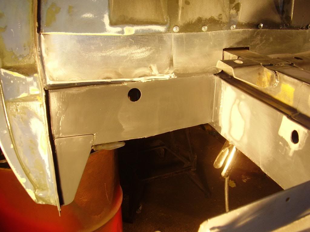

Here's some of the pics ive taken in the last week or so :!:
doesn't it look pretty :?: :lol: :lol: :lol:
Doorstep on passenger side needed work but not enough to warrant a complete replacement
so before....
cut this bit out and welded in new piece and finished with the old "cold solder" :lol:
and after....
The chassis/outrigger in the area around the rear of cab/fuel tank is all done now....
More later when I get in from work....
