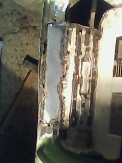

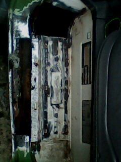

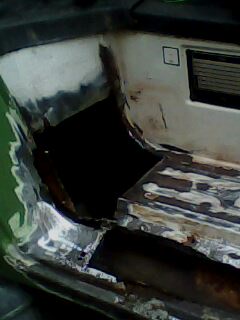

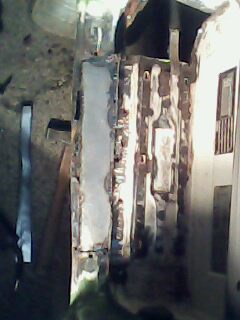

Finally I have decided, that I can not do more damage to my bus than it was already done, so I've started welding :twisted: The step is going to be the unvisible part and yet can be done in stages, and then cut out if I'd mess it up, so here we go.
I cut out the rusty and filler full areas
Image Image
I cleared it all up inside the box aaaand started patching up. It takes me loooong time because I hesitate a lot if I'm unsure about something, but finally I got the first patch to catch on to the right place... :roll:
Image Image
It's not welded up completely yet, as I stupidly bought 8mm welding wire by mistake and I don't have 8mm tips, so it was quite a struggle with that wire, but it did catch on nicely and I'm currently very proud :lol: :lol: :lol:

Postby Muttley » Sat Jul 18, 2009 9:29 pm
Looks OK to me :)

Postby Nadjenka » Sat Jul 18, 2009 9:37 pm
Muttley wrote:Looks OK to me :)
It needs to be one continuos weld 30cm from the belt mounting right? That's not done yet, I just welded points in to get it stuck, then made some holes by sccident :roll: then trying to repair them I made some blobs of weld :lol: then I grinded them off and finally got it right! :roll: Tomorrow I'll get the proper tips and weld the rest in... I know it doesn't look like much, you would have that done in no time, but for me it's a miracle that it stays in place and stands hammering and at the same time I can close the doors! :lol: :lol:

Postby MinorMatt » Sat Jul 18, 2009 9:59 pm
with 0.8mm wire you should take the little drive wheel on the welder off and turn it around... there are 2 grooves one for 0.6 the other for 0.8
Looks like you are doing a good job but I cant see the welds....
Postby Nadjenka » Sat Jul 18, 2009 10:15 pm
MinorMatt wrote:with 0.8mm wire you should take the little drive wheel on the welder off and turn it around... there are 2 grooves one for 0.6 the other for 0.8
Thanks, I figured that one out :lol: but the tip is struggeling now and then if there is the slightest bent in the wire it will not go thru the tip, so I'll have to get the 8mm ones tomorrow. You can't see weld lines, because there are none. :wink: It's just point welded in place as I wrote up there, the flow of the cable is not smooth enough to do continuous weld line. I'll finish that tomorrow. :roll:

Postby MinorMatt » Sat Jul 18, 2009 10:18 pm
remember you will need different settings with the thicker wire
