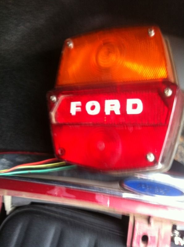

Postby carnut1100 » Mon Jul 16, 2012 4:14 pm
Here's one of the tail lights I picked up for it.
Sweet find I thought!
Just managed to fit them in my carry on luggage too....
