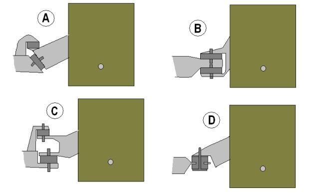

Postby Luke » Sat Jan 08, 2011 12:23 pm
been thinking about the mounts as thats the job i need to do next - the vibratecnics stuff is expensive and if i knew it would be ok i'd buy some but i just dont know :?
i like the idea of the wcxm idea because it cant split and allow the engine to move but buy the nature of its design there isnt much contact spread on the rubber so i guess thats why you'll always get a harsh ride :(
i'm thinking of using matts idea of 2 mounts - the standard one to take the weight of the engine and cushion is and a 2nd one to hold it down and conteract the engine as the power is applied - basically to stop the origanal mount splitting in 2
these are a few sketches to show ith idea - A or C are my favorite :D
Posts: 44561

Postby AndyJ2506 » Sat Jan 08, 2011 12:30 pm
would you not be better using the stanard mounts and then fitting an engine damper to take the extra stress away from the mounts

Postby Luke » Sat Jan 08, 2011 12:40 pm
AndyJ2506 wrote:would you not be better using the stanard mounts and then fitting an engine damper to take the extra stress away from the mounts
yeah same idea really - i'll look into engine dampers :idea: that might be easier and neater :D

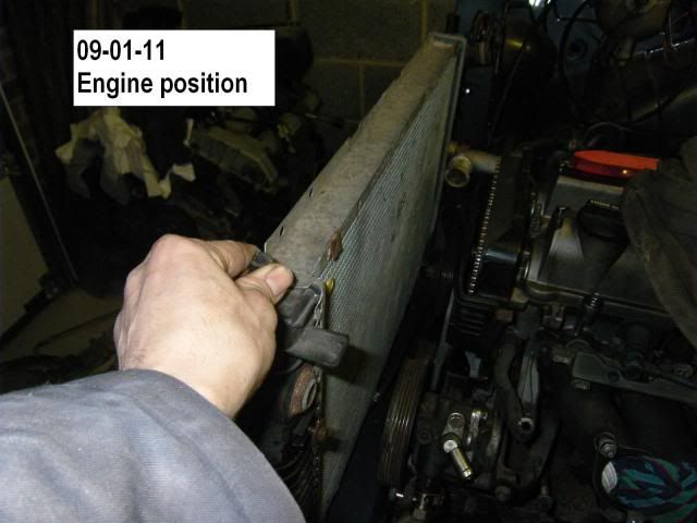

Postby Luke » Sun Jan 09, 2011 10:36 pm
had a good day on this today :D dropped the crossmember so i could get the engine sat in the right position - basically anything in its way now i can mod later :D
this is a pic showing the space i have left at the front - amazing really i can get the old cossy rad in there and space for some slim fans 8)
basically the reason ive got so much space is i have lowered the engine down and back - its still 1/2" off the bulkhead

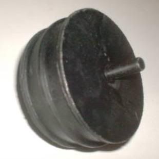

i can now make the mounts - ive decided to use jag V12 mounts a nice basic design and good enough to take the weight :D if i decide to i will adapt them to deisgn C shown earlier, if i did that i'd need to make the top half bolt on anyway :D
they are similar mounts k-conversions use in there bmw conversion kit which costs £1050 :shock:
this is a close up of the mount its 90mm dia and 35mm deep :D
