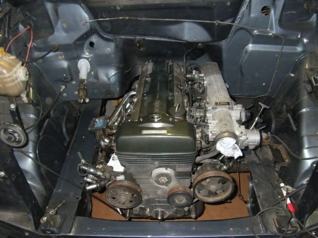

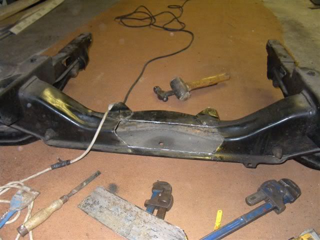

ive got the prop off and its all measured up - i'm gonna have it modded this week then i can set the gearbox mount angle :D the engine fouls the subframe so i took that off and cut out the area that was in the way :D
you can see what ive cut away here - it will need boxing back in to give it the strength back but 1st i'll fit it back to the van to make 100% sure ive cut enough off :D luckly the rack can still retain the origanal position :D
now ive got the engine sat right i thought i'd try the inlet side and amazingly it fits perfect- quite handy as it saves me having to make something up :D unfortunatly the inlet is in the wrong place but i can move that by making a spacer angling it to the right a bit - should do the trick 8)

that looks TINY :lol:

yeah it does :lol: but it's still huge honest :lol: it's almost like the engine bay was designed just for it - i can even get the manifolds on/off without moving the engine at all :shock:

Looks low in there Luke, does it still fit OK with all the ancillaries back on

what angle is the gearbox at with engine that low :?:

AlanN wrote:Looks low in there Luke, does it still fit OK with all the ancillaries back on
just needs the front crossmember trimming back a bit :D
winterheating wrote:what angle is the gearbox at with engine that low :?:
about 5deg - its not much lower than the cossy mabe about 1-2" at the crank but the top is about 6" lower ive tried to set it as it was in the aristo but theres only a set space for it to go in - ive read up and i think i'm ok on the prop angles - the 1st section needs to be in line with the centre bearing as there is no u/j - ive spent ages messing with it and in the end thought sod it just get the prop made up and see what it looks like - i can always alter it after (angles) but the prop length will be the same whatever :D

i cant believe how well that lump is sitting in the van, and running the ifs subframe with no sump mods!!! 8) just class! you must be loving this conversion.
