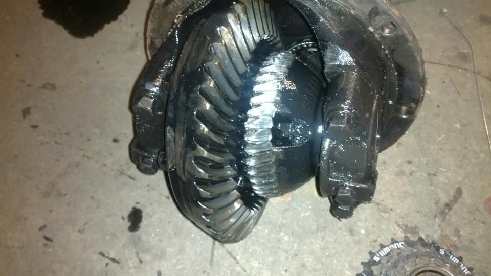

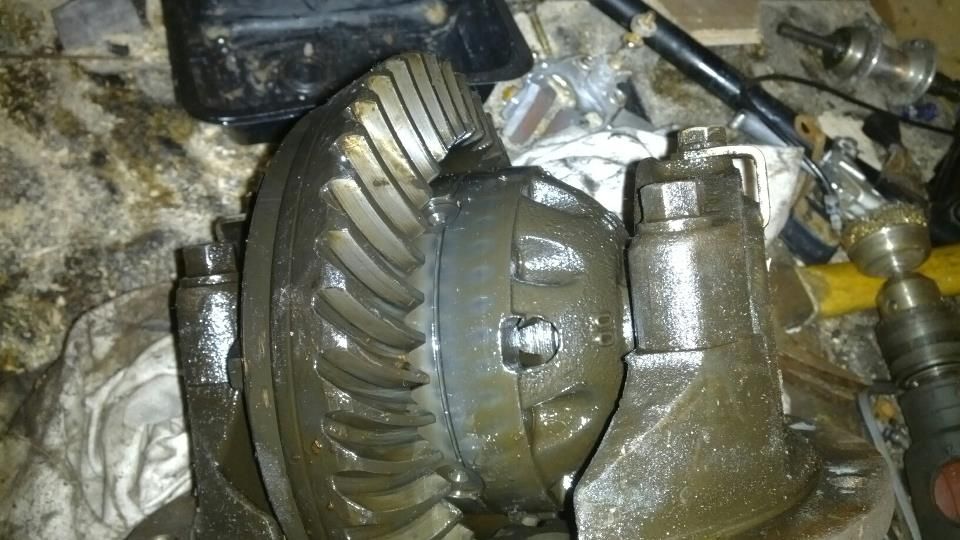

Re: A girls guide to the mk4
Postby linsey_young » Fri Nov 16, 2012 9:21 pm
Not supposed to look like this...
Should look like this instead...
Postby MinorMatt » Fri Nov 16, 2012 10:29 pm
pinion bearing knackered then...

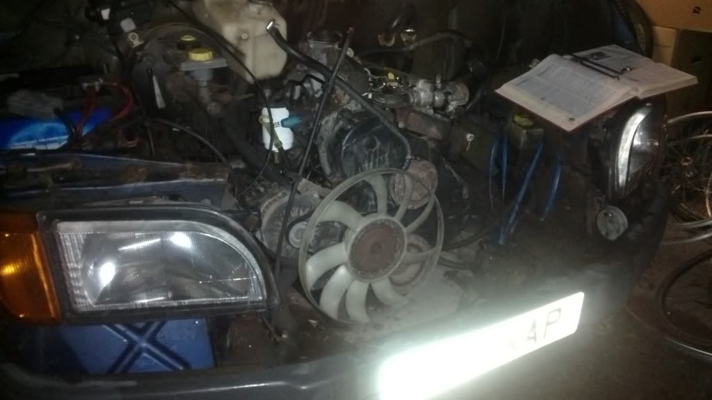

Postby linsey_young » Thu Dec 20, 2012 9:33 pm
Todays progress after I got it into the shed...
Hopefully get the lumps swapped on Saturday if all goes to plan...

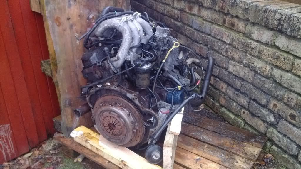

Postby linsey_young » Sat Dec 22, 2012 4:03 pm
New lump successfully moved from the scrappie :)
76ps of raw diesel power! :twisted:
Removed from an LDV convoy - finally going into the right van!
Postby MinorMatt » Sat Dec 22, 2012 7:44 pm
That bosch pump looks different to normal... Looks like there is a pipe coming out of the top.
You will also want to keep your old fuel filter and housing... unless you want to splice diesel lines
Lucas Laser 2000 & IDS
95 N Hallmark (white)
96 P 150 TD 100PS LWB Hi-Top
96 P Autosleeper Duetto
2 x 2006 Mk7s
Posts: 24306
Postby ake » Sat Dec 22, 2012 8:55 pm
MinorMatt wrote:That bosch pump looks different to normal... Looks like there is a pipe coming out of the top.
I think you are seeing the link for the throttle butterfly ;)
