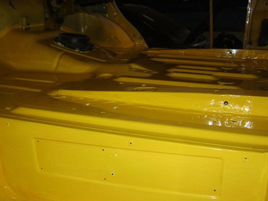

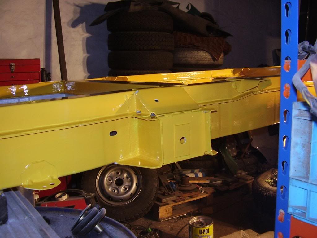

Postby Mr RVM » Thu May 08, 2014 9:43 pm

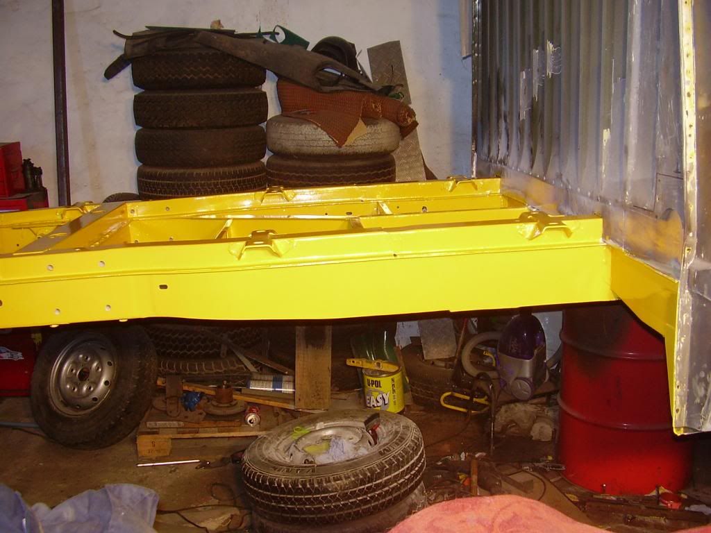

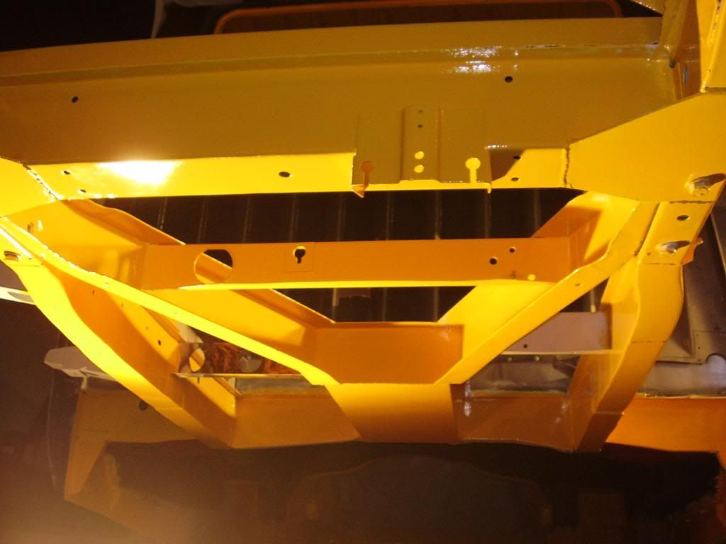

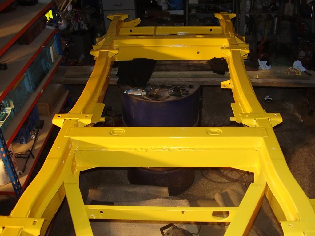

More pictures of YELLOW paint
didn't get much more than that done today having learned that a good friend of mine had passed away this morning so wasn't really in the mood to work :(

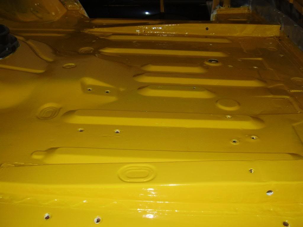

Postby Mr RVM » Sat May 10, 2014 1:16 pm

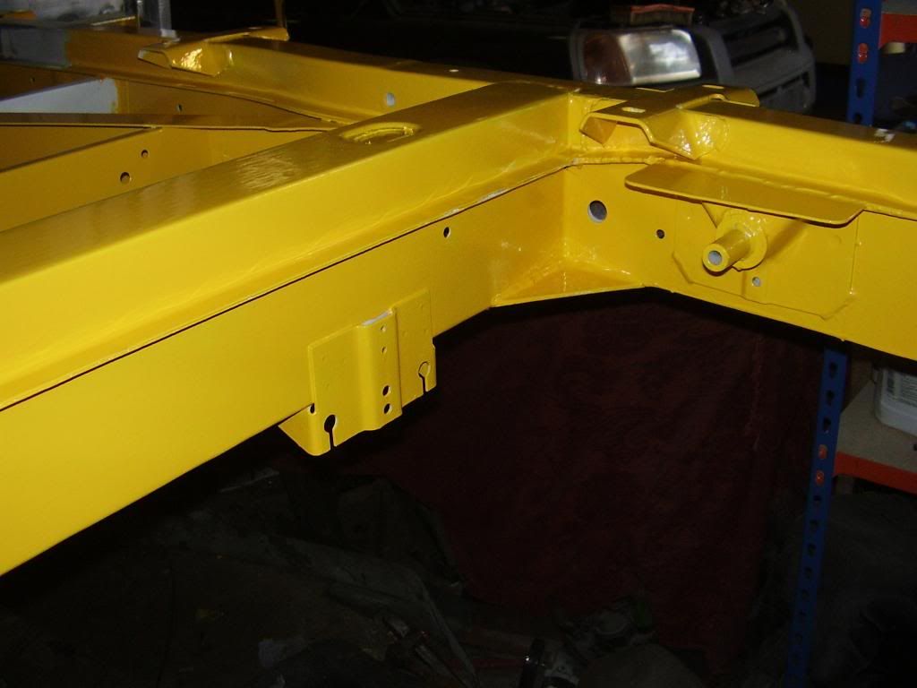

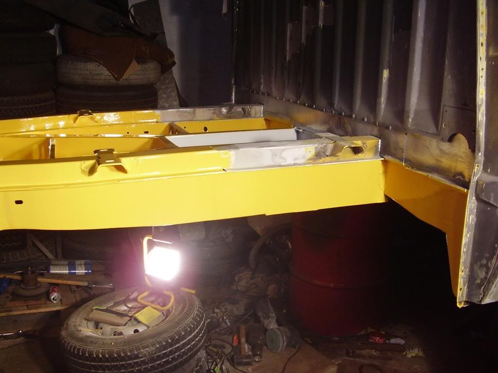

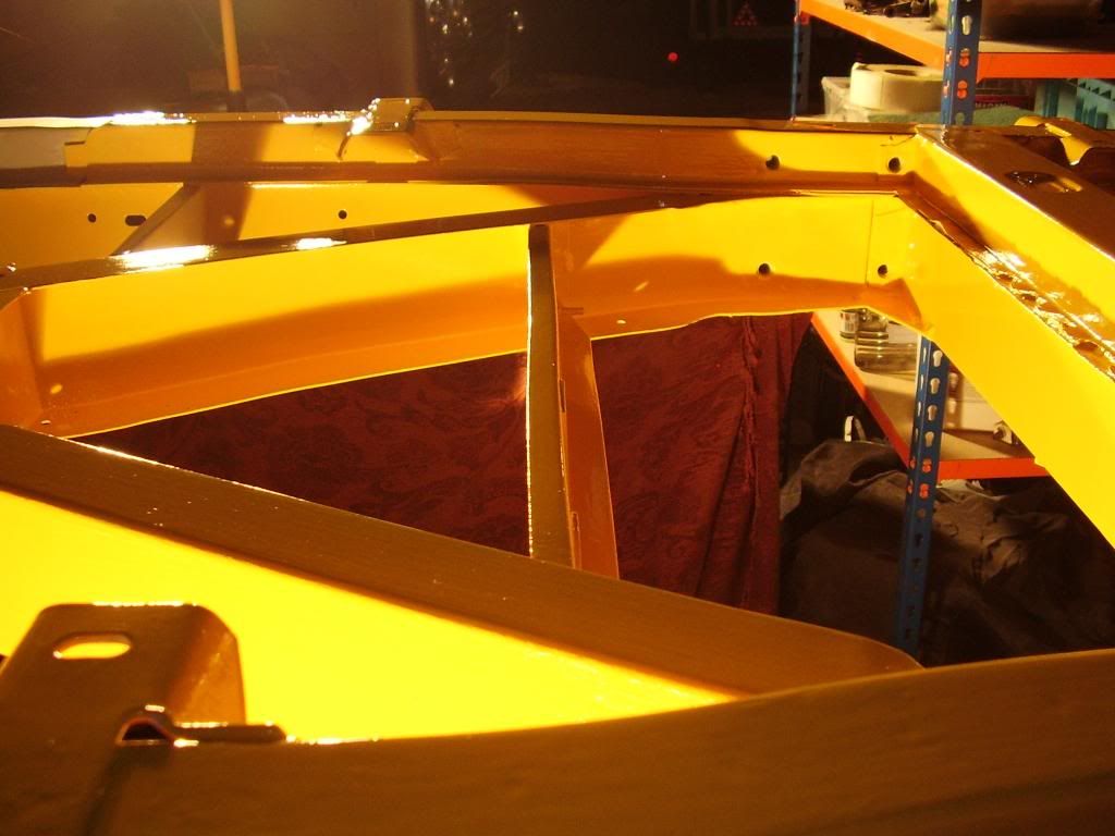

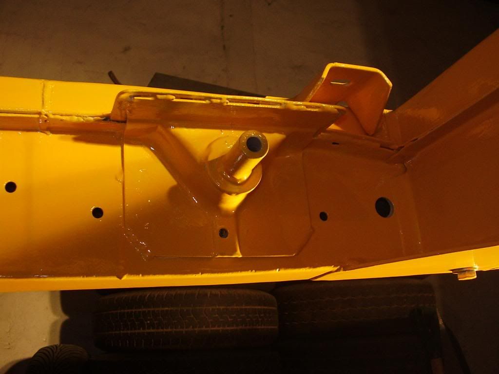

Got the floor painted yellow last night and started to "knock the top off" the doorsteps and chassis in preparation for its second (hopefully final) coat of paint :)
working late tonight but 2 days off (tomorrow and Monday) so more painting :roll: didn't realise how long the painting stage would go on for (to make a nice job)
after much searching ive found out that no windscreen manufacture Mk3 windscreens any more they only do them with the ceramic banding the same pattern as the Mk5 so gutted as I am I'm going to have to fit a Mk5 screen :( God (and the Massive) forgive me but I have no choice (unless I pay hundreds to have a one off made) :lol:

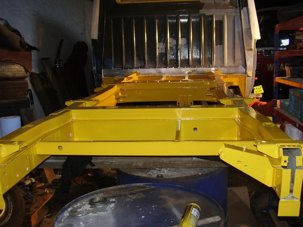

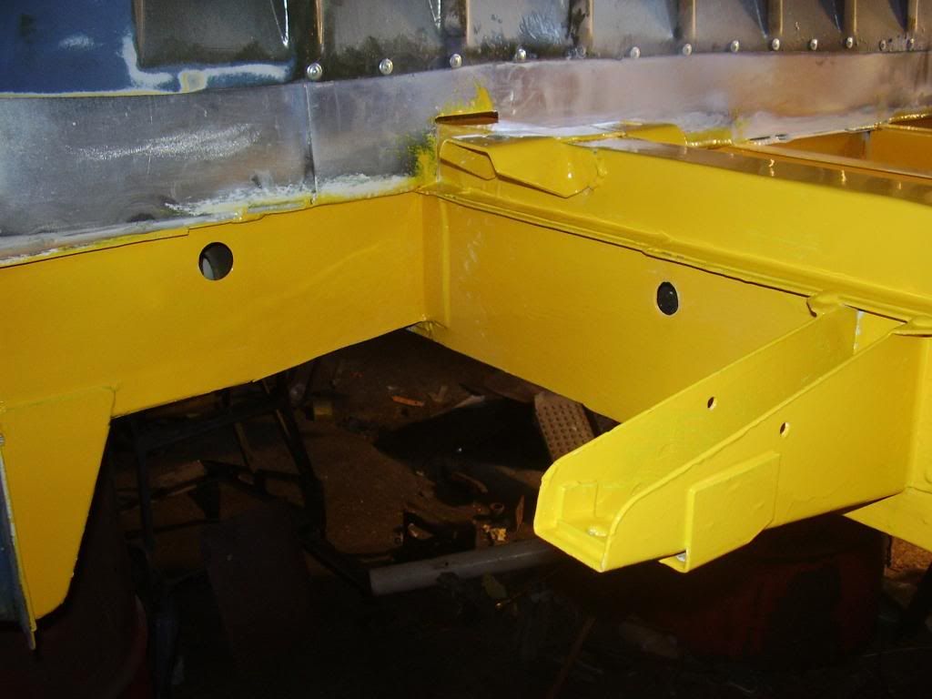

Postby Mr RVM » Mon May 12, 2014 3:44 am

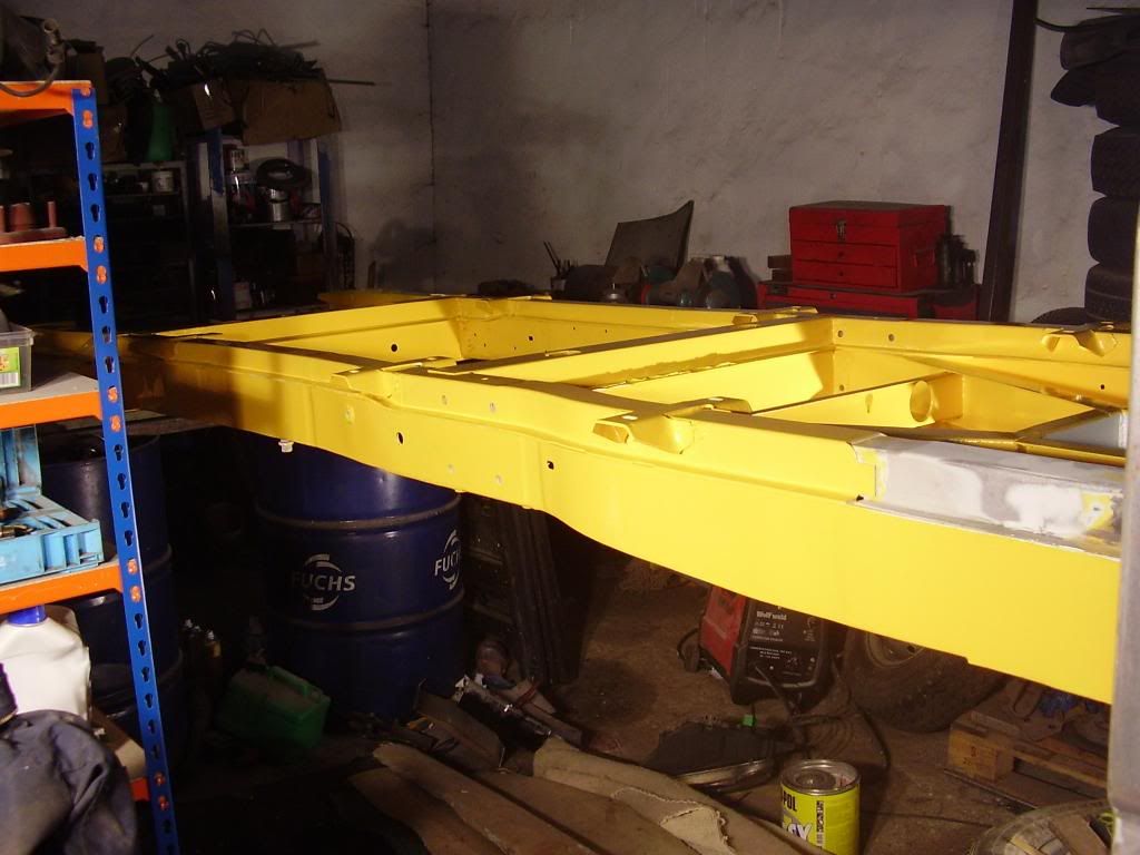

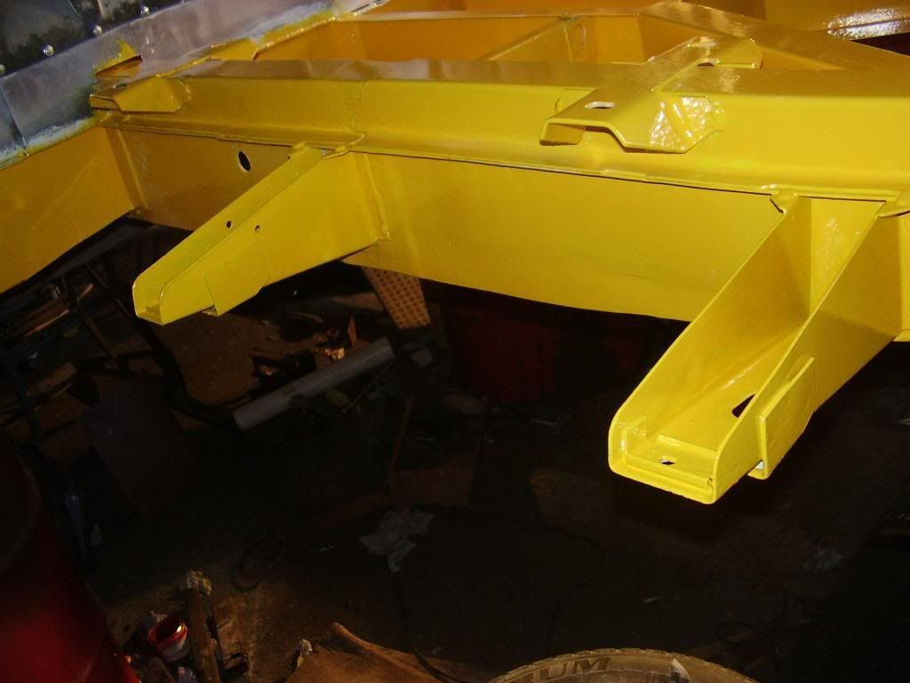

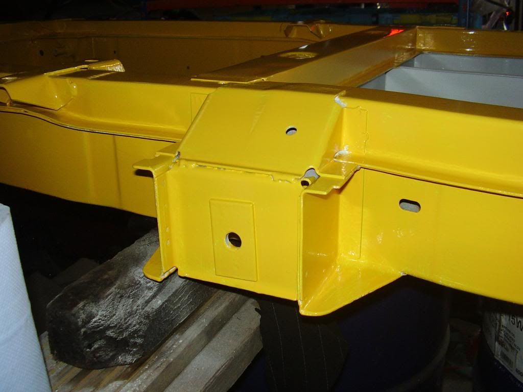

Shiny Floor.....
and more of the chassis....

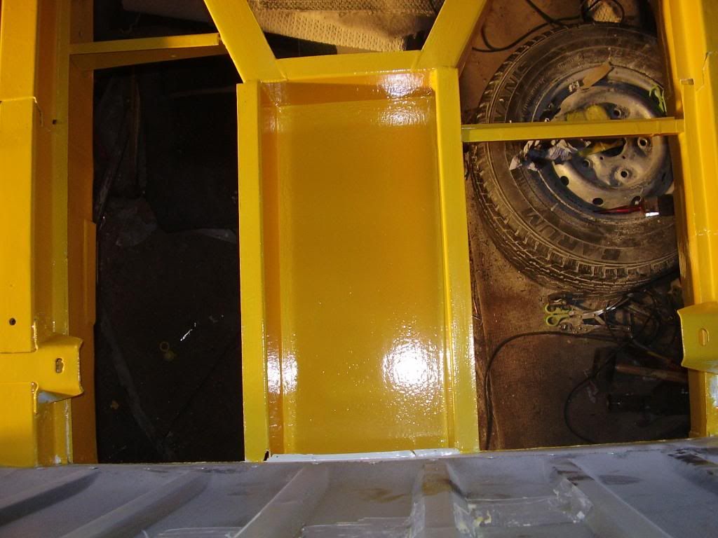

Postby Mr RVM » Tue May 13, 2014 9:38 pm

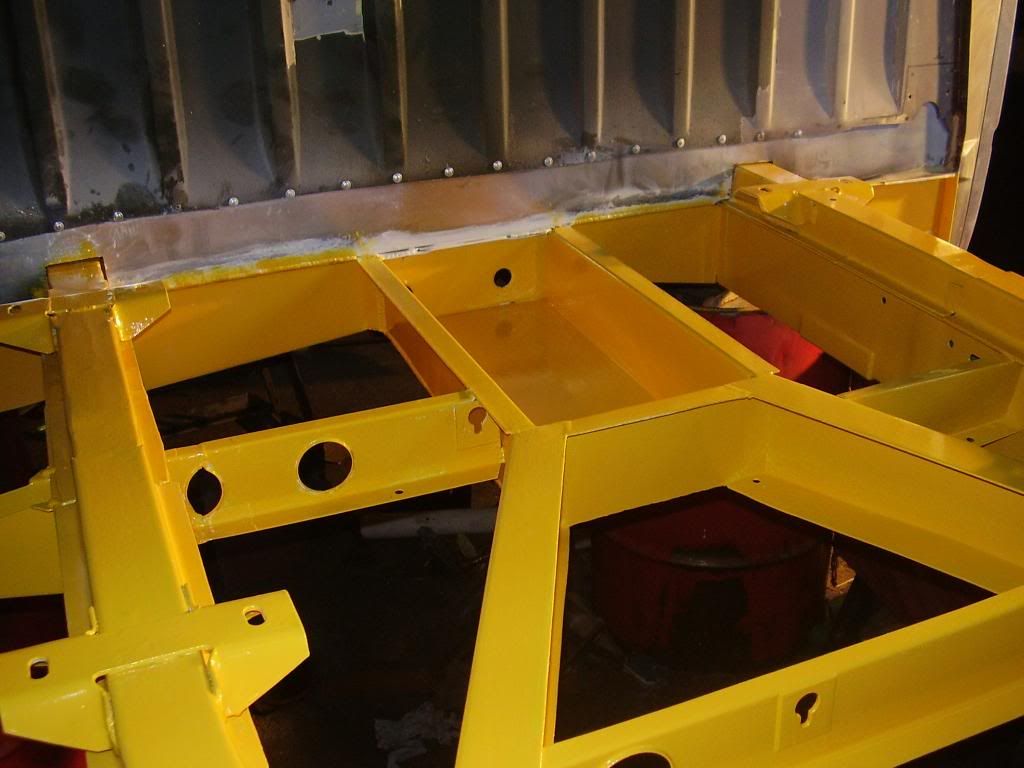

Pictures of the finished chassis......
Cant wait to start putting the axle/suspension back in but working for next 8 days so wont be done quick :(
