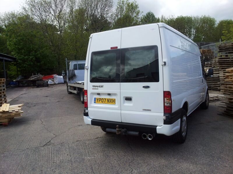

Postby Tango330 » Wed Aug 05, 2015 1:39 pm
loot wrote:Back doors fitted which have heated glass and wipers.
So is it good having the rear windows then Mate :?: There's a couple of tailgates on the bay, even same colour as mine, but they want about £200 for them and it's collect, so about a 600 mile round trip :shock:
Plus they're Mk6, so I'd have to swap the wiring over to t'other side :?
Plus not sure if I'd have wiring present for rear heat and wash/wipe. Is the switch different :?:
T330 RWD now sold
Ford Ranger Wildtrack now sold
MI 5 sacked me from my job as an interrogator this morning, didn't like to ask why :?
Tango330
Posts: 3084
Joined: Mon Oct 14, 2013 7:53 am
Location: Deepest Dorset
Re: loots mk7
Postby loot » Wed Aug 05, 2015 6:01 pm
For my needs it is awesome and well worth all the messing about i had to do with software mod.
Initially i fitted a timer relay for the wipers so they came on and stopped, reason was that there are 2 and the pause allowed them to both come home then start off in sequence, before that i powered them and they both went up and down and eventually went out of sunc and looked buckshee :lol:
So i modified the software to include trans linked wash wipe which is way cool. Eg, if you don't have rear wipers on but do have the front ones on and then you go into reverse, the rear ones come on to clear the back windows 8)
Anyhoo.
The rear windows wiring was all there for me iirc but finished at the big white connectors at the front A pillar right and left :-)
The heated part just connects to the heated mirror relay and also to A pillar ground. So if you have heated mirrors then an easy addition.
The wiper needs a focus wiper switch, double washer pump motor and wiring to relay r24.
If you need any help with that let me know :-) check if you have terminals for r24 or if you have it already.
I use my van like a car so i cut the bulkhead in half so the lower half is there which is cool because it keeps crap from sliding about while leaving me with storage space under my seats, i can see/climb into the back too, i look out of the back windows and fitted a rear view mirror so the window wipers and heated glass is a must in that situation.
So it depends on what you want really.
Obviously tint the back windows because it stops ppl looking in and also makes you feel a bit more private. 8)
07 350 170ps
Ids map here
loot
Posts: 33969
Re: loots mk7
Postby Tango330 » Wed Aug 05, 2015 6:40 pm
Thanks Mate, that all sounds pretty good, I just need to check up on what wiring I have.
Not sure if I have heated mirrors, they're electric, so I thought that they would be and just worked off the heated windscreen, but that sounds wrong now :?
Your wiper setup sounds really cool 8) , so would defo like to do that if I do go with it :)
Not sure about the switch though, the Focus rear wash/wipe ones on the Bay look exactly like mine :?
only thing that puts me off is I'm still not sure if it's worth the 2 hundred smackers plus a massive round trip to collect :?
Nah sack that mate just hang on til you see 1, sods law you'll do all that to get 1 and the next day there's 1 down the road for 100 quid Lol.
The cmax switch is the same but it pulls back for rear wipers 8)
You'll have the switch wiring already and the heated mirrors wiring so just need a switch for it.
Only the relay to A pillar connector needs wiring up and software.
Bear in mind that you have to confirm what wiring you actually have since this is Ford we are talking about :lol:
