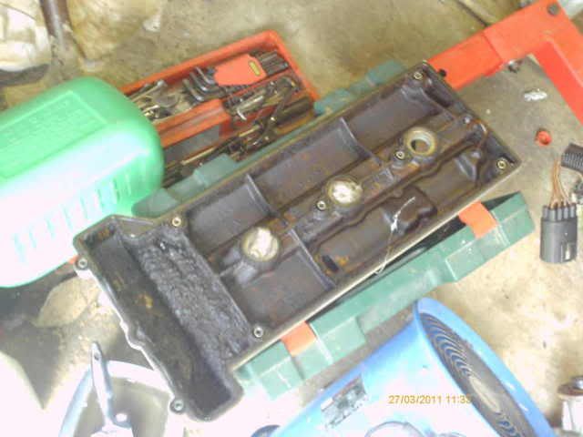

BROWNYS V6 wrote:yeah im not a lover of engine paint either :? i used blue on my pinto engine,an have had to go over some of it twice,lookin good though.
what colour you doin rocker covers :?:
gonna be silver mate. i just realised the van will end up the same colours as my tzr500 bike project red / white / black / silver. no design just ended up that way :lol:
the gunk came of the rocker covers nicely with the Virosol, still concerned about the amount of cack in the heads though, anyone got any thoughts on cleaning it up :?:

yeah but in places its 1/4" thick :!: :shock: :shock:

:shock: fookin ell thats cruddy,had a mk2 granny once wiv a sludged up v6,my mechanic run some paraffin in the oil to try an clean it out, but no good :?
pull the sump off an use the stuff you cleaned the rocker covers wiv :wink:

only one head though, the other one (with the oil cap) is very clean :?
i guess if i use the virosol and run plenty of flushing oil through it it should be ok.....just dont want to leave any detergent in the motor!

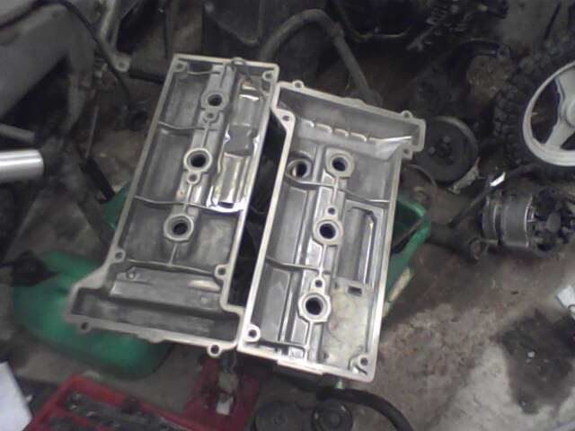

rocker covers a bit cleaner now! :D
virosol is the mutts, it cleans way better than gunk or jizer and dosent leech the fat from your hands and dry out your skin like they do, and its less than half the price of either - amazing stuff!!
heres a reminder of how bad they were..

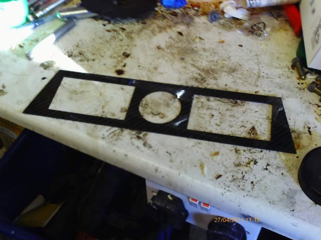

also finally got the drawing done for the carbon insert for the dash pod, dropped it and the carbon sheet off at the waterjet cutters on friday, should have it back in a week, might even have it built and working by the end of the weekend, cant wait :lol:

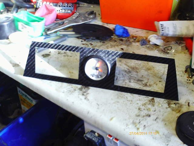

more work on the dash pod, got the carbon back from the waterjet cutters.
the cutting was done by http://www.aqua-dynamics.co.uk at a cost of £47 and the carbon came from http://www.carbonology.com but the guy who did the cutting said the carbon wasnt very good quality :( it was full of surface pits and the weave wasnt tight, so it chipped on the weave when cut, he re cut it from the reverse and it cut ok that way, but it cost me a bit of my carbon sheet to find this out. he showed me some stuff that he buys which was better, but you'd need to study it really closely so im happy with what ive got.

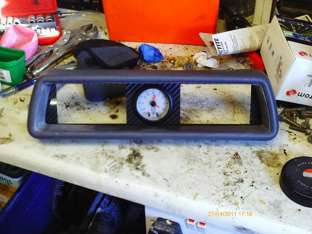

clock installed....

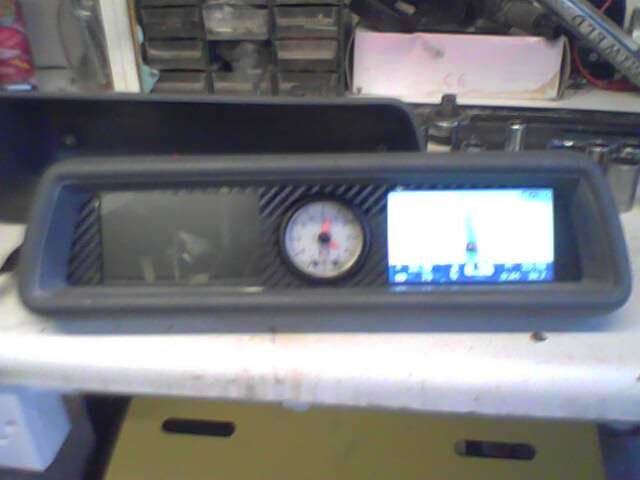

and in the dash pod....

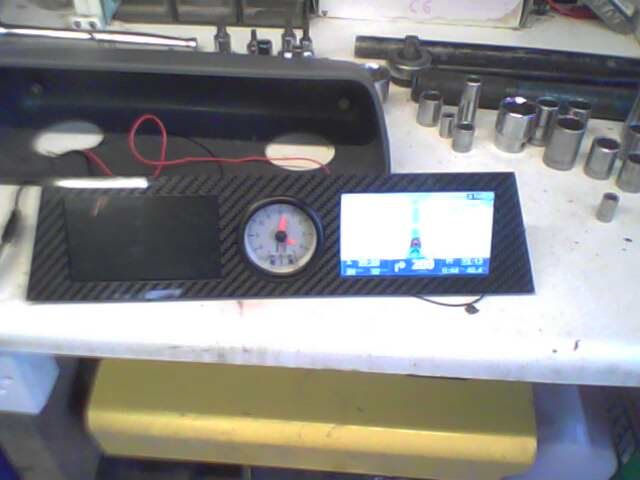

TV on the left, satnav on the right - wont be long now :D

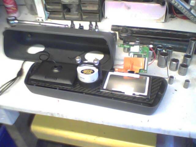

got the TV screen and the guts of the satnav bonded onto the carbon, just waiting for the plastic polishing kit to arrive so i can tidy up the front piece where ive cut it and then that too can be bonded to the carbon.
im going to make up a bracket that connects to the brass inserts in the back of the pod to the screws that hold the clock to the carbon, thus holding the front of the pod onto the rear part.
i can access these from the holes underneath, then access the mounting holes for the whole unit through the radio aperture, this way all the fixings will be hidden. :D also got some veroboard so i can make up the relay unit that will switch the satnav on and off with the ignition.
