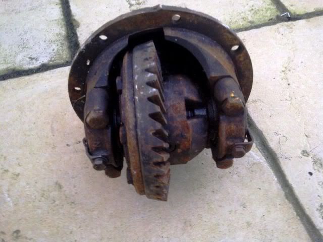

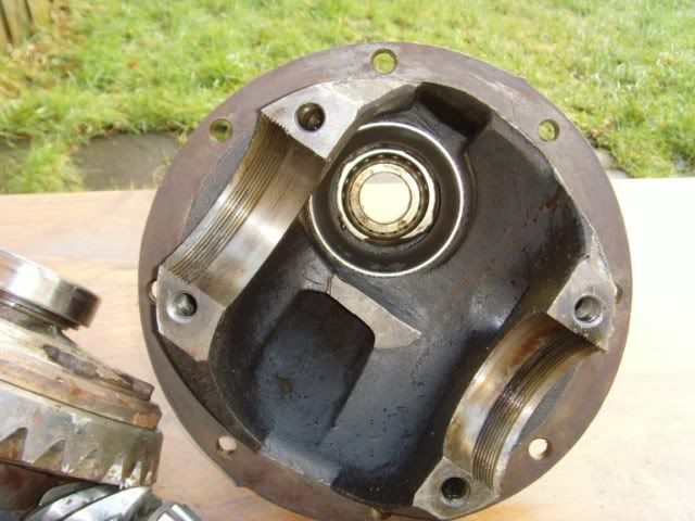

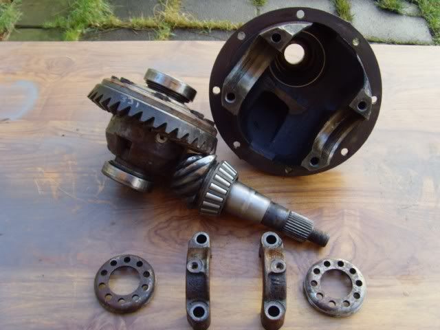

Managed to win a 4.1:1 Diff off ebay which i`m hoping to rebuild, it was quite dirty when i recieved it so i`ve stripped it part way down to give it a clean and check the teeth and bearings.
The diff bearings do seem to be ok but the inner Pinion bearing there are marks on the race and the outer bearing has quite a bit of play. I need to drift the inner bearing race but i`m not sure how the Outer one is removed.
On the Diff bearing outer race the numbers are 16284-N Japan Koyo Hi-cap
Outer Pinion Bearing HM88542 England Timken
and for the inner pinion i will need to remove the race to get the numbers

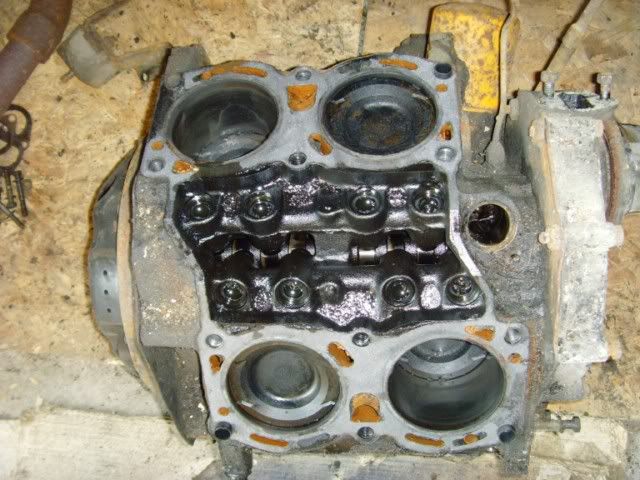

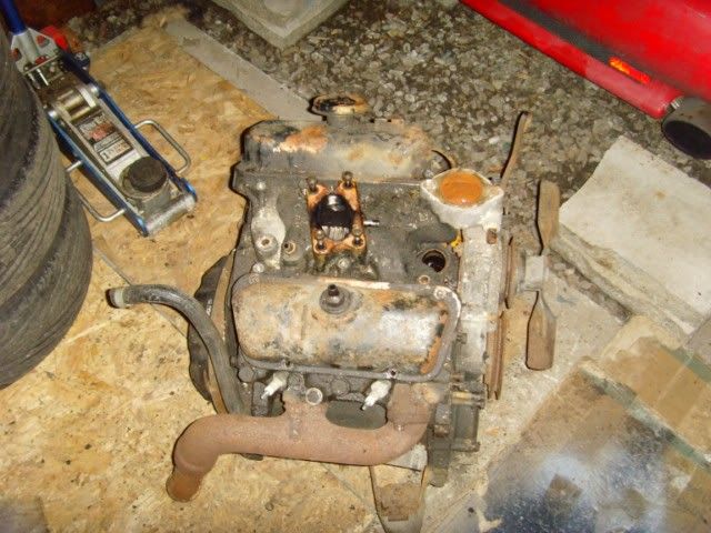

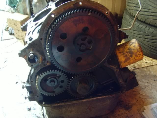

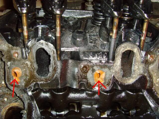

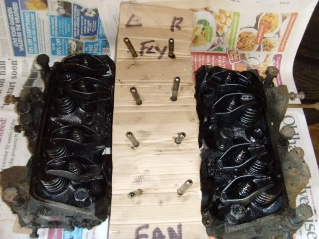

Started to strip down the Corsair 2000E engine that i bought, suppose to be the same as the GT version :???: I`ve got the bottom end Gasket set and i`ve ordered the top end from this place for £22 delivered :D http://www.gaskets-direct-limited.co.uk ... .asp?c=443
On removing the Thermostat housing guest what? there was no thermostat :roll: so must of had heat issues but think this is down to part blocked waterways in the head to inlet manifold (see pic). The pistons and bores look good at this point.
Need to get a bracket made for the engine stand as one is missing then i can get the block attached then remove sump and decide how far to go. But it all needs a good clean.

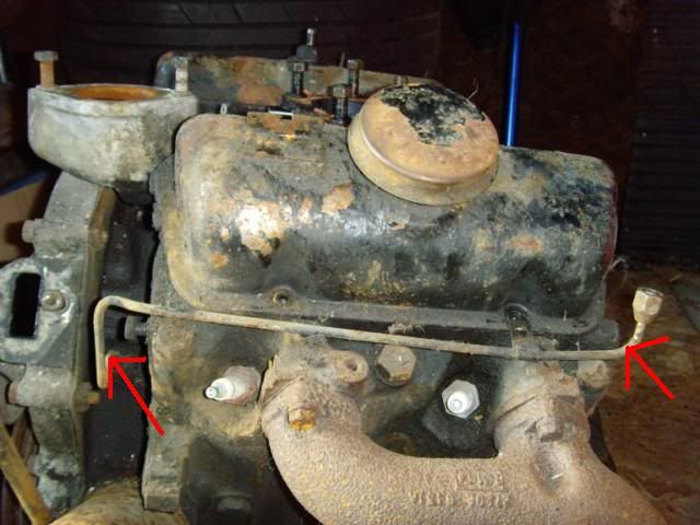

Anyone know what this pipe is for?
Part Blocked waterways from head to inlet manifold

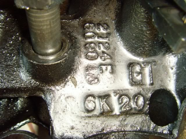

Head numbers, GT?
timing cover removed
