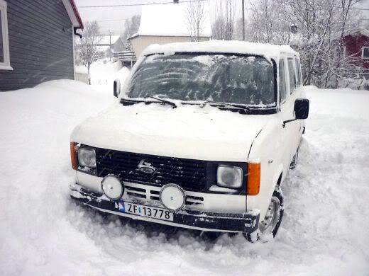

I saw a 1980 diesel transit for sale in the paper. I had been looking for a MK2 diesel for a few years, the only problem was that this car was 2000km away. The only photo in the ad was this:
But I would not miss the opportunity so I called the guy, said I bought it without seeing it and asked for his account and transfered money. The transit was mine :D

The Transit looks great. Not much rust because of the salt/snow ?

Thank you for welcoming me to this great site. There are lots of interesting info here. My car is made in Germany but i guess it is quite similar to the English Transit.
Yes the car has unusually little rust(we have a lot of that in Norway) I was very happy when I saw that since I bought it without seeing it :)
