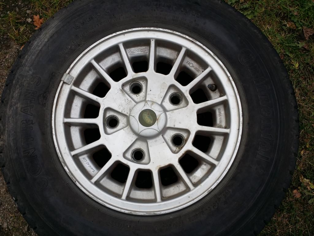

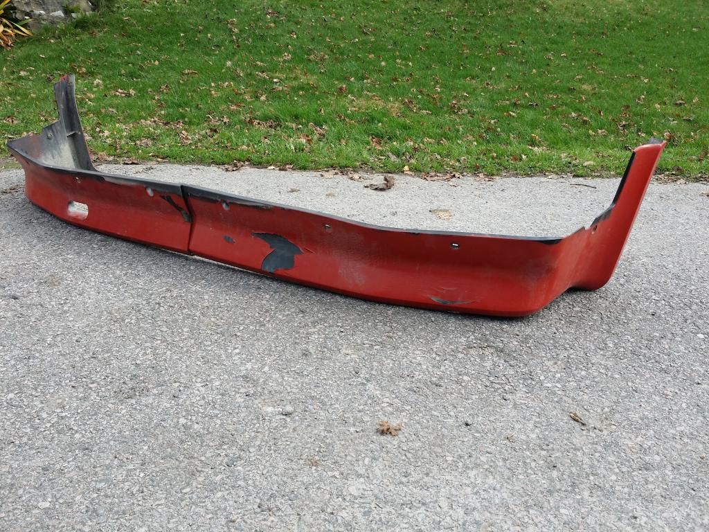

It has been long brake but will start working on it again soon. Just bought some parts. Ford RS wheels 7X14 and a front spoiler :)

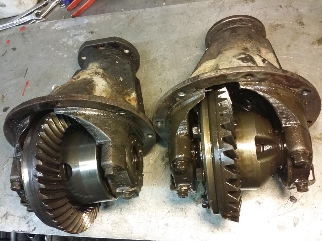

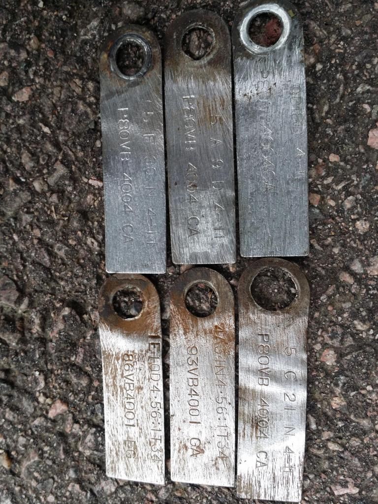

But I have a problem I have been working on for a while, How to get a LSD axle for my MK2? Can anyone help me with what the numbers on these plates mean? Ratio I understand but are any of these a LSD? if not, what numbers should be on a LSD plate? Useful help here would be very much appreciated :D

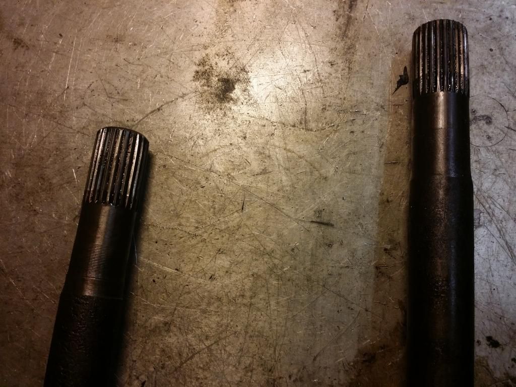

Finally I got a Transit LSD :D from a 1994 so it is wider :? But I think it will fit the MK2 housing, but the drive shafts are different, both different splines and different diameter. Has anyone solved this problem?

I sold an LSD center which would have fitted yours not that long ago :(
For the halfshafts to fit, you need to find a pre '86 one...

can't you fit the complete mk4/5 axle? will the wheel still fit inside the arches? i know a standard set does :D
