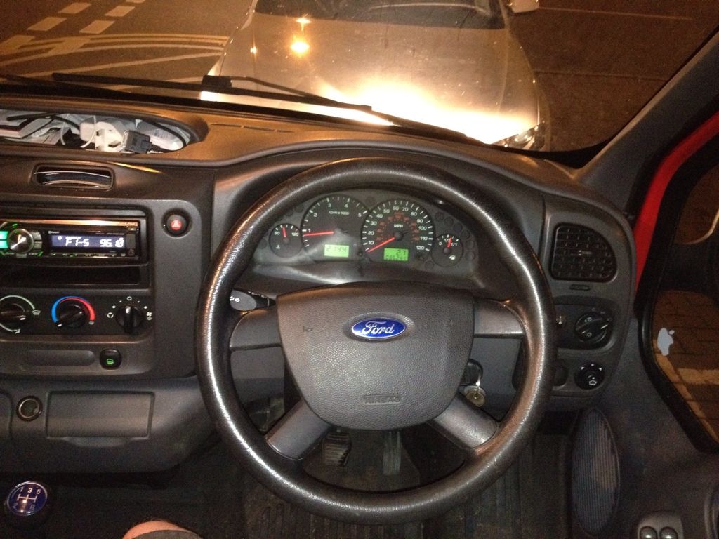

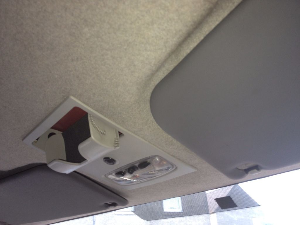

Blanked egr, bashed out dpf, fitted new seats from mk7 and wheel and airbag, new stereo and my favourite mod is my new interior lights and sunglasses holder 8)
ImageImageImagei am tempted to paint the mirrors and I'm saving for the wheels, I'm off the fags, so the savings got a boost! :lol:

Wheres the interior light/sunglasses holder from? looks like the ones in the new mondeos.

ibanez2005 wrote:Wheres the interior light/sunglasses holder from? looks like the ones in the new mondeos.
i think it is from a mondeo the look 8)

I'm afraid it's out with the grinder and drill for the steering wheel :lol: the light and glasses holder is from a high spec mondeo cool isn't it 8)

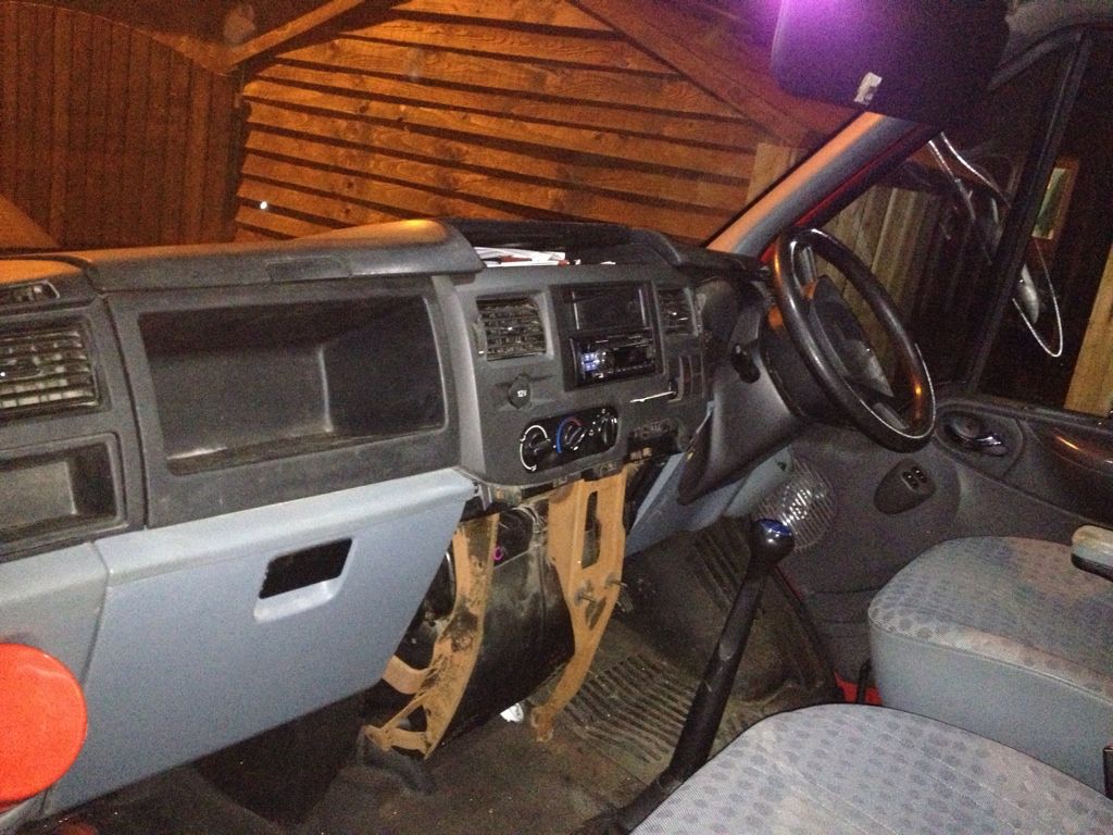

Postby Punto443 » Sat Oct 06, 2012 8:56 pm

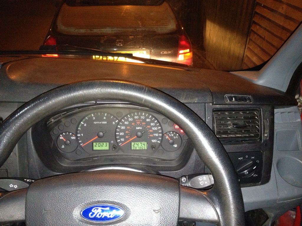

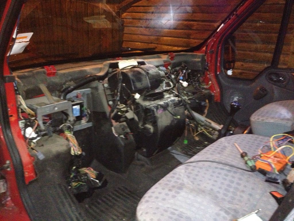

been busy this week, mk7 dash and plastics!ImageImagestill need a few bits, drivers door card,speedo cowel adjusted, switch for the mirrors+the bit above the cup holder for the mirror adjuster and new seals or cover plate at the door checksImagestill got these to fit! but have to wait on the selector comming :( .

Postby Punto443 » Sat Oct 06, 2012 9:06 pm
this bit needs a bit of workImage the whole thing wasn't to bad a job, worst part lifting the dash in myself and lining up the heater ducts! the heater controls are from the mk6, just needed to swap cable on the temp dial for a longer one, and needed a light switch that had front fogs :)

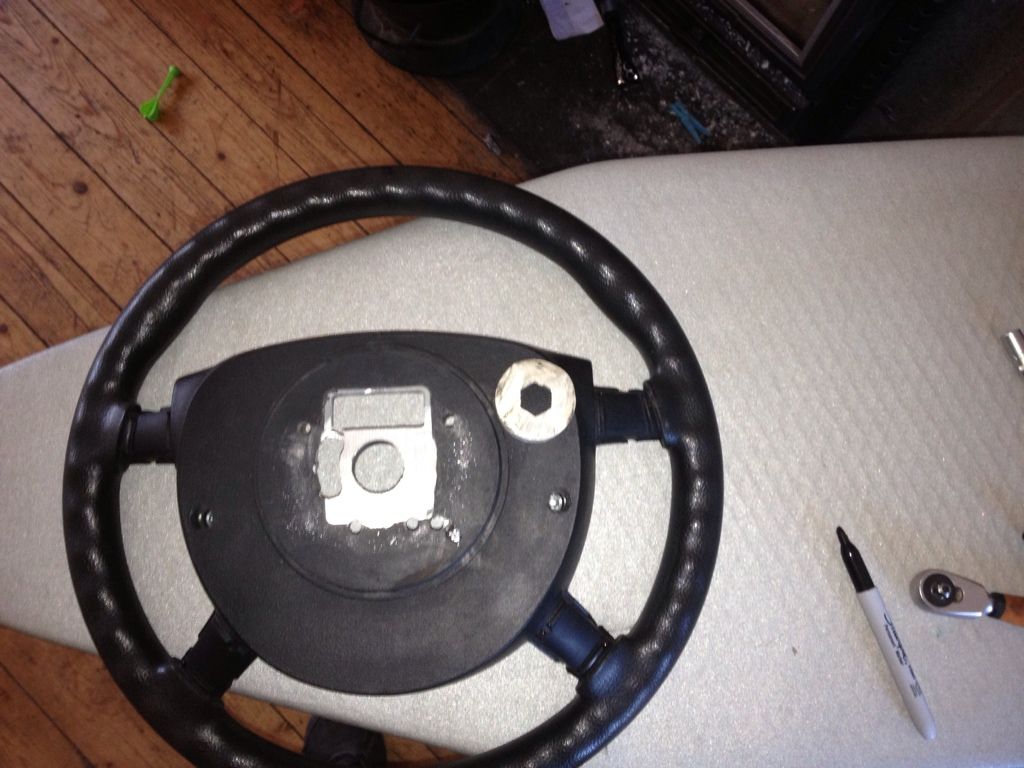

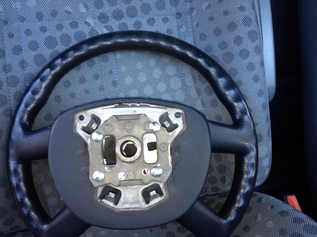

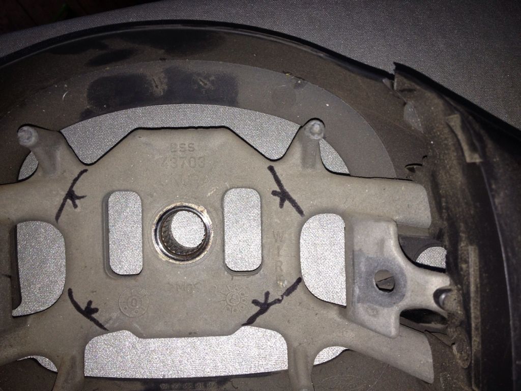

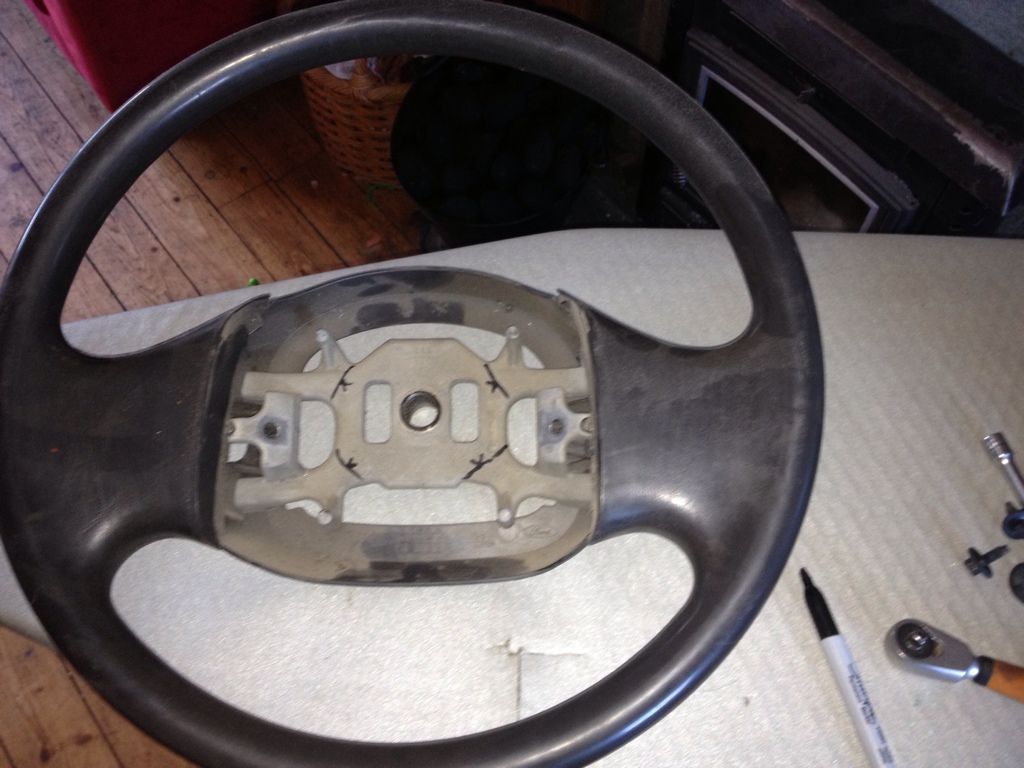

Right, been asked about the steering wheel abit, here goes,
Take a mk6 wheel, best to get a spare, just incase Imagethen I cut out the marked sectionImage. Next get your new wheel and grind of the boss at the backImagethen bolt the new wheel to the bit cut of the mk6 wheelImage. Cut out the slot for the airbag/horn wires and the main bolt goes through the new wheel centre and the old boss, sandwiching everything together
Thread lock everything and you probably want to disconnect the battery too!

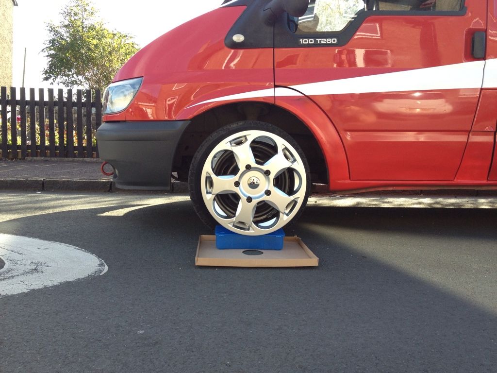

Repainted the front bumper, ordered viper stripes and wheelsImage

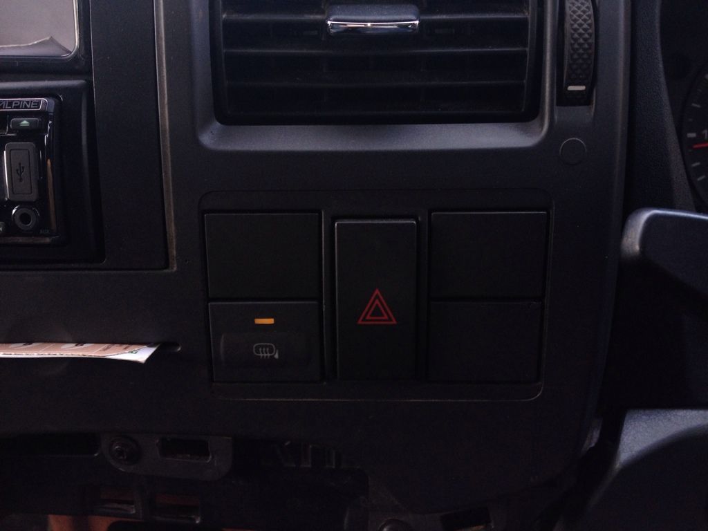

My wheels came today :D but wrong part for the gear selector! Annoying as I wanted to finish the dash!

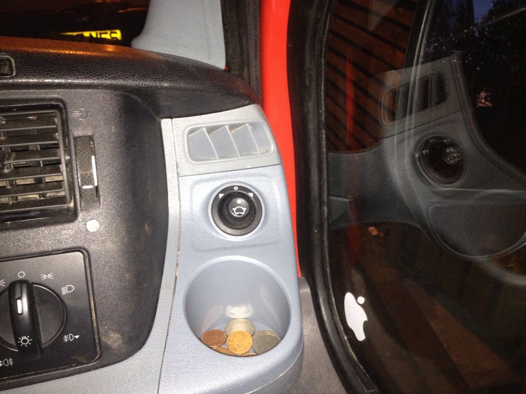

Fitted the mirror adjuster in the new cup holder and modded the switch, we'll chuffed with the switch, looks good and all the lights work too!ImageImageImageive left them in the hall, so the missus will keep bumping into them, With a bit of luck she'll tell me to just get the tyres on her card so she can get them out the house :)
