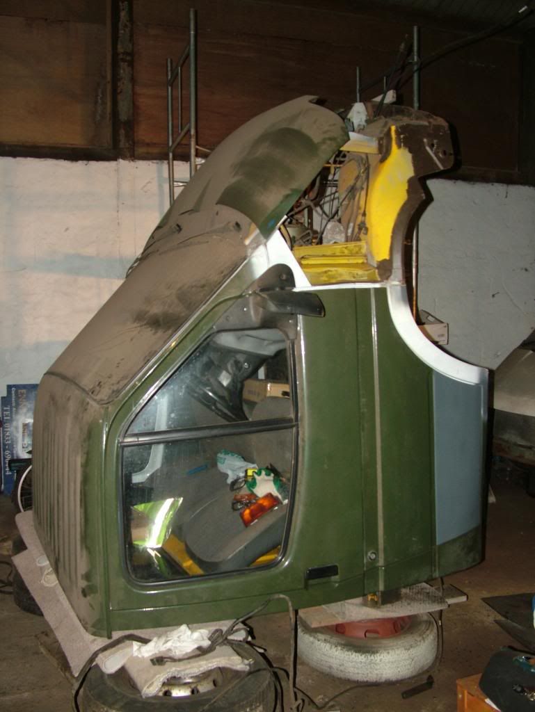

Postby Mr RVM » Wed Apr 24, 2013 10:48 am
MinorMatt wrote:I think the chassis is missing...
Did you notice that too :?: :lol: :lol: :lol:
Just got chassis back yesterday, after major reconstructive surgery involving over 30 feet of welding its been blasted and coated in some top of the range zinc based thingy stuff :D looks mint now will get a pic up later, lots of work done to cab while its been away so soon it will be time to get it fitted back on, hoping to get it done before i go back to work on the 2nd, so still have well over a week

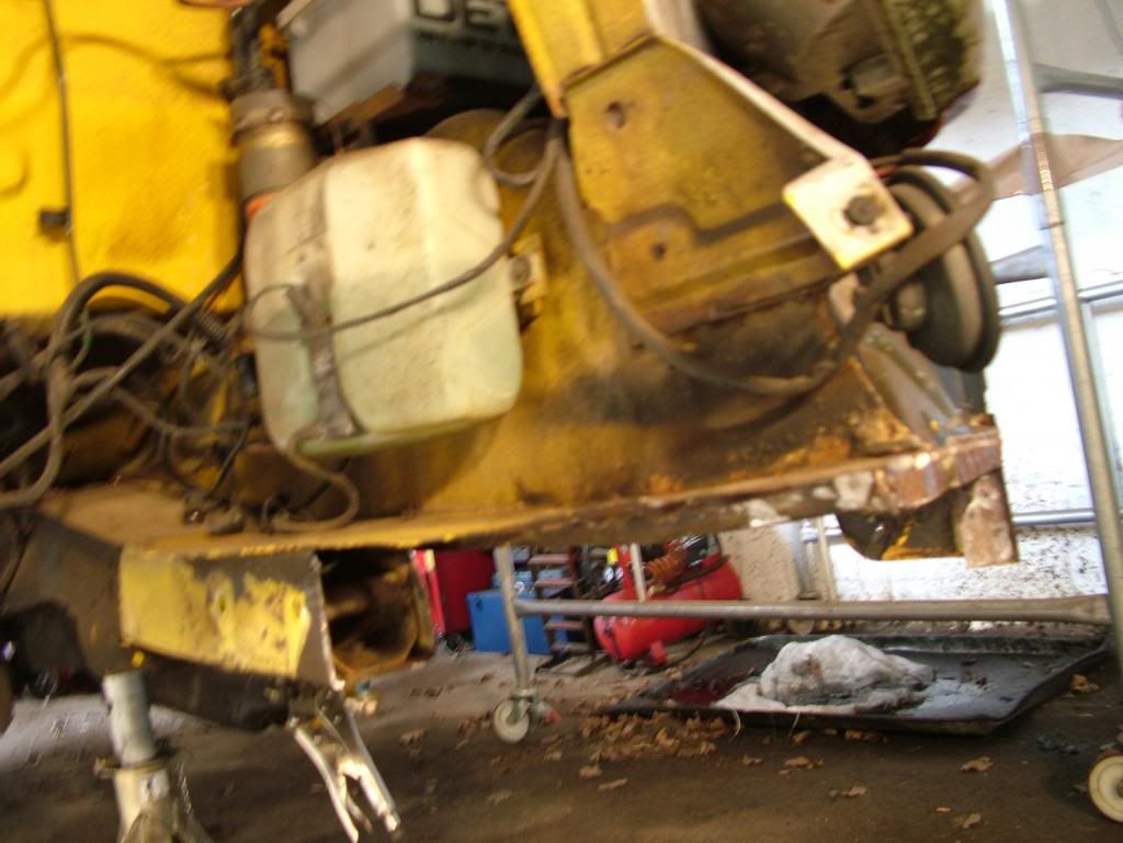

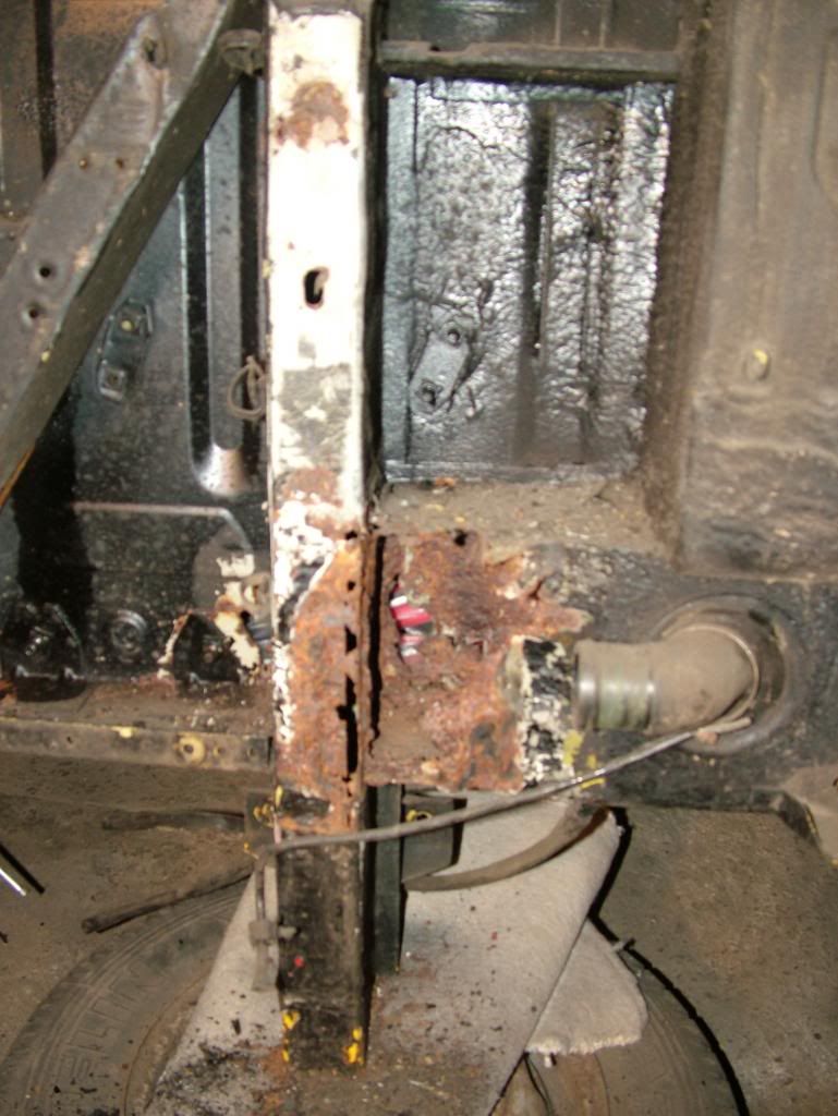

Then i began stripping the front end to facilitate removal of the engine, grill,rad, slam panel etc, all was going to plan nothing seized no clips broken and then when i pulled the rad out i noticed a not too healthy crossmember further investigation uncovered loads of fibre glass bridging compound covered in copious amounts of underseal and once i hacked it all out there was nothing much of the original crossmember left :shock: wasnt really too bothered as recent to this time got a crossmember and front cover off ebay from a guy in the shetland isles new and unused described as "for a smiley face transit" when it turned up it was for a Mk3 but wasnt goin to get upset i won it for 99p plus £20 delivery :lol:

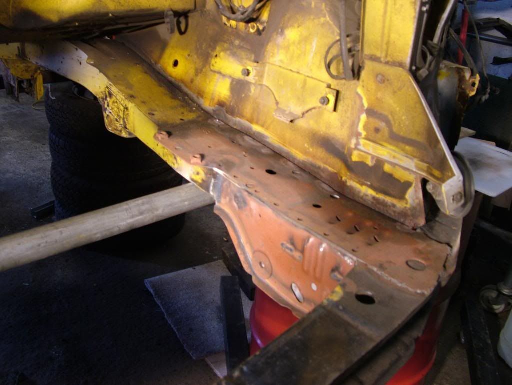

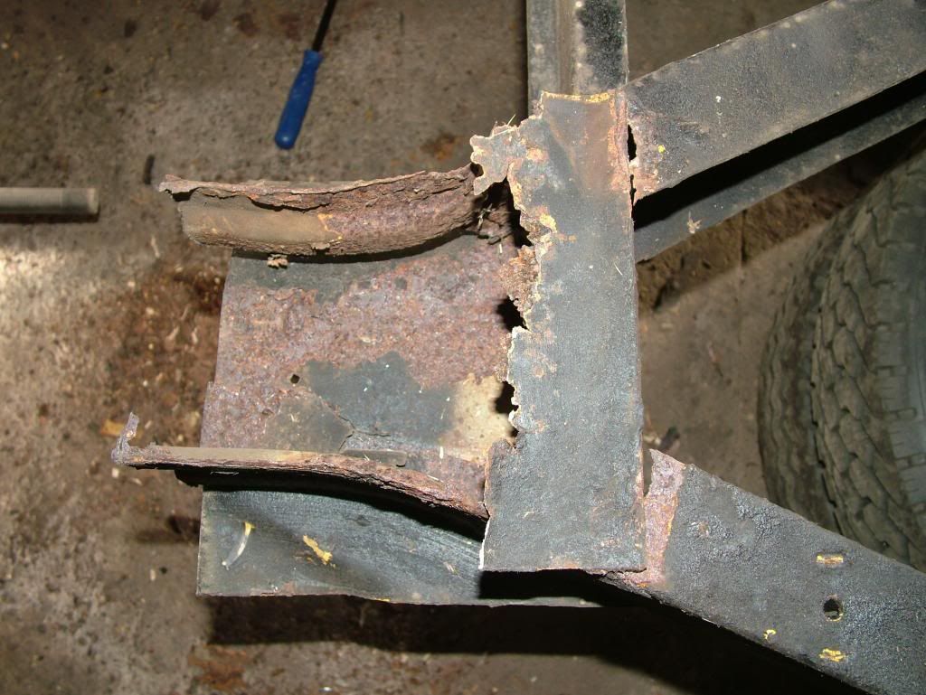

I set to removing the remains of the offending member when i noticed the front spring hangers didnt look too good either so after a cuppa and a fag to relax my teeth i cut them out too :!: and ended up with this Image Image

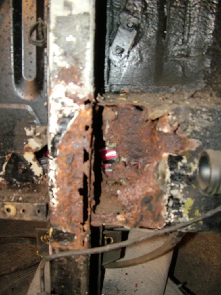

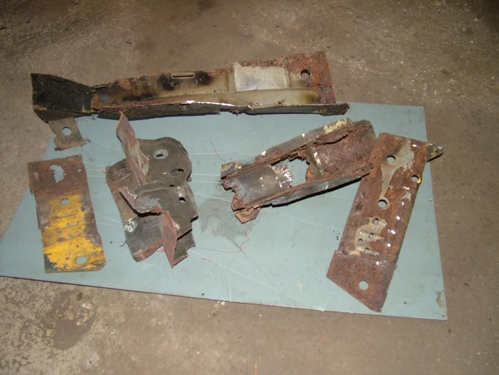

this was the pile of rust i removed Image
Iended up cutting out the top of the chassis because when i cut out the spring hanger on the driver's side i noticed that the top of the chssis leg was almost non existent under the steering box bracket :cry: :cry: :cry:.........TO BE CONTINUED

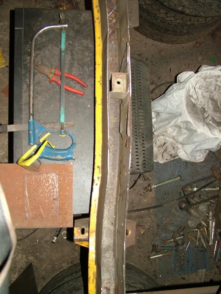

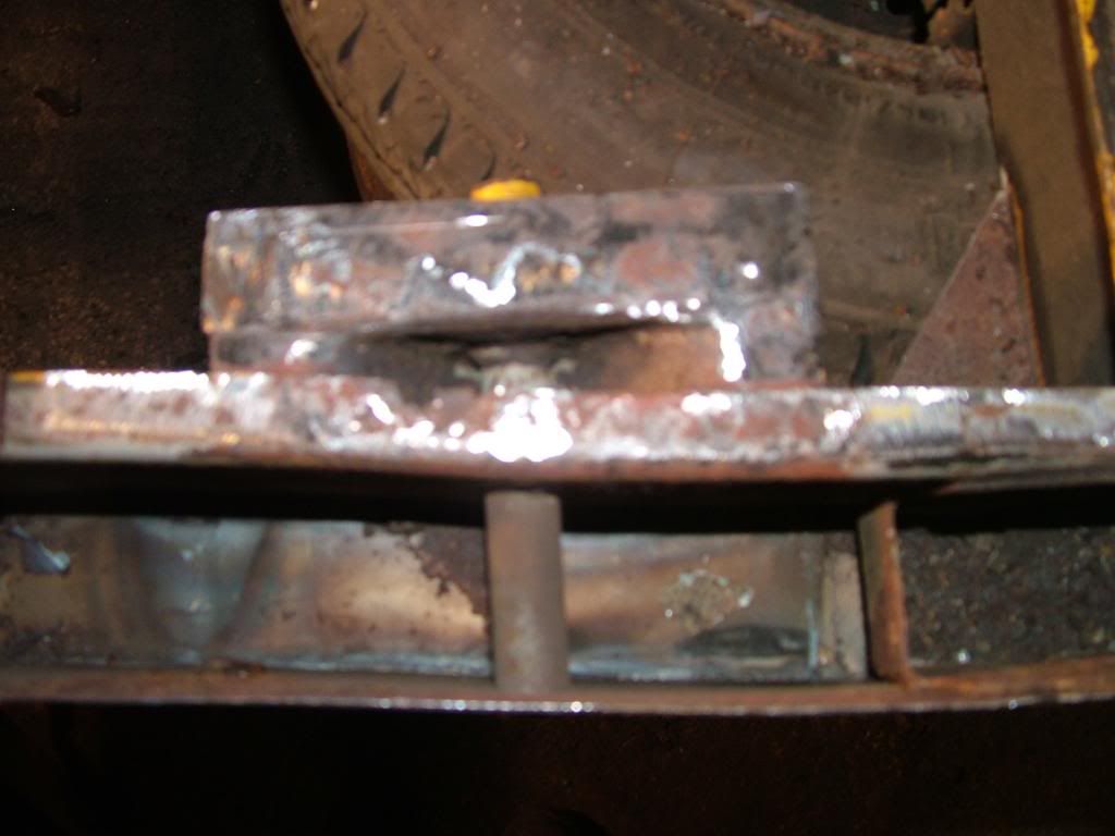

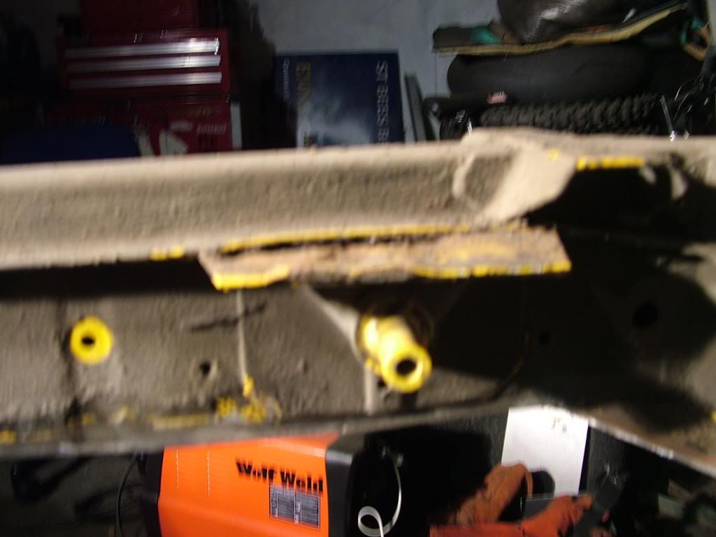

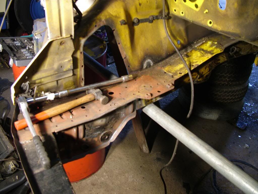

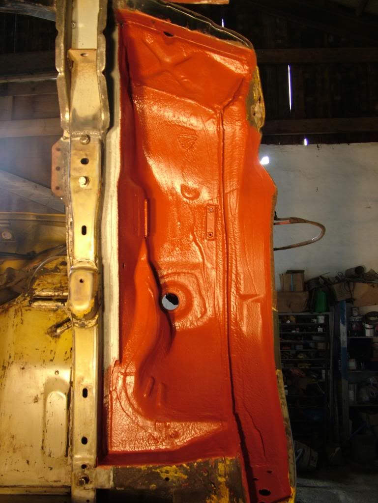

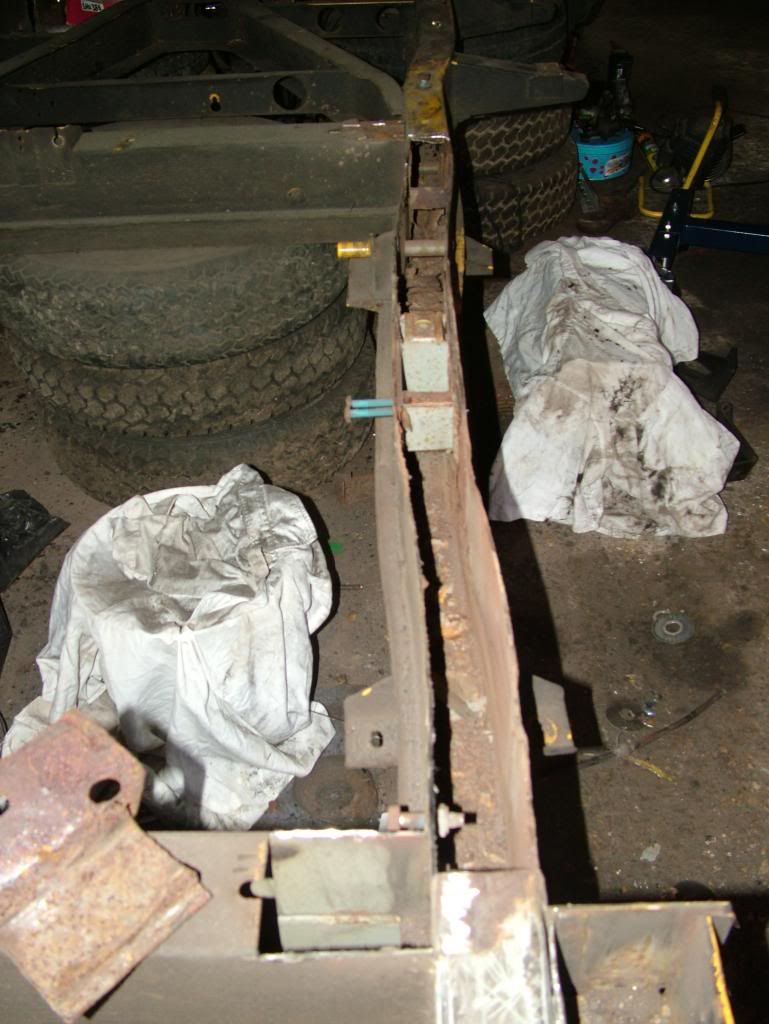

Replaced the above with some new channel and the hanger side plates salvaged from my old Mk5 along with the chassis leg tops which are thicker than original Mk3 one's therefore (hopefully) stronger, these had to be bent to match Mk3 chassis legs as Mk5's have straight/flatter front legs :!:
they ended up looking like this.......
and from the underside.....

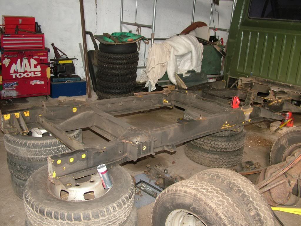

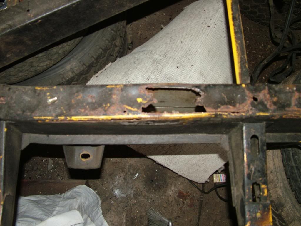

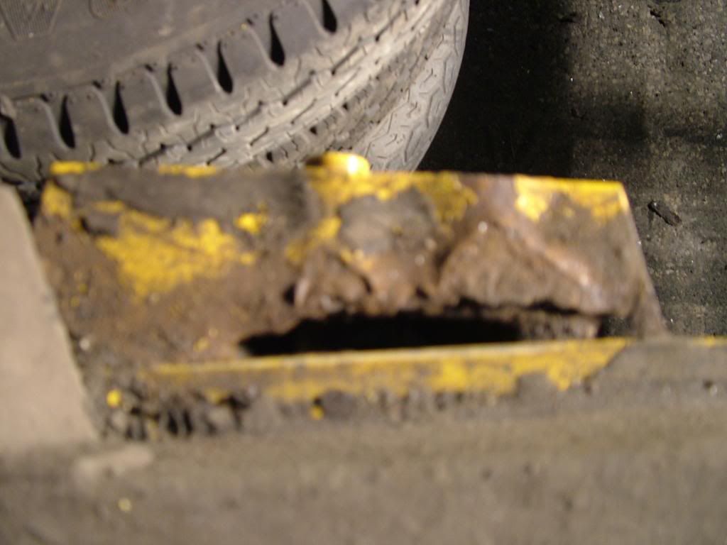

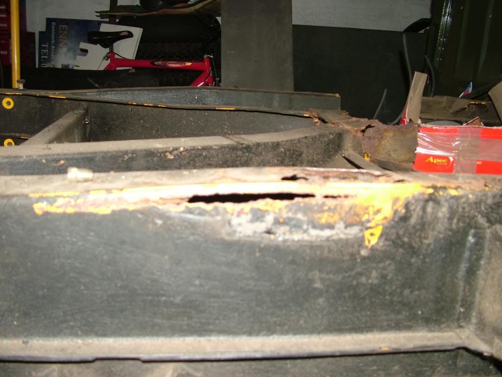

Then I turned to the rear chassis.......
Which as you can see from the photo i cut off and turned it over to do the work....
and boy it needed some.....
So out came the grinder and the slitting discs...
More later........
