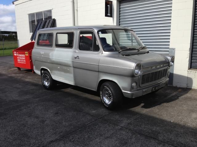

I went to his place yesterday, fitted a new battery, poured in some 2014 vintage fuel, and fired her up. I drove it up the road to make sure it had brakes etc, seemed near enough so drove it to my storage unit about 25 minutes away without incident.

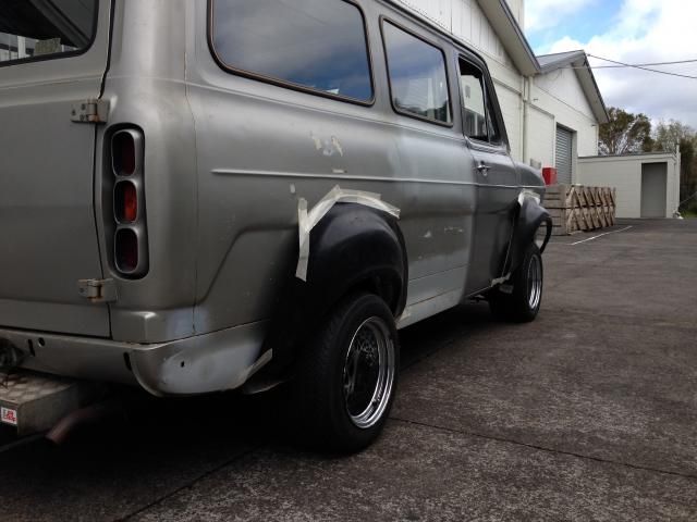

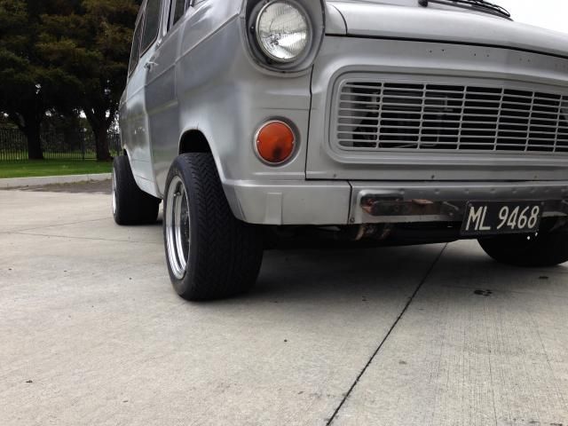

So after collecting the van yesterday I swung past a friends place and picked up a set of wheels off his Pantera, thats 15x10 fronts with 285/40x15 tyres and 15x13 rears with 345/35x15 tyres. It is just so happens by pure luck that the Pantera has the same Ford 5 stud bolt pattern as the Falcon running gear that has been fitted to this van, so on they went:
followed by a set of works Escort arches:
So the plan at this stage is to get the van roadworthy, nothing major, new front brake discs and pads, sort the intermittent starting issue, get both sides repainted, good groom and use and enjoy it over summer. Then will start on the Supervan conversion next year sometime :) Happy days.

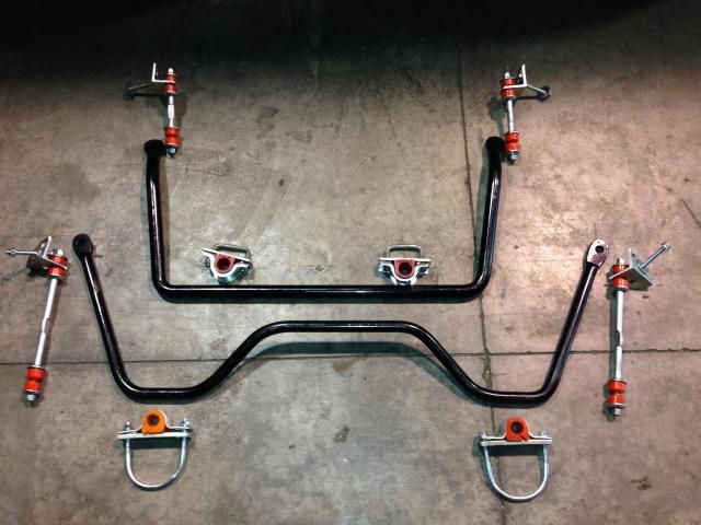

Postby transit jono » Mon Sep 29, 2014 8:51 pm
I like both sets of wheels, lucky man.
What's the anti roll bar off?
Member of the "Mk3 Massive"
1989 Mk3 Transit GL,coming together slowly. 4 x Mk3 and one AA Mk2.
Mighty,mighty Bees, still proud
transit jono
Posts: 872
Location: Margate, Kent Coast
Re: Conrod's 1972 Mk1 V8
Postby conrod » Tue Sep 30, 2014 9:54 am
transit jono wrote:I like both sets of wheels, lucky man.
I think it is off a Lincoln Continental, same car the diff came out of. I bought this setup for my other van from K-Mac in Australia:

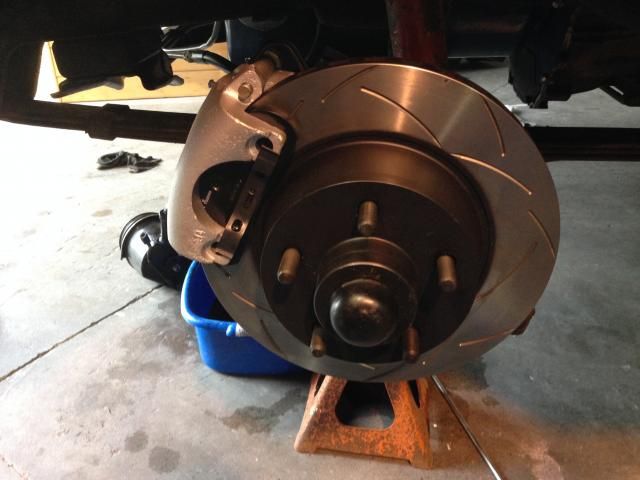

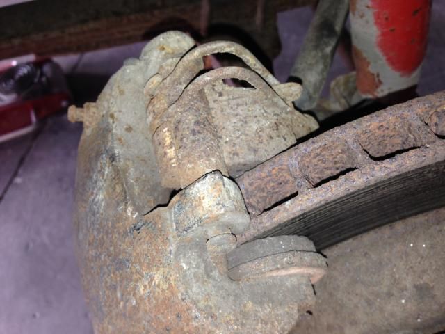

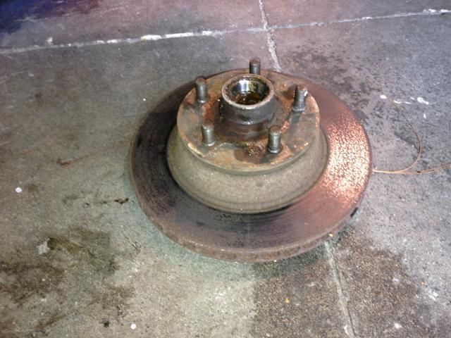

Been working on the van a bit. Front brakes were quite rusty from sitting around, and wheel bearings were knackered, so I bought a new pair of slotted DBA rotors, and Ferodo DS2000 pads, and overhauled the calipers at the same time. new wheel bearings fitted too.

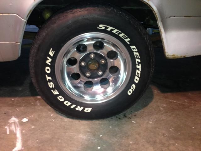

I gave the wheels a good polish, wet sanded them working from 320 up to 800, then finished them off with a polishing mop in my battery drill, only took about 40 mins per wheel and they came up mint :)

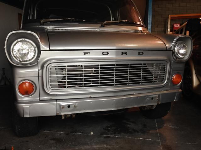

and swapped out the orange front indicators for a pair of clear ones I had, as well as refitting the headlight bezels:
Got a kit for the carb on its way, gaskets are all dried out and accelerator pump not working properly, giving a big flat spot when the throttle is cracked open. Look forward to getting that in, should make it much better to drive :)
