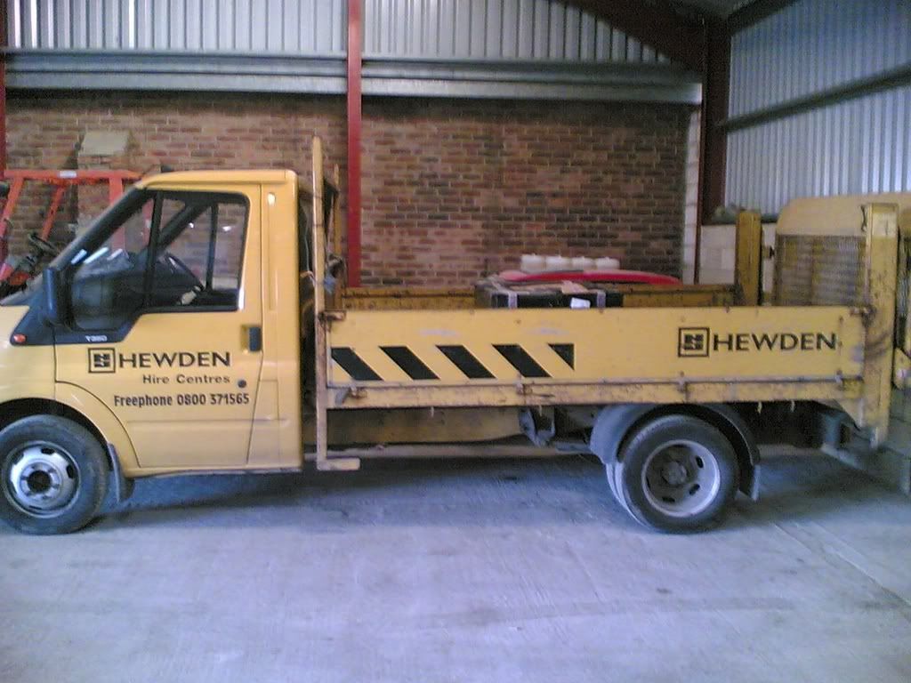

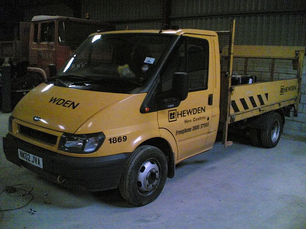

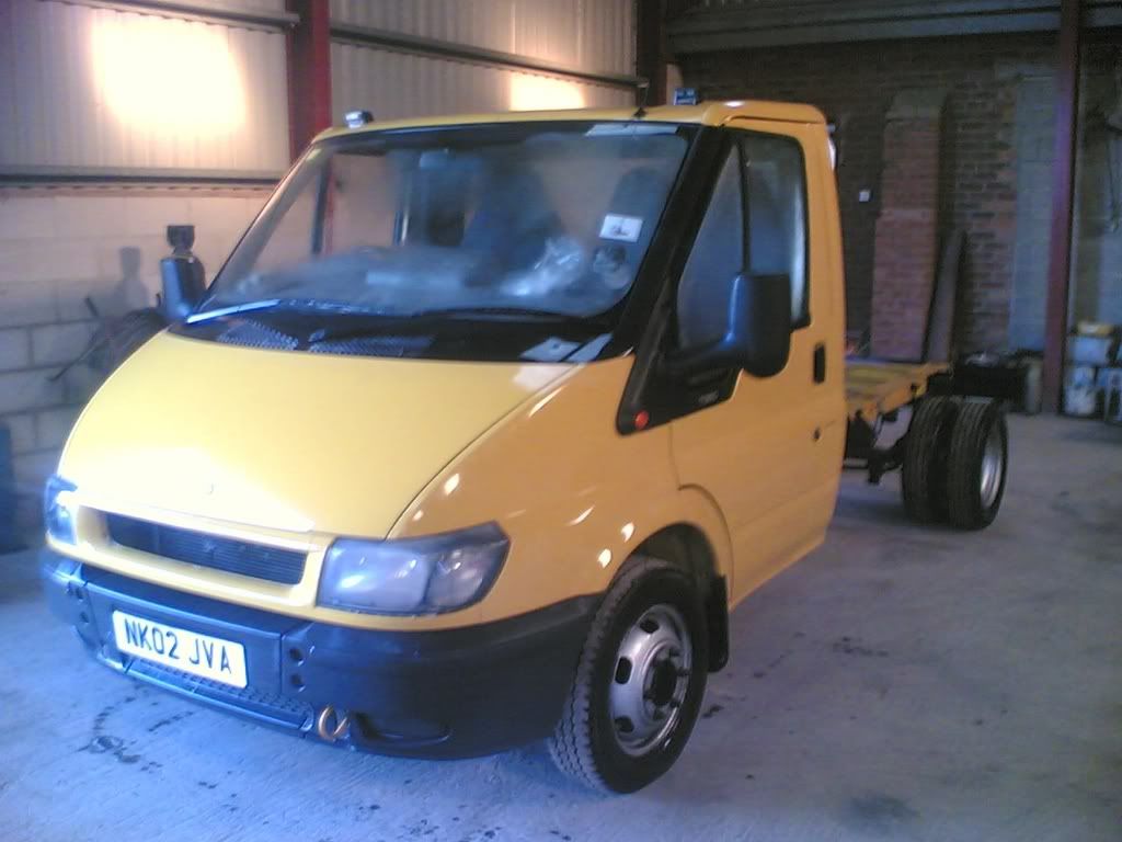

Ive recently bought a transit 350 MWB 2.4 . (why you ask when i need LWB ) well it was cheap and i thought id have ago extending it so this is what ive done please bare in mind ive never done one before and all you see is what ive done on my own

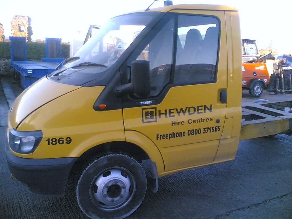

its started life as a dropside with taillift on out of hewden plant hire , tacho fitted showing about 140,000 km on a 02 as shown below
Image[/img]

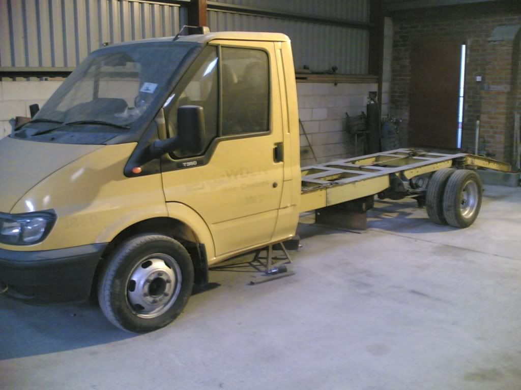

so what do i do first i thought ?
get rid of that dropside body , so you guessed ebay buy it now £250 went in a couple of days . so lifted it off and started

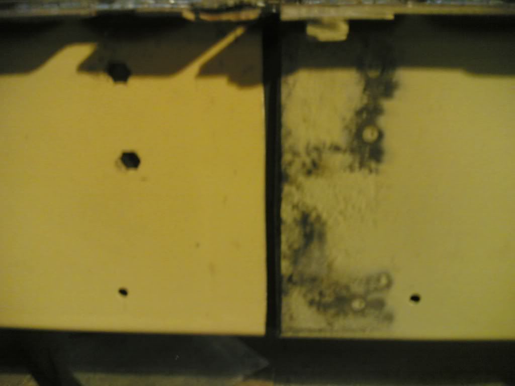

so i thought get rid of those stickers and give it a good steam off to get rid of all that muck ,wasnt having much luck pulling stickers of but steam cleaner managed
almost looks like ive painted it doesnt it well not yet :o
Image :D

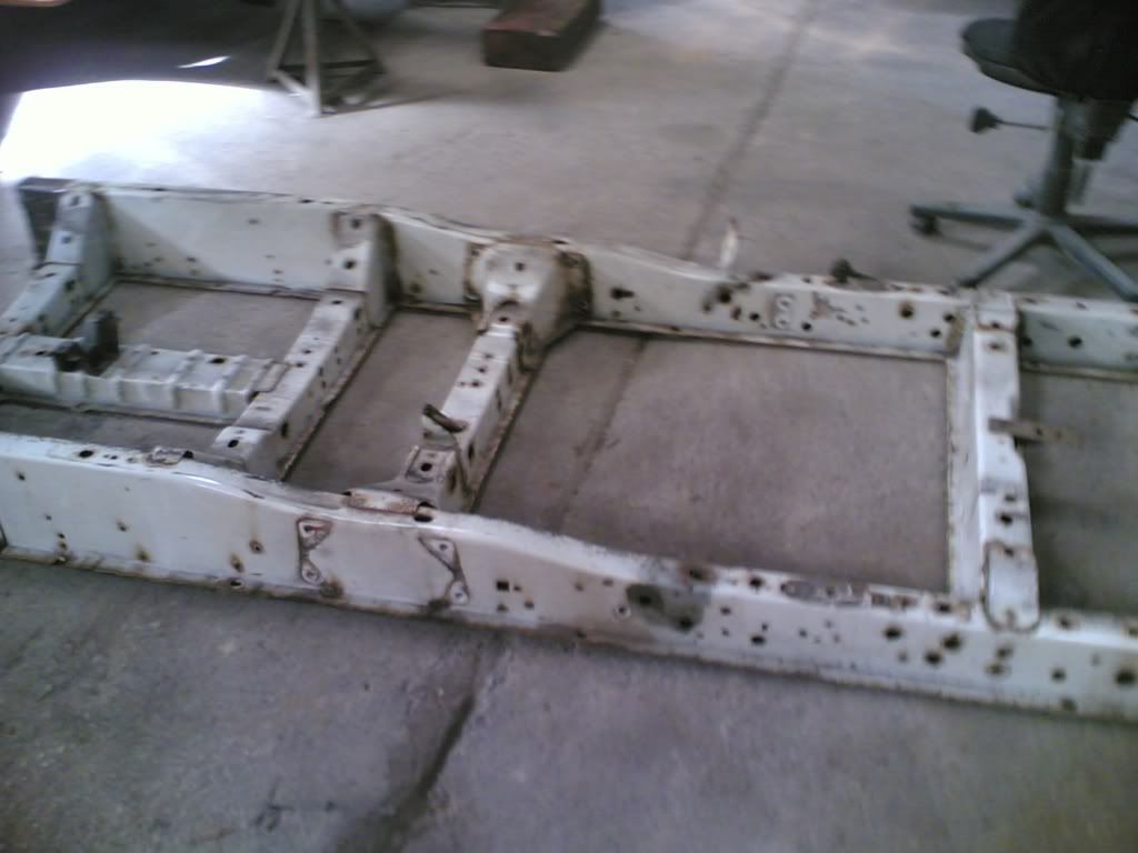

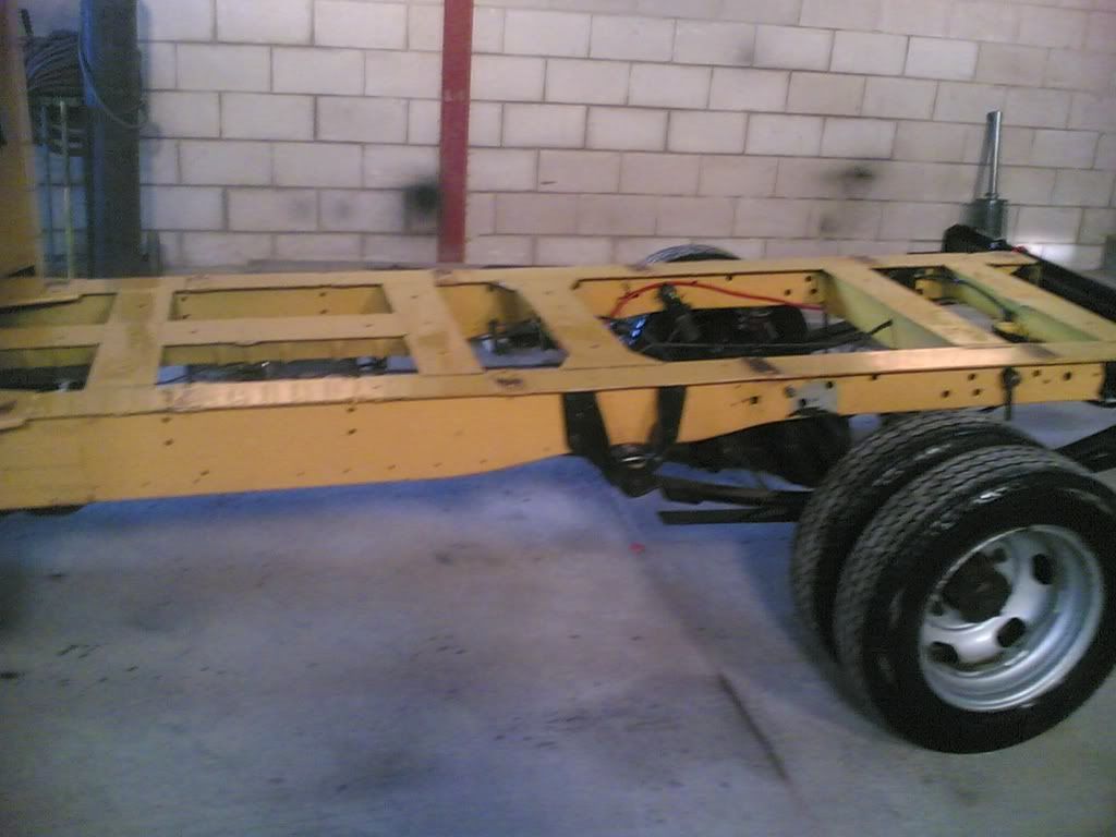

right getting somewhere now . so needed a section of chassis so off i go on a hunt my intention buy a chassis off a long wheel base simple .
guess again every one had MWB chassis not LWB so i give in i bought another MWB chassis as below :wink: and propshafts
next step took chassis to sandblasters
and got on and stripped rear end down brake pipes ,prop axles wire loom exhaust everything that had bolt or screw in it sat about alot scratching my head thinking :idea:

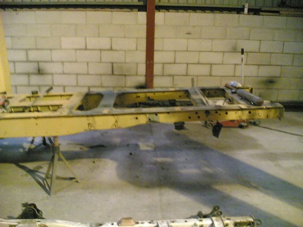

well i went and got some petrol . i thought if things go wrong ill set fire to it :lol:
no for stihl saw
to late to turn back now

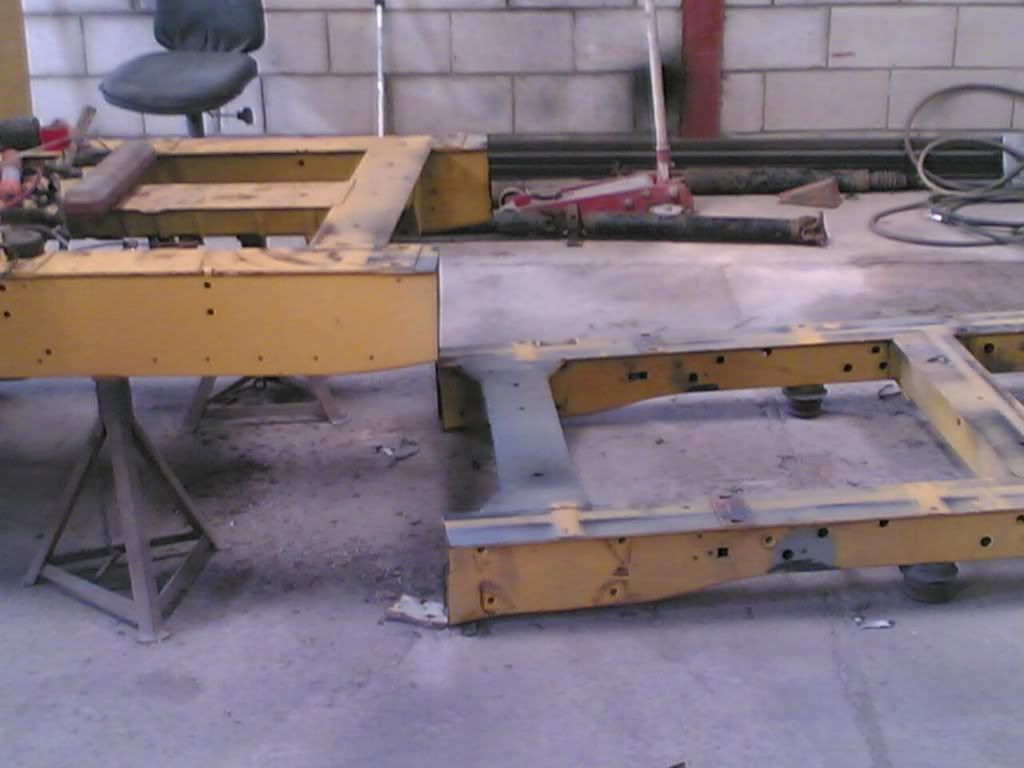

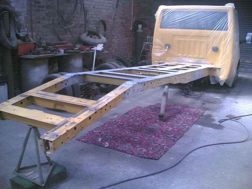

now to dress up to accept donor chassis
thinking ill put 2 foot in the length of the short propshaft
hence no alterations to prop
that was the idea but ideas can change :idea: :idea: :idea: :idea:
off to get some steel bent to sleave chassis

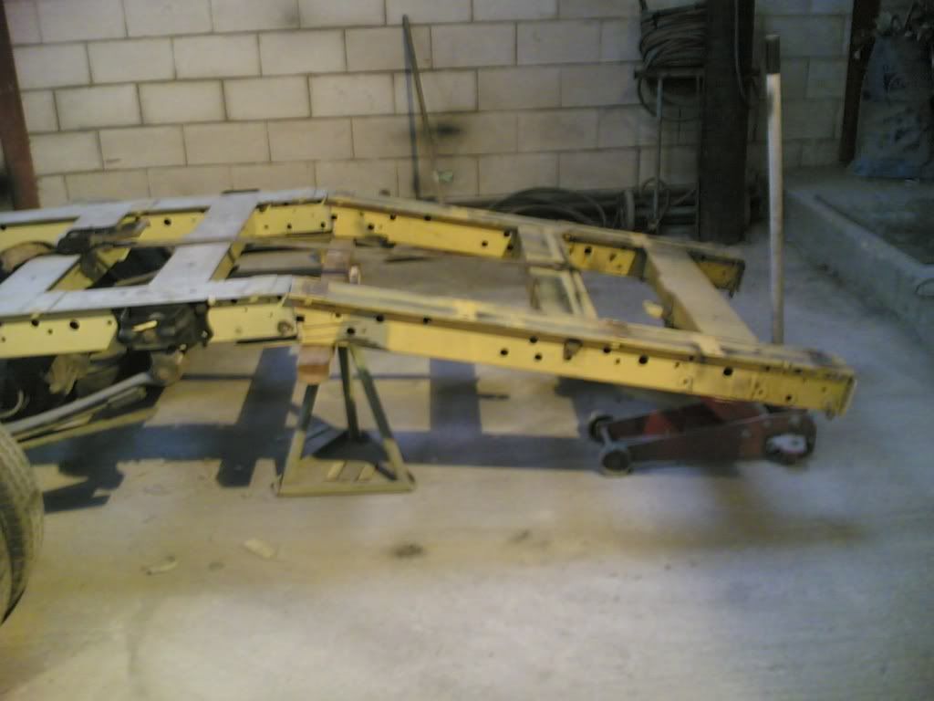

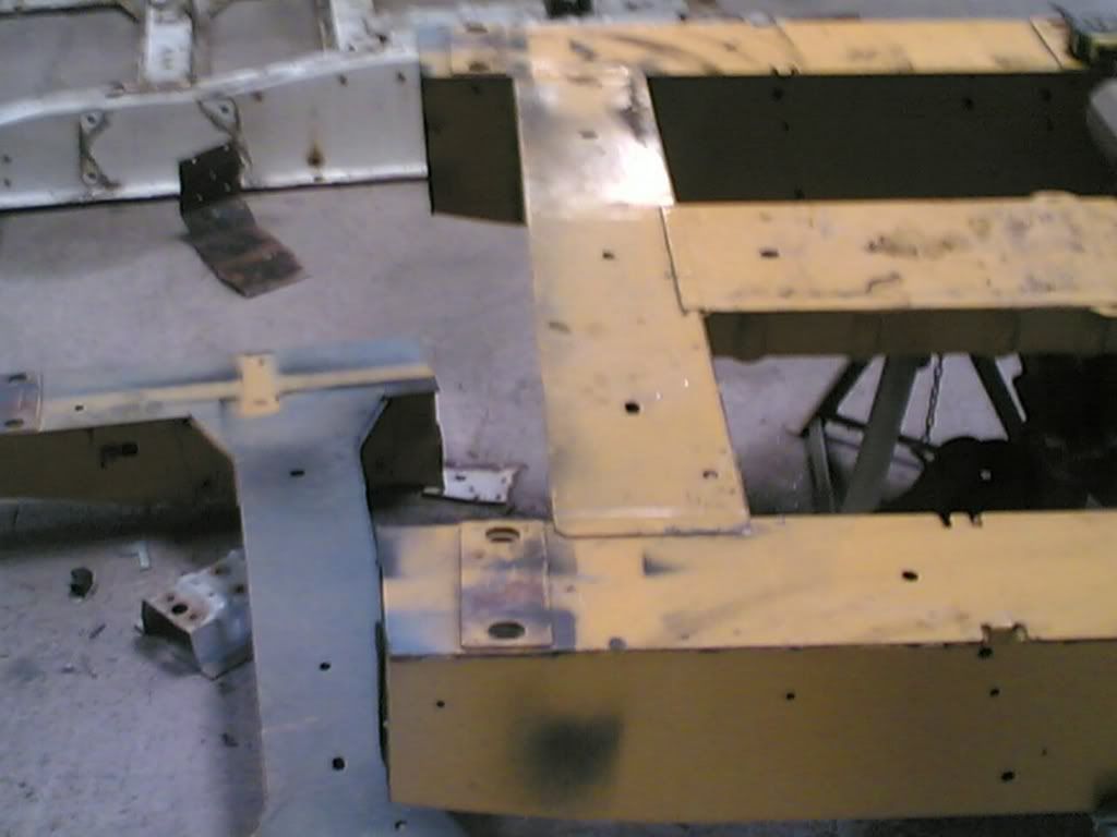

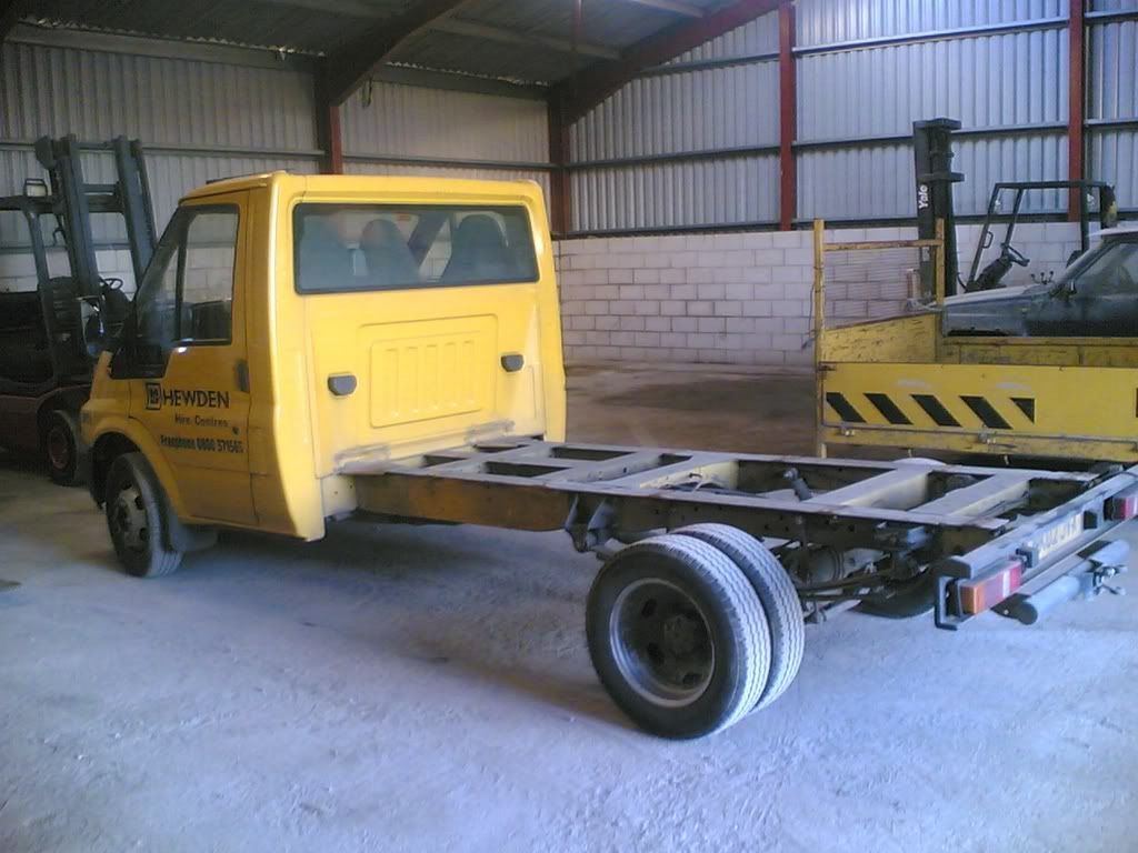

Postby transitgeoff » Mon Apr 30, 2007 6:57 pm
:? strange place to cut unless your gonna cut the yellow bit twice ?? ive done this and cut one right behind the cab and another 1 meter from the cab,and extended it by 1 meter :D but you have cut it on a tapered bit :?
transitgeoff
Posts: 6574
Postby ARTCARCOM » Mon Apr 30, 2007 9:41 pm
i i thought play safe and leave a bit on. :) on next pics you will see cross member cut out and cut to length

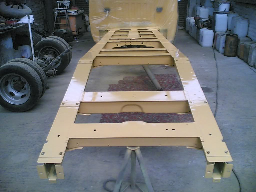

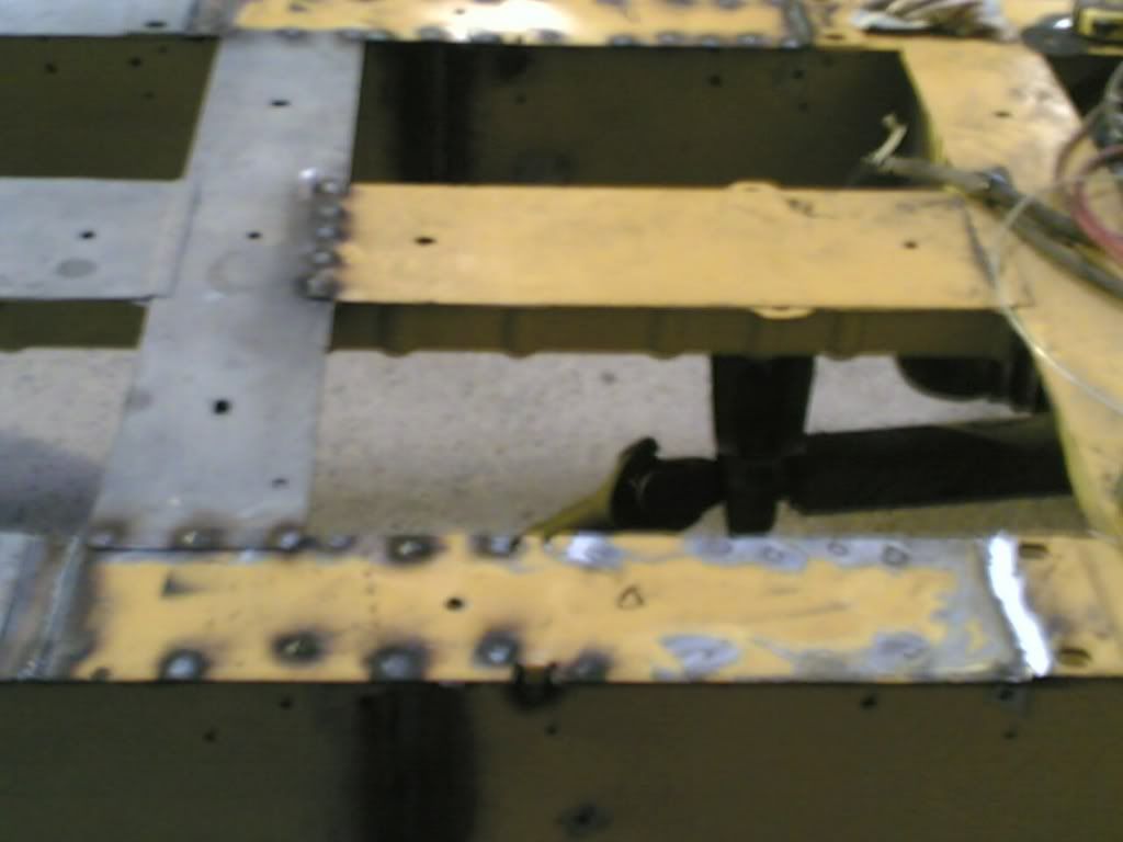

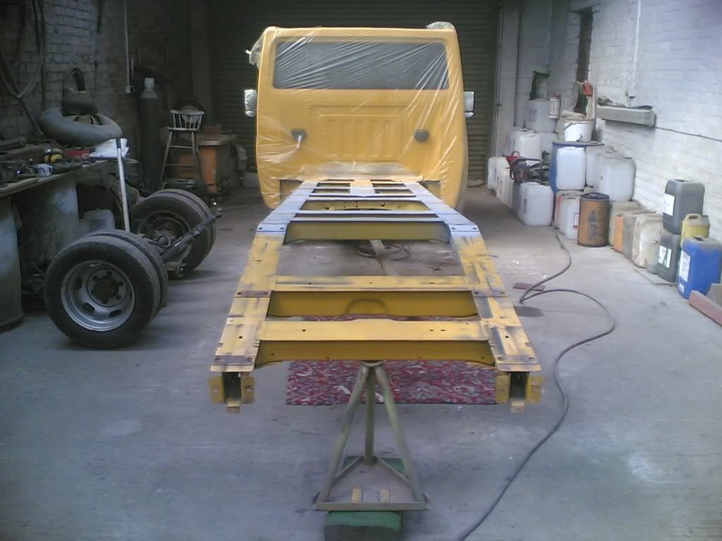

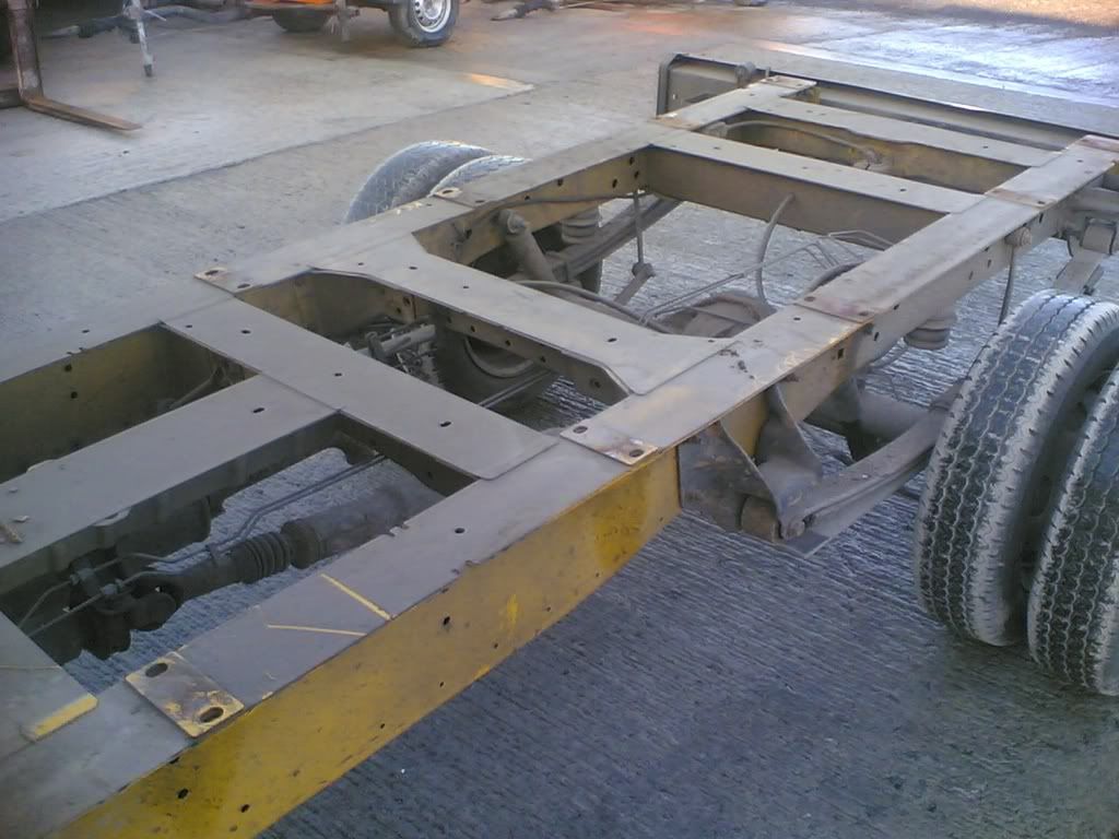

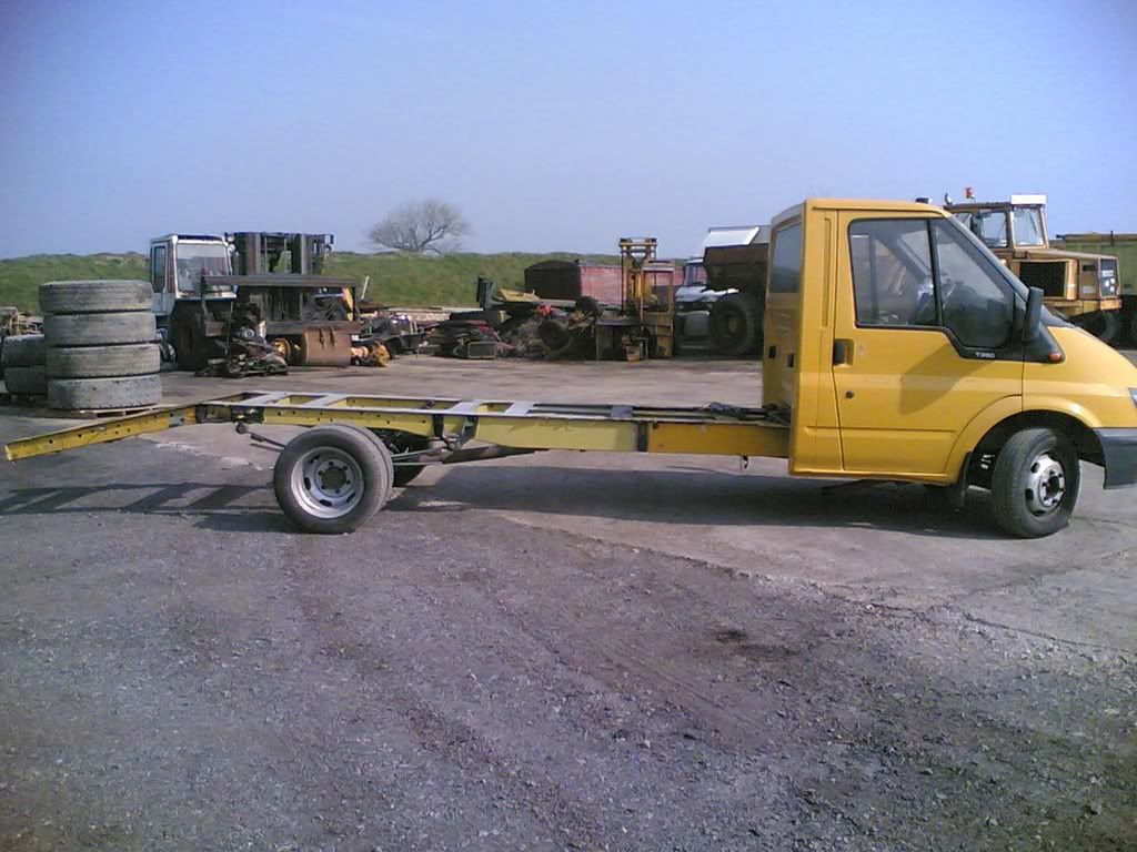

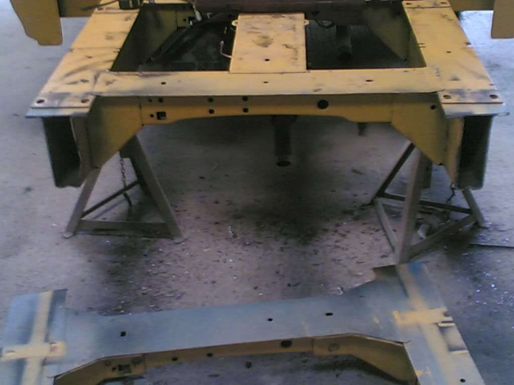

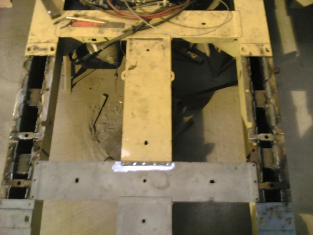

hello again . so recieved chassis back from sandblasters so etch primed it

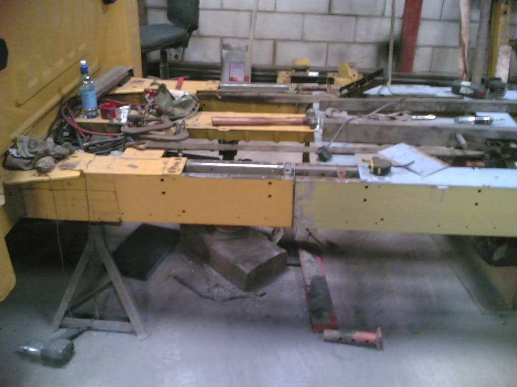

then did a bit measuring

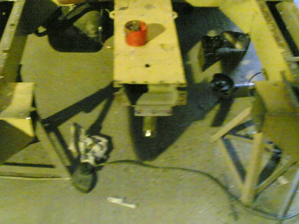

to add my two foot prop in with out alterations
i would have to alter the cross member that carries centre carrier
2 options in my case :?
1. alter cross member length that carrys centre carrier the one down the middle of chassis
2. fit cross member into exhisting one to make it look like factory and i will have to alter propshaft :?
well :o i took option 2 so i set about and cut the cross member out of cab side

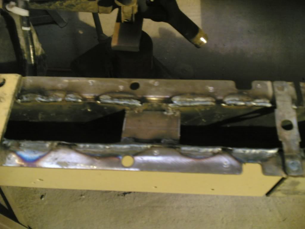

and un picked a section of the flat plate off the top of the chassis
so as you saw were i chopped chassis and i left cross member in , ive cut it out and left that section on the donour chassis :? confussed i am and im writing it
i also got two 4 ft lengths of steel pressed to sleave inside of chassis for strength
as you see the grey is donour chassis
and yellow exsisting chassis
so they both meet nicely the grey cross member is originaly the one were the yellow one is , so the distance between them is 27 inch 3 inches longer than propshaft but looks neater

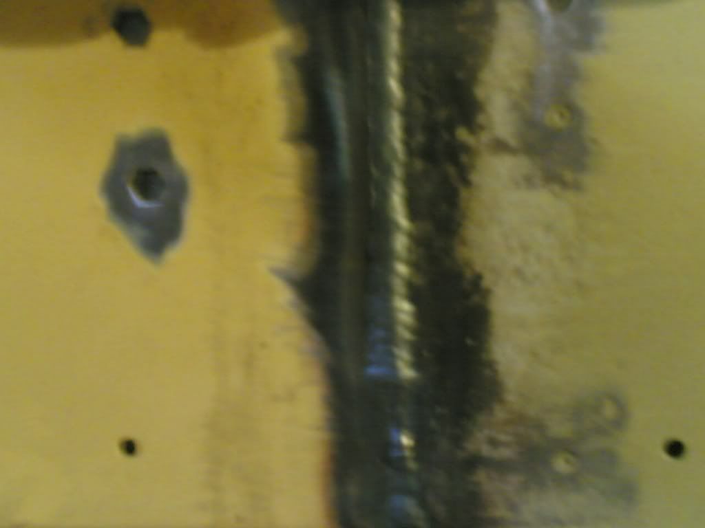

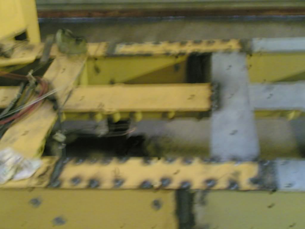

this is chassis cut ready for welding
this is chassis welded
this is the steel i got bent to sleave chassis welded
then i capped of with original plate
so propshaft to be extended 3 inches
dropped off to get altered measured between both carriers and they said they can sort it from there
well enough for today next step but prop on and axle on and into paint end for paint

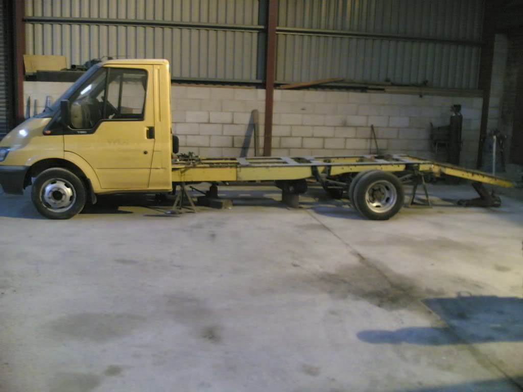

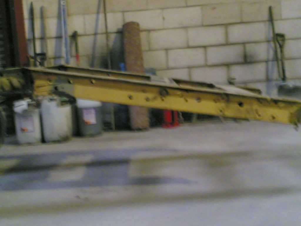

Postby ARTCARCOM » Wed May 02, 2007 1:16 am
also i forgot to mention the piece i origanally cut off were it norrows down
i welded on to back of donour chassis for the angle to accept recovery body which is next to build
which i got my angle from the previous recovery body i built on a mk 5 transit
then welded it up
ARTCARCOM

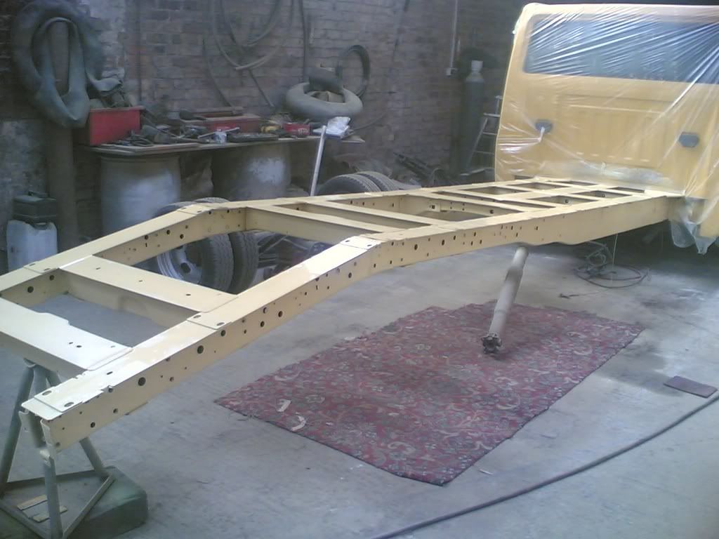

Postby ARTCARCOM » Wed May 02, 2007 9:01 pm
well here we go again fitted back axle and when i disconnected brake pipes i made a loop so had enough brake to drive and\ stop as havent got handbrake yet :lol: fitted new propshaft had a spot of luck :wink:
i bought a seperate prop when i bought chassis for the 2 ft section . well the slide i couldnt get off so left it on , for them to take off and went to local car shop and bought an extra cen tre carrier same as mk5 £24 .
so when i went to pick prop up and said how much he said :o how abought i keep this slide and you give me £20 cos ive put a new centre carrier on . well took me a bit of time to agree all of a second :lol: so i took the one i bought back and got refund so didnt cost nothing to alter prop
so pulled outside

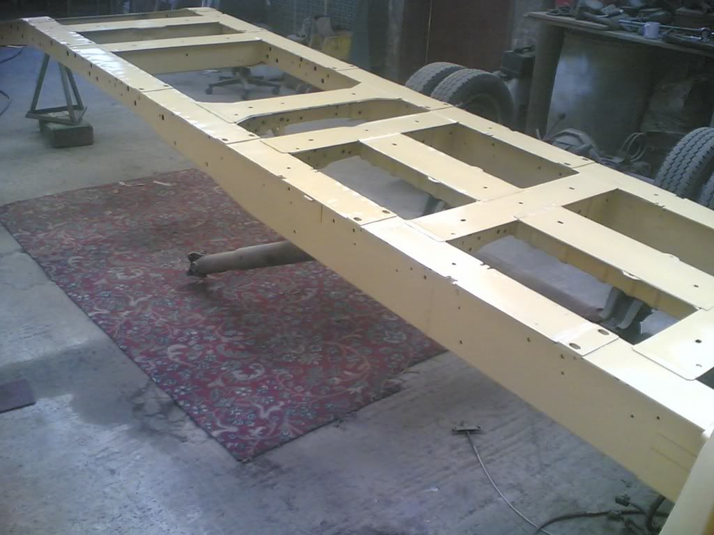

and pulled into the paint bay and stipped back axle off and prop to paint chassis
so primed welded areas with etch primer
then i primed it
and then i painted it[IMG]
looking ok now

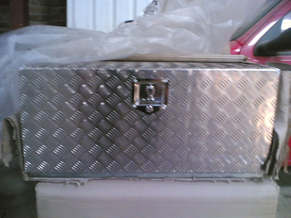

well i got it well i got 2 infact wife doesnt no :twisted: she wouldnt understand especially if told her how much 8)
great or what 840 long x 400 deep x 400wide
i have 2 plastic ones on my mk 5 and each alloy one is the size of 2 plastic ones
