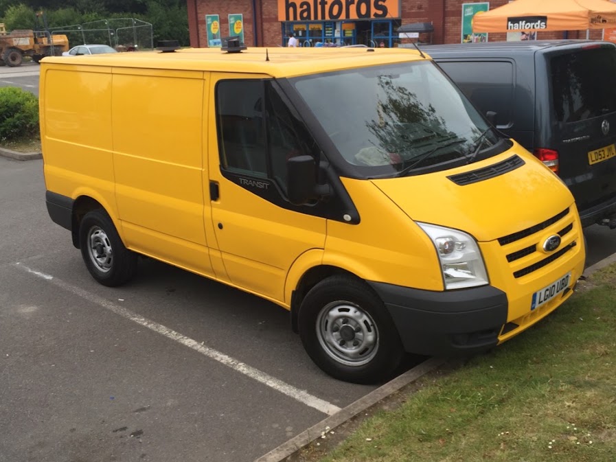

Been lurking for a while and did some work on my Mk6 to use as a support vehicle for trackdays etc. Recently I decided that i would start using my Van as my daily driver as my Fiesta ST is just too small to carry anything work related other than a lunchbox! I dont carry loads of kit but what i do carry I need pretty much every job. Only issue with using the Van as my daily driver is that it isnt very practical if i need to ferry daughter and grandaughter plus the Mrs so decided some months ago I needed to do a crew cab conversion. Now i truly love my Mk6 especially since Vantuner got his hands on it but the thought of ploughing over a grand into an 06 plate vehicle didnt really add up. I started looking around and eventually found this at the right money. Ex AA with a full service histroy, high miles but with regular servicing it should be ok (famous last words).
Chose this for a couple of reasons.
1. It has working ice cold AC!
2. Already has a crew cab style bulkhead fitted by the AA and the rear compartment has been spray lined over the ply.

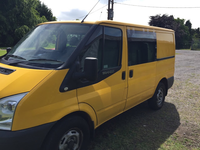

Picked up 2 side windows at the weekend so will be cutting the holes wednesday morning as long as i can find a tame window fitter to come out wednesday afternoon! Any advice on doing the cutting? Presume you just cut flush to the inner panel?

Cutting the windows this morning and then driving by to a window fitters who is going to bond them in for £50, decided that at that price on it wasn't worth doing myself really.

In the End another fitter locally called up and was in the area so I cut the holes and trimmed and he came to me and fitted for £30 which considering the PU, primer etc would have come to about £20 was a no brainer.
