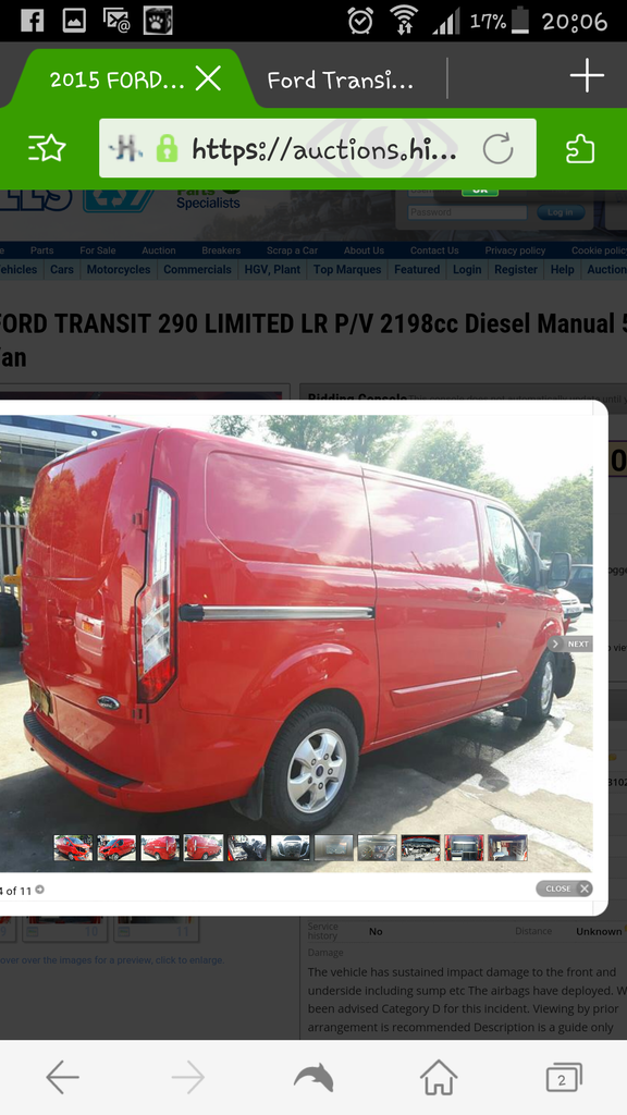

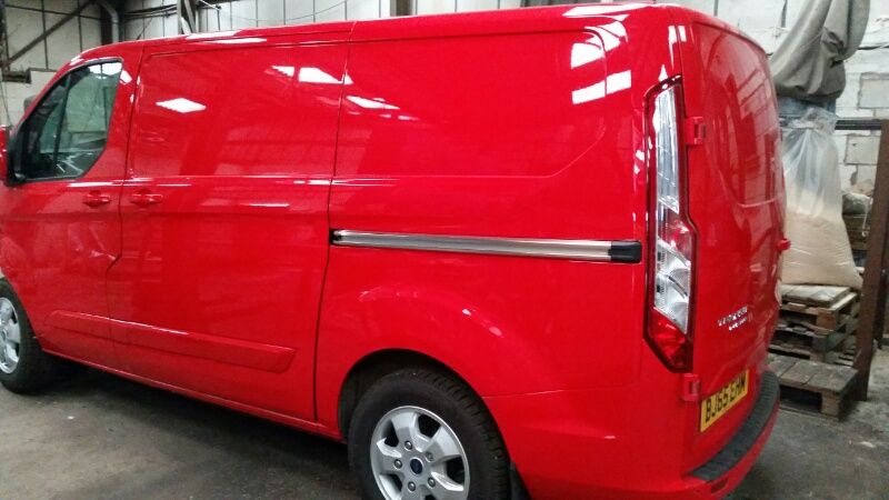

Bought a smaller newer van, 2015 custom swb 2.2 125ps twin sld race red ex Hilti van.
It is cat d 4995mls on the speedo.
That's it before any work done :-)

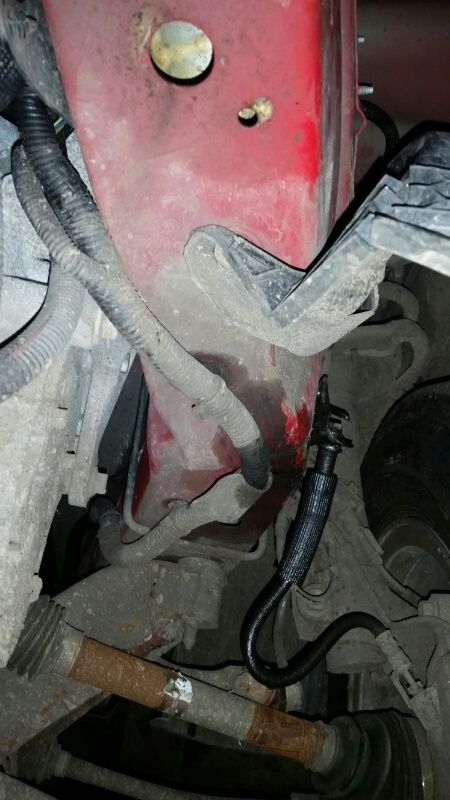

Things needed were chassis leg pulled-waiting on that soon.
The rest is parts, damaged items are.
Front bumper
Ac rad
Coolant rad
Intercooler bent and split.
Front reinforcement
Headlamps but i could reuse them if i needed to.
Various plastic bits.
N/s metal brake pipe sheared off at the union :-(
Wing is damaged.
Screen has a full length crack but it'll keep for 2 more years as it is below the wipers.
Inner arch liner.
Middle grille(could reuse but it looks a bit rubbish :-(.)
Radiator support.
Hub is bent, wishbone bent, tie rod bent, drop link bent.
Scratches and stuff on the front undercarriage (sub frame)
That's roughly it, mostly Lego :-).

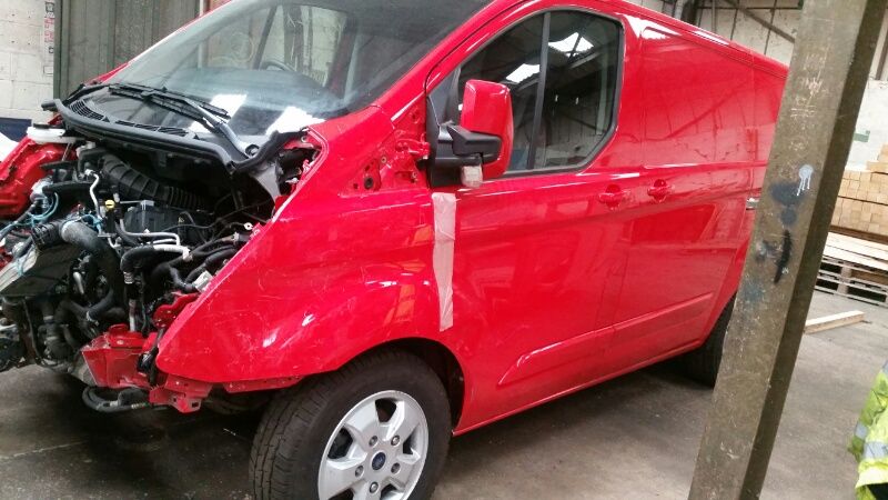

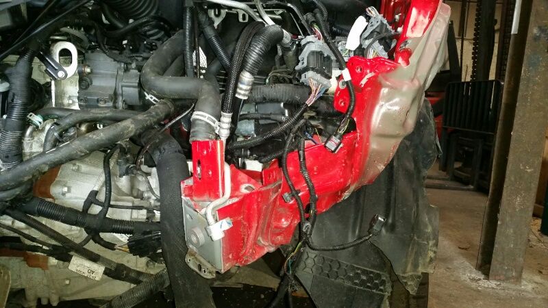

Postby loot » Sat Aug 06, 2016 3:09 pm

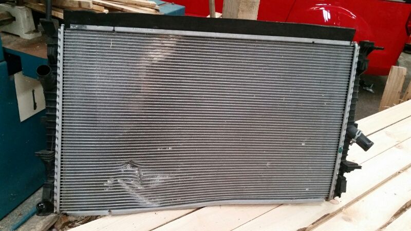

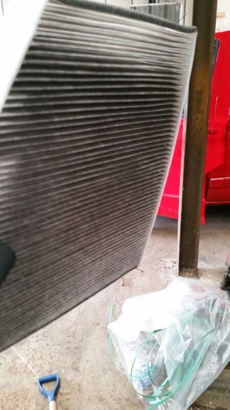

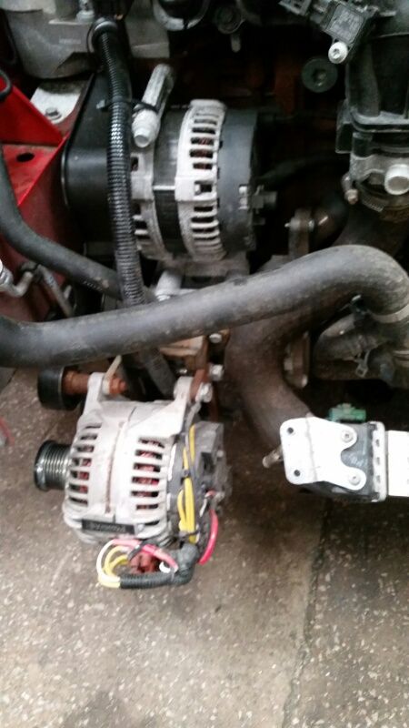

So i bought lots of bits as said, stripped all the front bits off to reveal the extent of the damage.
Cabin filter :shock:
Had to cut the generator belt off.
Anyone scared yet? :lol:
Chassis leg is bent front of anything structural and has pulled back the inner wing bit, the leg isn't crumpled fortunately so the plan is to jig it out and then repair anything, i can buy the inner wing panels for reasonable money from Ford and it is only skirted onto the leg.

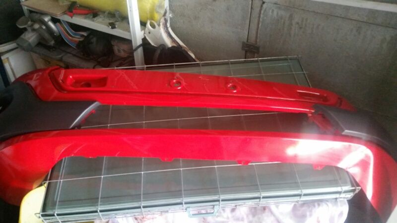

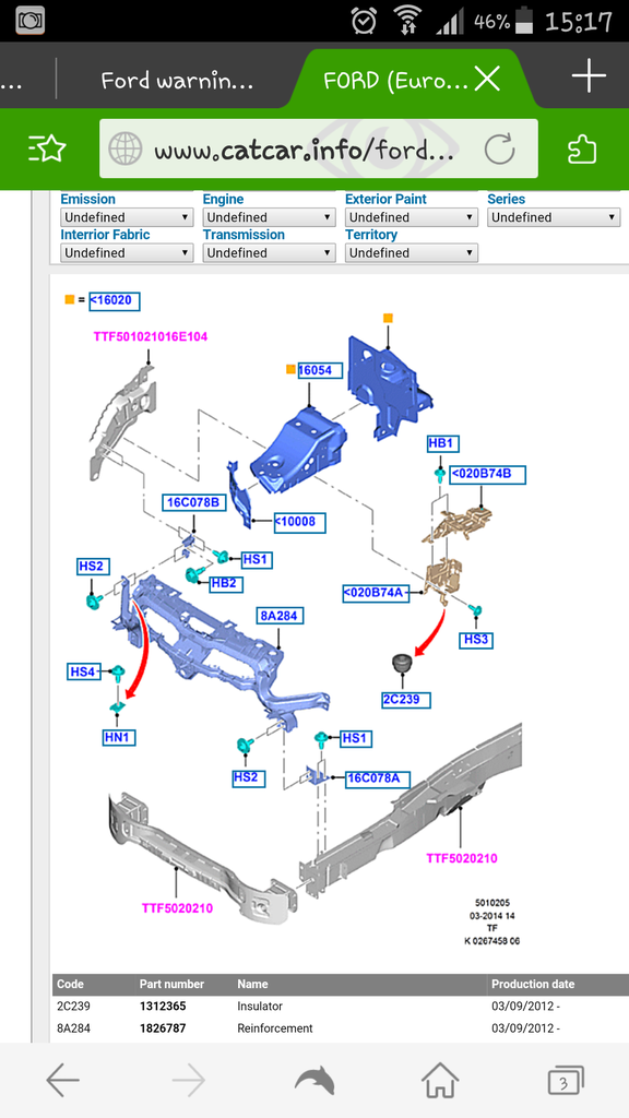

Postby loot » Sat Aug 06, 2016 3:26 pm

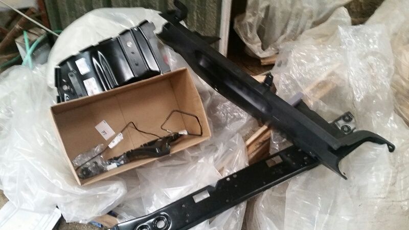

Scored a full sub frame with arb etc and n/s strut with caliper, disk, drop link, hub, wishbone from eBay so once fitted, geometrically the wheels will be square and true 8) the tell tale of the van being a banana will be the n/s chassis leg to subframe mount hole will be out of true, that said, it'll help us to jig the front out.
I got the above bits from Manchester and while i was there i scored the inner arch liner and the front metal bumper reinforcement. 8)
The custom is actually very well designed with front impact in mind :shock: most of the front is actually bolt on bits and the main reinforcement is held on by 4 bolts :lol:
Next i got a front bumper from Birmingham area. 8)
Major result on that i think :-)
The above items i had to drive to get tho so road trip with butties involved :mrgreen:

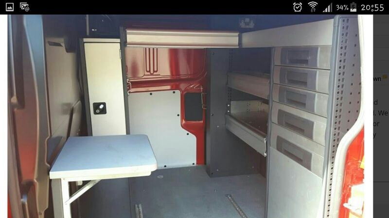

Postby ned » Sat Aug 06, 2016 3:42 pm

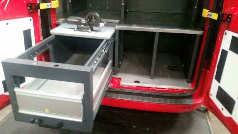

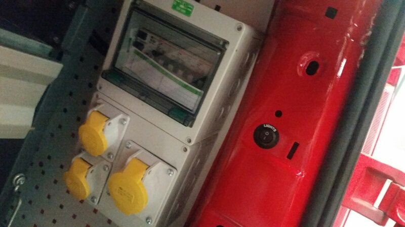

That's some nice racking in there useful very useful.
I wonder if the hilti driver still has a job :lol:. Looking forward to seeing the van finished in full. N

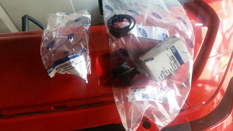

Postby loot » Sat Aug 06, 2016 3:43 pm

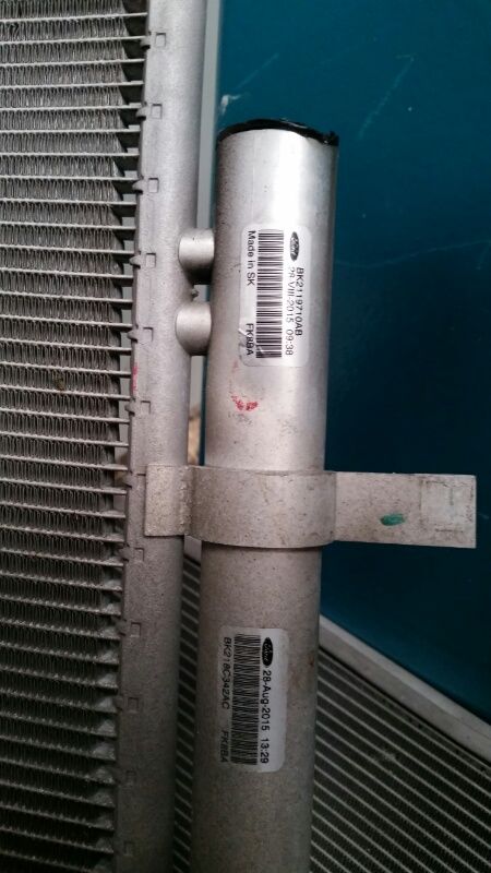

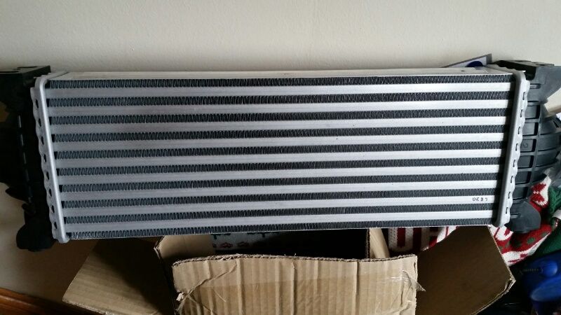

Bought bits from Ford, metal brackets, parking sensor clips, plastic bumper liners, radiator support etc.
I bought lots more but not taken a picture :oops: i bought the main front reinforcement and other bits.
Intercooler from eBay 50 pounds genuine Ford 8)

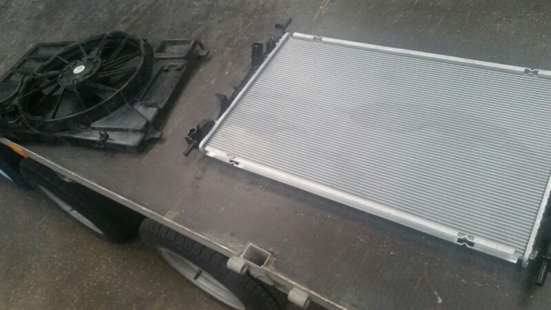

Radiator from eBay, nissens 85 quid but looks good quality no different from the Ford 1.
Reused my surround/fan is not damaged at all. :-)
Wing off eBay, it's scratched to buggery so will need some love and paint.
So most parts are bought now and i can't really do much more until the guy let's me take it to get pulled out.
Today i fitted the rad and intercooler and filled with water and ran it up to temp which worked perfect, this gives me the bonus of knowing that i can drive the van to move it about.

Postby loot » Sat Aug 06, 2016 3:44 pm
nedforceone wrote:That's some nice racking in there useful very useful.
Thanks :-)

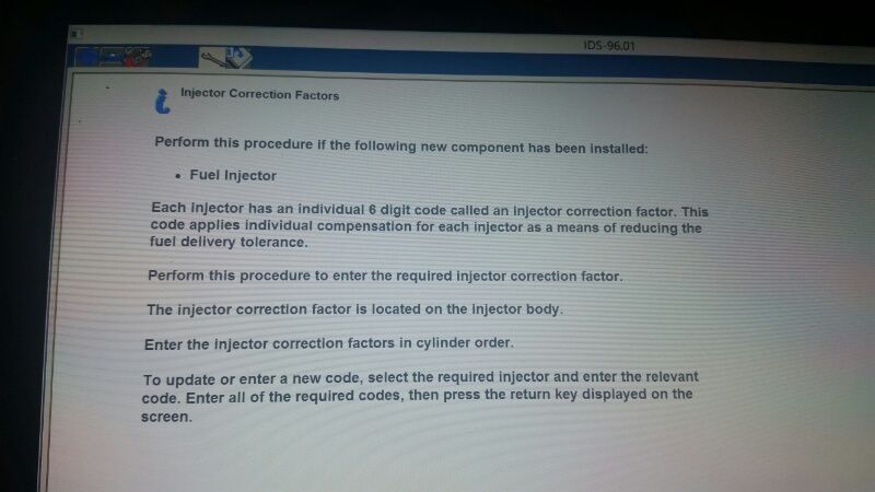

Postby loot » Sat Aug 06, 2016 3:52 pm

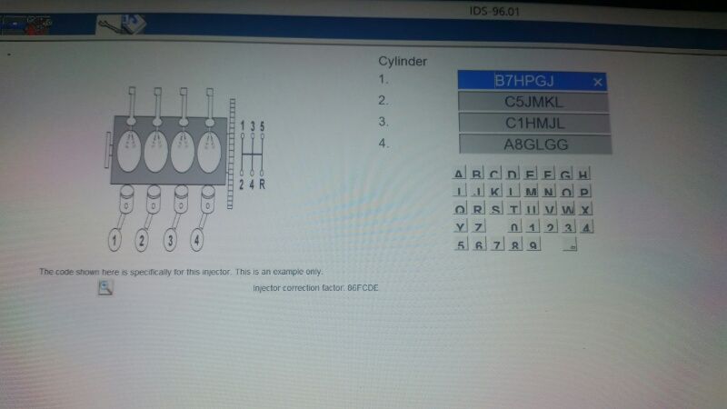

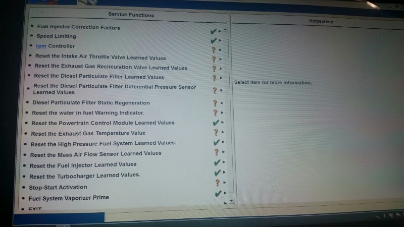

v96.01 ids on 2015 custom

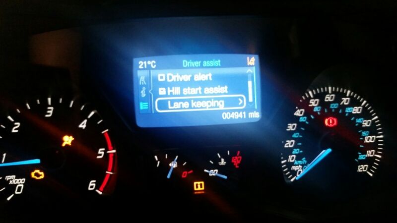

Now then since i was all done i thought I'd have a play with ids and familiarise myself with it and do some service functions. 8)
I have lane assist amongst other things so my van is nearly most top of the range 8)
Service resets.
Now this will blow your minds so be warned.
Injector correction factors. :shock: :shock:
Someone has been lying to us it seems :?
Not sure if these are needed or just standard numbers which aren't important but they're here anyway. :-)

Postby karl » Sat Aug 06, 2016 3:57 pm
the fuel systems is siemans isnt it ?
same engine as the 2.2 rwd mrk 7 ?
karl
Tranny Lover!!!
Posts: 8965
Joined: Tue Jan 08, 2013 9:03 pm
Location: manchester
Re: Red
Postby loot » Sat Aug 06, 2016 4:02 pm
karl wrote:the fuel systems is siemans isnt it ?
Yes but i thought you didn't need to code injectors?
56 350 2.2 130ps mk7 with 2 side doors 8)
65 290 2.2 125ps custom with 2 side doors 8)
07 350 170ps
Ids v86 licence + v86.04 update + xprog here
Ids map here
loot
Posts: 34202
Joined: Sat May 05, 2012 6:06 pm
Location: North Wales
Re: Red
Postby karl » Sat Aug 06, 2016 4:08 pm
i had to on the mrk 7 2.2 rwd transit :)
karl
Tranny Lover!!!
Posts: 8965
Re: Red
Postby loot » Sat Aug 06, 2016 4:09 pm
Euro 5 :-)
