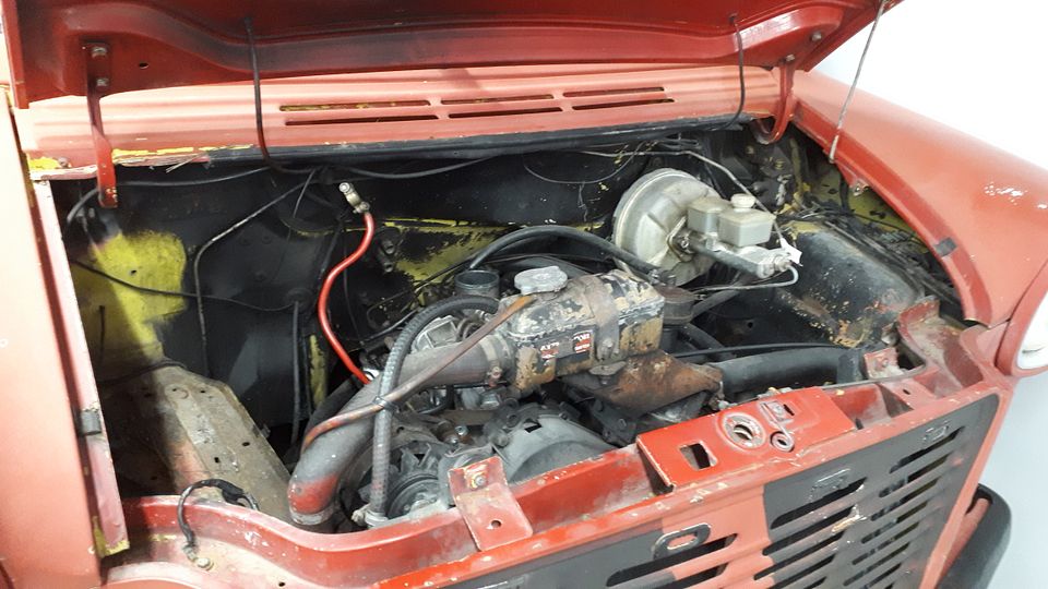

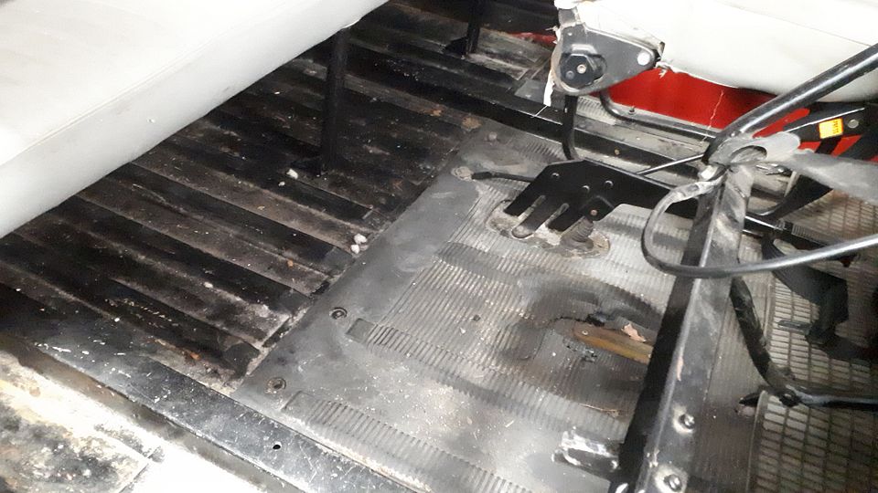

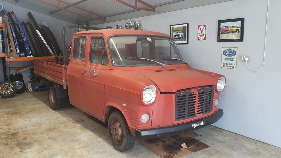

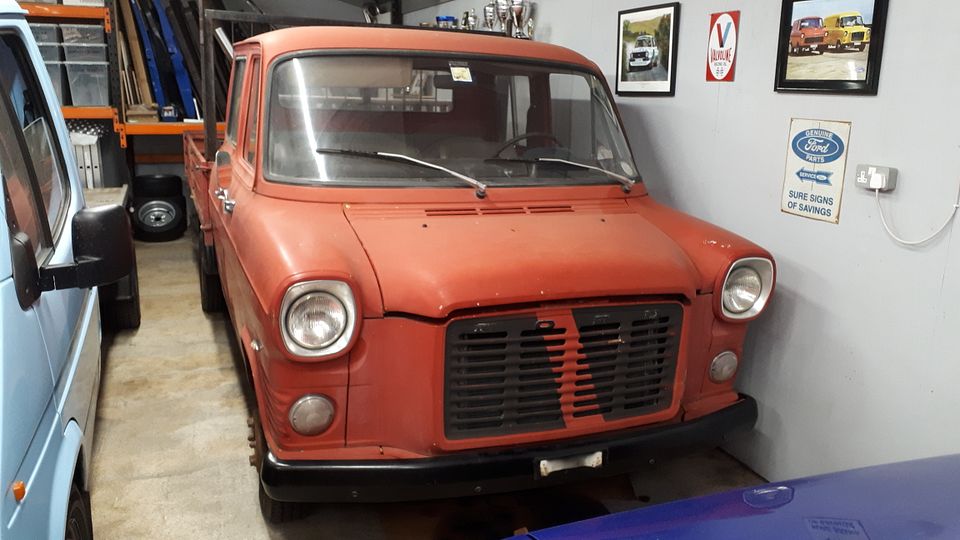

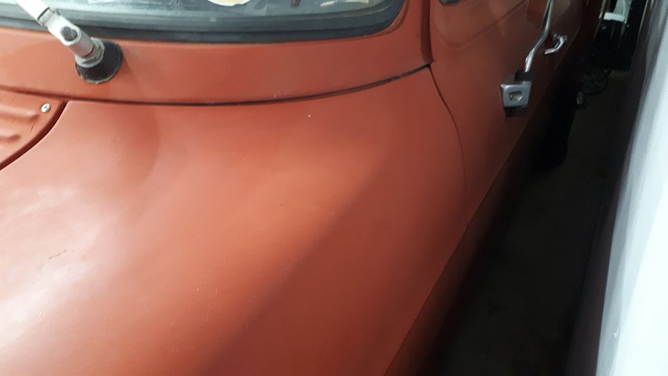

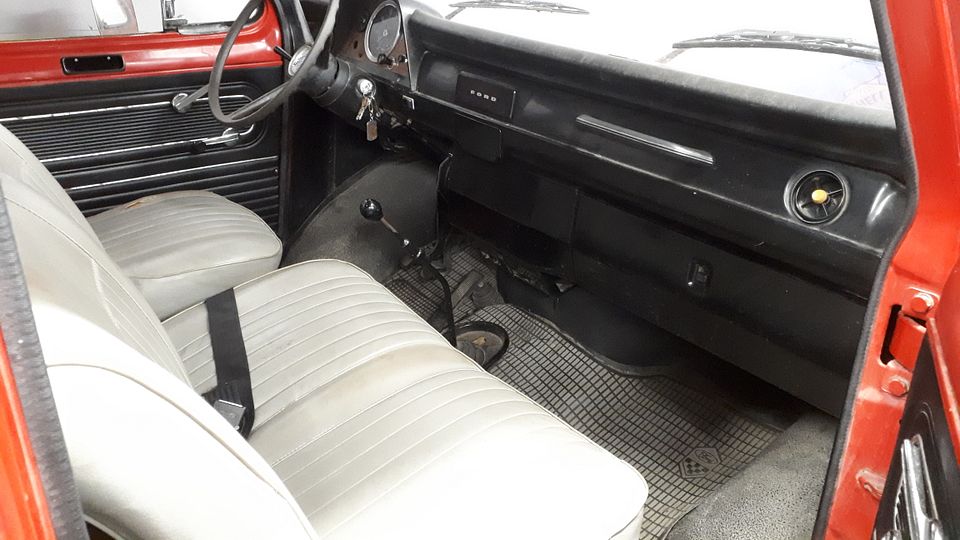

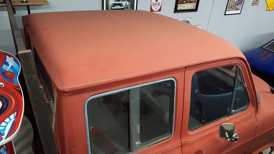

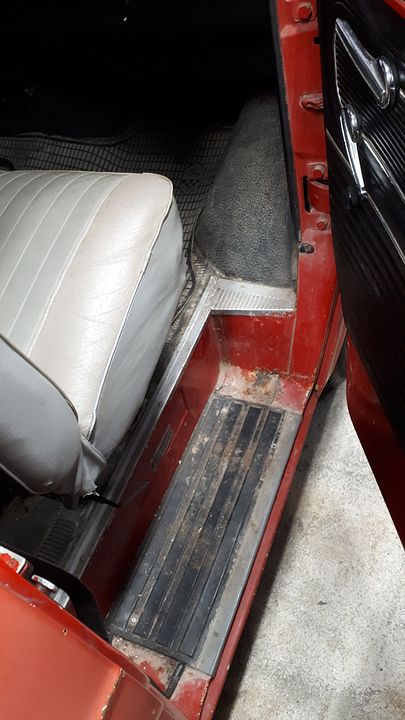

heres a few pics of it as it sits........

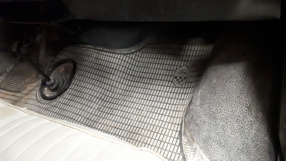

ive never seen one of these genuine overmats before....guessing its there from day one......its certainly done its job as the original mat underneath is in perfect condition.....
as can be seen in the pics, the cab is in really good nick and the chassis and underside is much the same story, so im really looking forward to getting stuck into this one....
