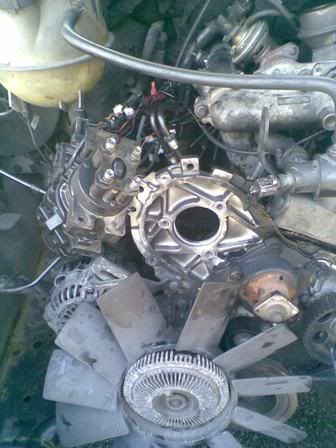

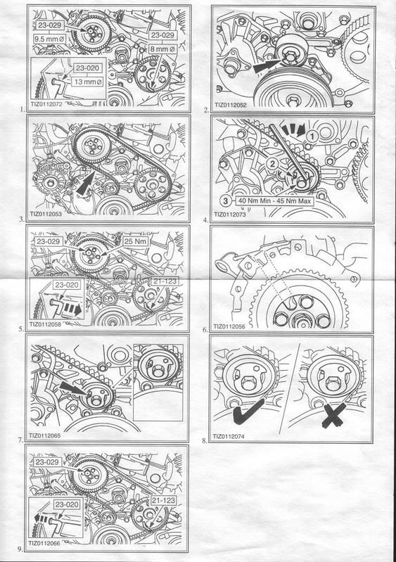

Started the dismantle on Saturday, Radiator off, can't figure out why they designed the timing cover so you have to take off the waterpump pulley first before removing it ?! The tensioner is a weird set up I’ve not seen before, spring loaded with an allen key slot, presume it will be a sequence of tightening the bolt and engaging tension with the allen Key, Anyone any ideas?

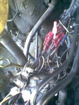

Pump came off without a hitch, but what a nightmare with the wires at the back of the pump looking like a right birds nest. I thought that someone had just hacked into the wires, instead of unplugging from the back of the pump, but when I got it off the wires are moulded into the back of the modules, which I couldn’t quite believe. Surely a wire hatchet job isn’t required whenever a new pump is fitted.

I've taken some pictures which I will post later. The bundle of wires on the pump is quite amazing!

thats a new type tensioner you have
heres how to set it
