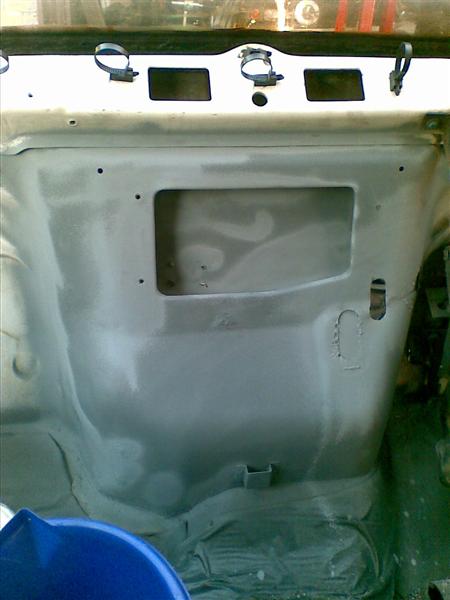

Postby jay » Sun Feb 01, 2009 8:19 pm
i measured the mk5 bulkhead and cut a hole for the heater pipes,i fitted the box with 2 of the boltholes as they lines up and drilled the plastic to fit 1 of the bolt holes and used a self tapper to fit the top right bolt hole to the bulkhead.the dash fitted ok but had to jiggle the duct pipes a little as the box is a little to low but seems ok.I checked to make sure the heater pipe hole is air tight by leaving a torch inside the cab while sitting in the engine bay looking for light,Which i didnt see,and if i did then it would have been out with expanding foam sealant.i filled the gaps on the bulkhead up by the screen with expanding foam to keep the noise down a bit more and i used the mk5 sound proofing instead of the mk3 stuff.

Postby dark legend » Sun Feb 01, 2009 10:08 pm
Have you got a gearbox in at the moment? The Mk5 stick is a different shape to the Mk3 (mk4?) to miss the heaterbox, may be worth checking out to make sure it will still miss if it's a bit lower.
How did the Mk5 soundproofing fit? I looked to use it but it seemed to be a different shape around the centre / fan bit.
I found the holes for the matrix pipes were just on the edge of the double skinned section so it's tight on the engine side for the pipes to fit.

Postby jay » Sun Feb 01, 2009 11:27 pm
i did a measure up and the mk5 stick if used with the mt75 is a little tight on the heater box and will need bending a little..but i am using a type G 4 speed box with overdrive and it does look like it should fit if a little tight (it might need bending about mid way).I also found the heater pipes are right on the edge of the bulkhead corner but as i have cut a bigger hole the pipes fit ok I am making a rubber grommit for the engine side and will stick it in place behind the soundproffing.
