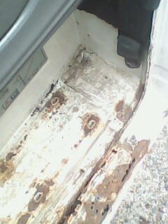

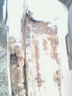

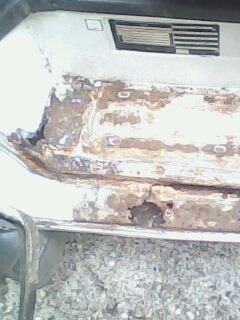

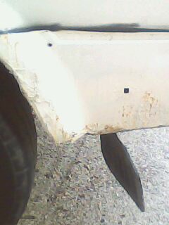

Well it hasn't been a very good day for me and Lola :( After getting the panels ready to be painted I started to do the same on arches and steps and look what I found :cry: :cry: :cry:
Image Image Image
Basically the a***hole who sold me the bus has filled EVERYTHING with filler and painted it with several coats of hammered paint :x :x I saw couple of bubbles and trying to get them of and sanded, rust and mor rust started to appear and now it feels like the end of the world... :cry: :cry: That's just one side of the bus, poor thing. You can see it in these pictures that you don't see anything and then you dig and scrub and voa la

I wanted to wait with welding until I get home so my grandfather can sort this out for me, but now it looks like I have to do it myself asap. Any good soul out there who can show me how to do welding? I am reading about it but it would really help if I can see how it's done in practise... :cry: :cry: Hope I don't have to remove the whole thing...

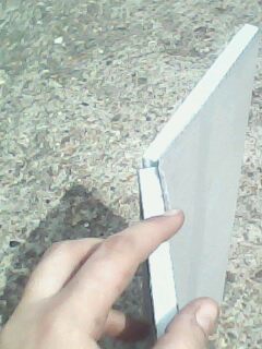

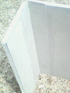

Luke wrote:i'm putting (well planning to) a shower in mine - it's not full height be it'll be ok for emergancys - we'd have to sit down to shower :D it was the last job i was doing before i stopped work on it for a bit :) link to my thread here i was going to line toilet/shower room in the polypropoline shown in the thread but i cant find anything to seal the edges everything just peals off :? - so i might have to use something else :? to stop moisture getting in the van it'd be fully sealed and have an extraction fan in the top :D
Mine is going to be "sitting" one too, because I don't have high cube, so tall people like myself will either have to loose their head or sit down. But I think as emergency shower it is suffiecient enough. I am using waterproofing insulation boards for the floor, walls and maybe the ceiling too, haven't decided that yet. These boards will be replacing the side panels and the corners will be waterproofed with paint on waterproofing system (not sure if I can name brands... :oops: ). It's light weight, flexible, easy tu use and remowable as a whole panel - given that each time I remove the shower unit I will reseal the joints. This is the stuff

That's just a sample I'm holding to give you an idea. I like this solution, because I don't have to think about any additional insulation for that corner and those panels are ready to receive lino tiles, or wallpaper or paint... Simple things rule the world. :wink:

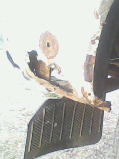

With breathing difficulties I got myslef to remove the back bumpers. Theeere it is... as expected :evil: :evil: :evil: Here you see thick plastered filler painted roughly, I would cut the hands off of this guy... :cry:
Image Image
And then I removed the other side... well removed... When I realised the whole thing is holding onto the body with SILICONE I sort of knew what was coming
Image Image
:cry: :cry: :cry: :cry: :cry: At this point I found myself literally crying... :cry: :cry: :cry: B@st@rd trade seller and silly me trusting the MAN!! :evil: Now I have to get the welding training because this can not be ignored. :( Can you see from that picture that it all started with a screw hole?? If only that was painted BEFORE the screw went in and was left there to rot. :cry: Poor Lola... I have a see-through filler transit. Do I replace the whole arch or do I weld it? Anybody has any advice?

Postby Luke » Sat Jul 04, 2009 6:04 pm
it might look bad but dont worry too much :| none of that is structural and you can get panels quite cheaply for the transit :D
have a look through beevers website (theres a link from the banner in progress section) and price up the bits - depending on the rest of the arch you might be able to patch it - but the bit behind the rear wheel arch and the sill - weld new panels in :D

Postby Nadjenka » Sat Jul 04, 2009 6:12 pm
Luke wrote:it might look bad but dont worry too much :| none of that is structural and you can get panels quite cheaply for the transit :D
I am worried that I see only the bits that came through the paint. And there is much more which I can't see. I didn't remove the drivers step yet. Still can't get over what was on the passenger one :cry: . That's why I would like to meet someone who has seen loads of rust to look at it and tell me what needs to be done and if there is any more of it in places I can't see. On one side I can see there has been welding done but only from the top, the bottom is like a paper. I have no idea how this works and what it should look like...

Postby MinorMatt » Sat Jul 04, 2009 6:27 pm
I have to say none of that rust is the end of the world... You didnt see my passenger door step at the ACE did you? I stepped on it and it collapsed!
The problem with transits is that they rust :twisted: badly.
Have you got somewhere you could weld (bright light etc) without people complaining? Its a bit of an aquired skill but once you get the hang of it its not hard
