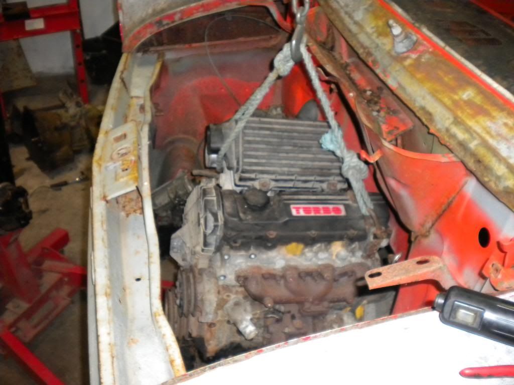

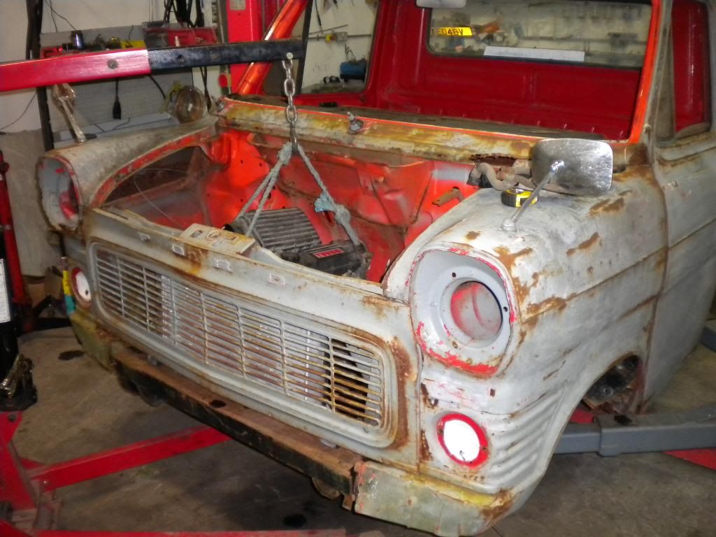

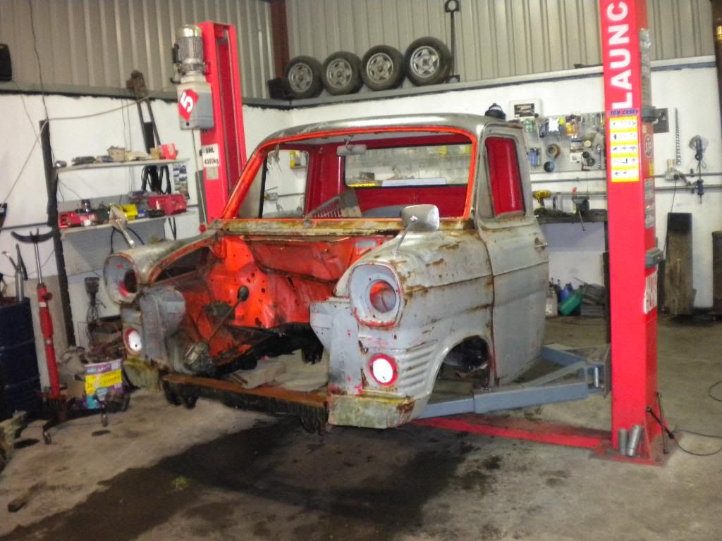

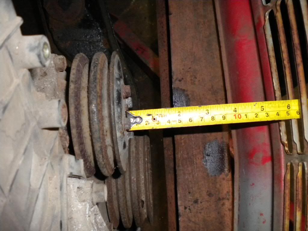

after curiousity getting the better of me for the last while i decided to pull in a mk1 cab i got for breaking to mock it all up!!

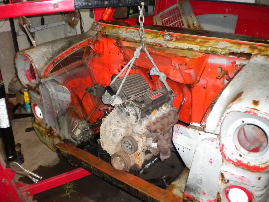

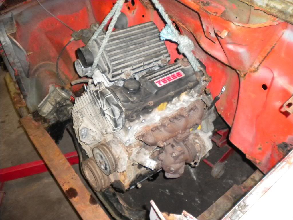

first i just dangled the engine itself in there to see how it shaped up. first impressions were good!

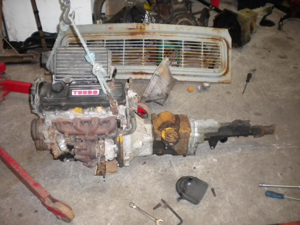

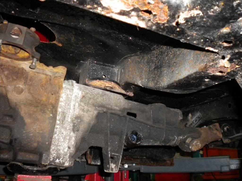

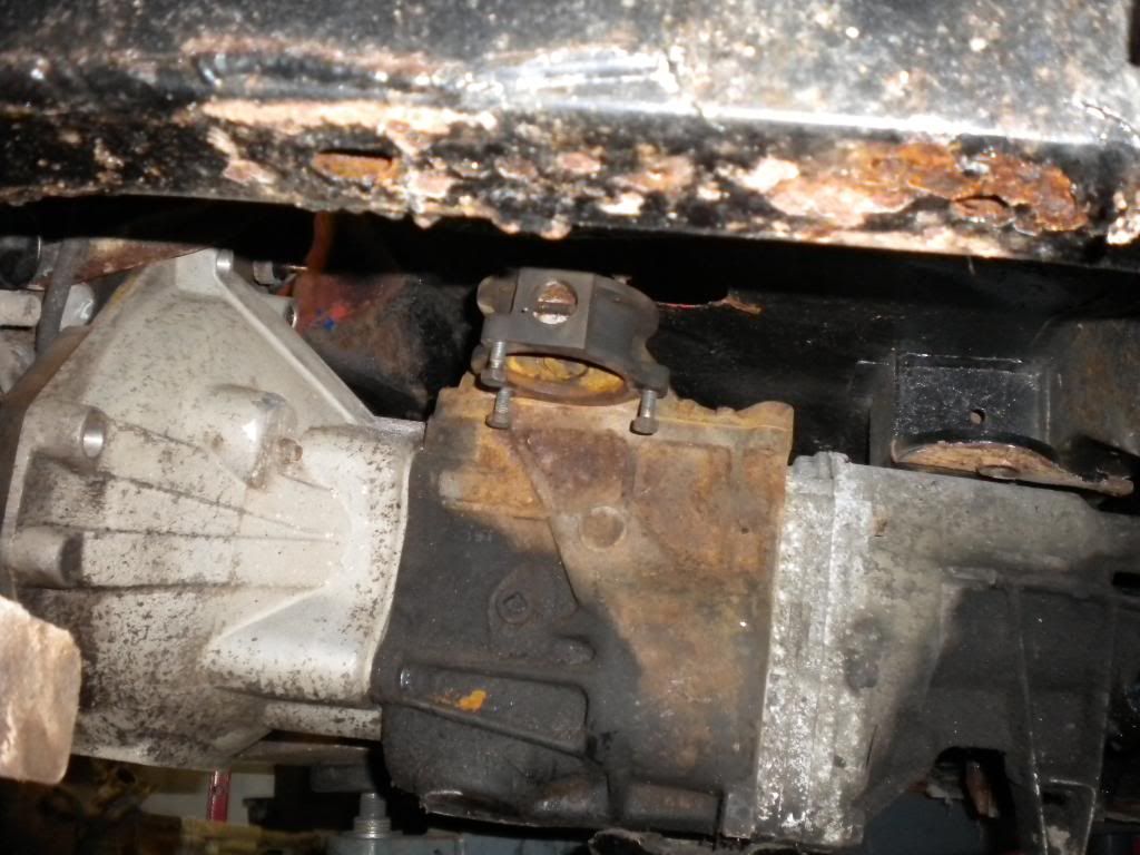

so using the bellhousing i coupled up a tranny type 9.....i know a lot will question this, could always make up a plate to mate up an mt75 if it came to it!!
engine and box in place more or less in correct position.

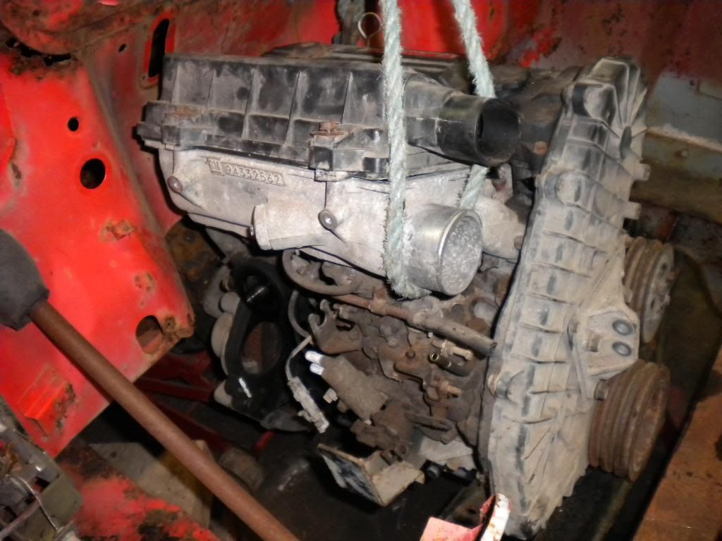

i just bent up the hanger tabs for the mk1 box for clearance ( the beauty of using scrap van for mock up!!) the gearlever also lines up with hole, would look original inside using type 9.
oil filter fouls a little on drivers side but could get round this handy enough id say.

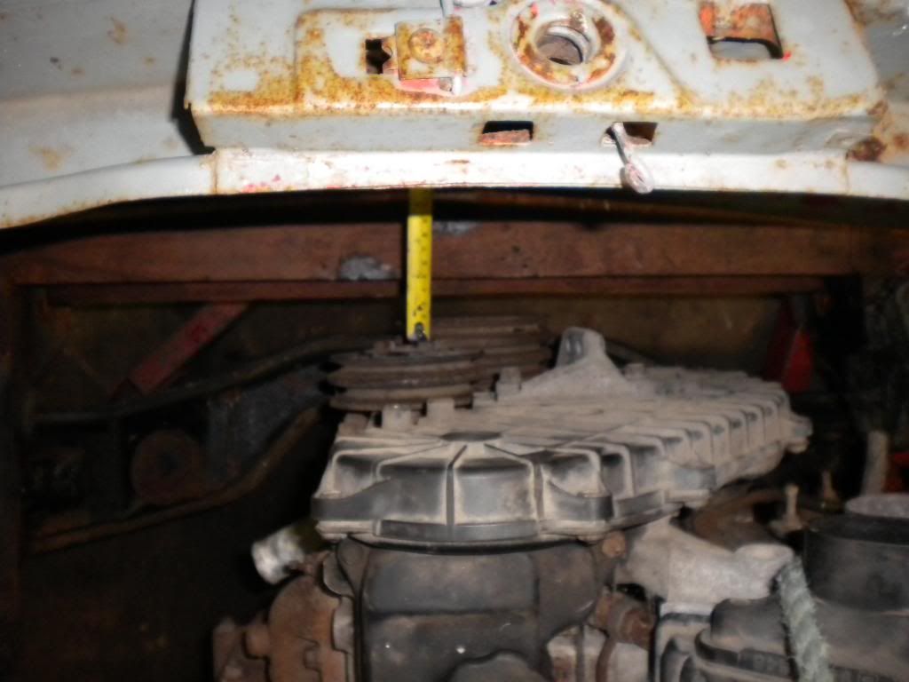

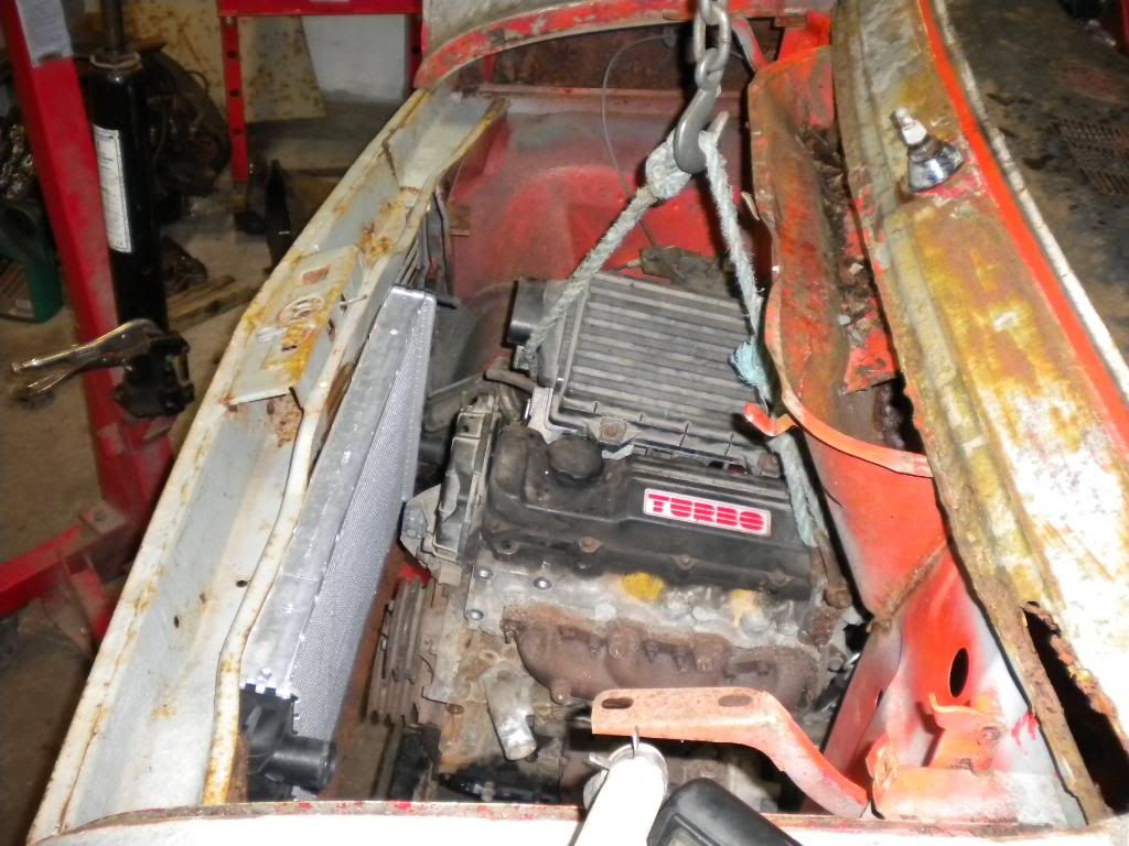

the most impressive part is the clearance up front when the front panel is in place.
even a mk5 di rad fits comfortably with room for a slimline fan on front id say!

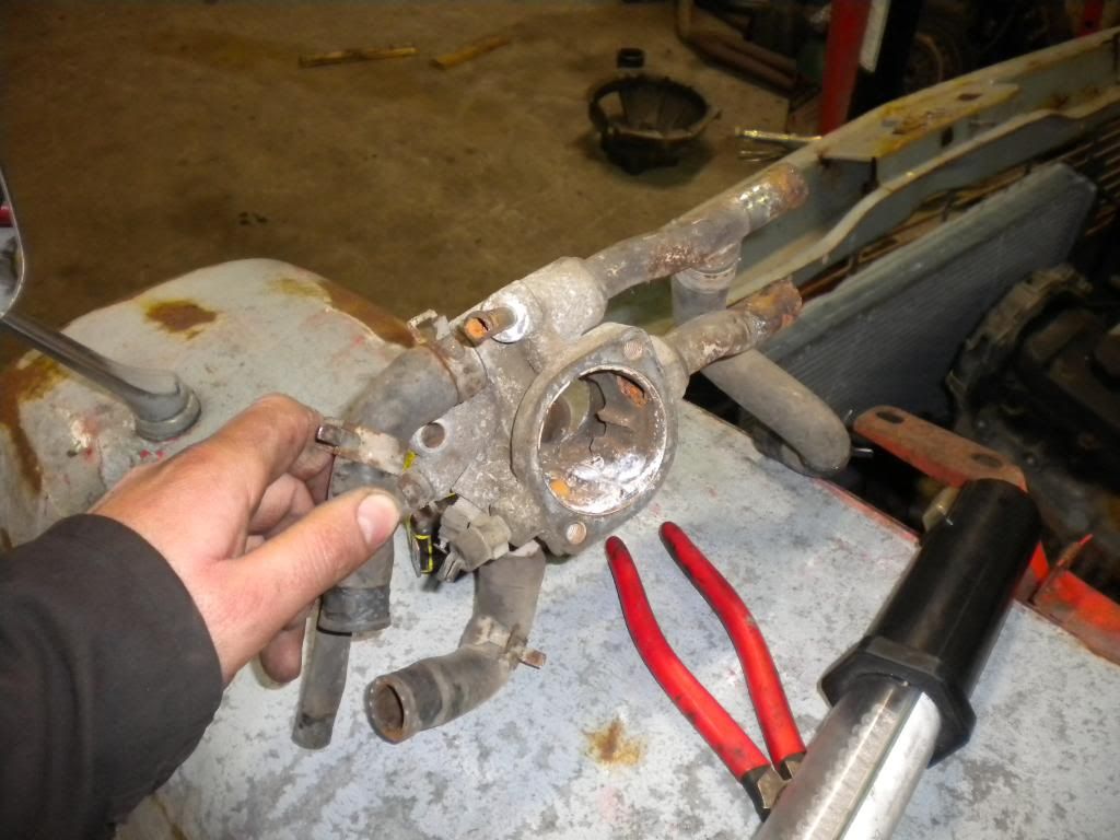

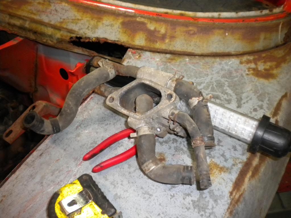

like the escort van, one of the biggest hurdles will be the cooling system, the thermostat housing and mass of pipes on the back of the head will be a pain to deal with but not impossible i hope!!! :!: :D
i figure if i can get it to work out in the escort van, the tranny ill be a lot simpler, for a start the sump shouldnt need touching as there should be plenty of clearance from the axle etc.
