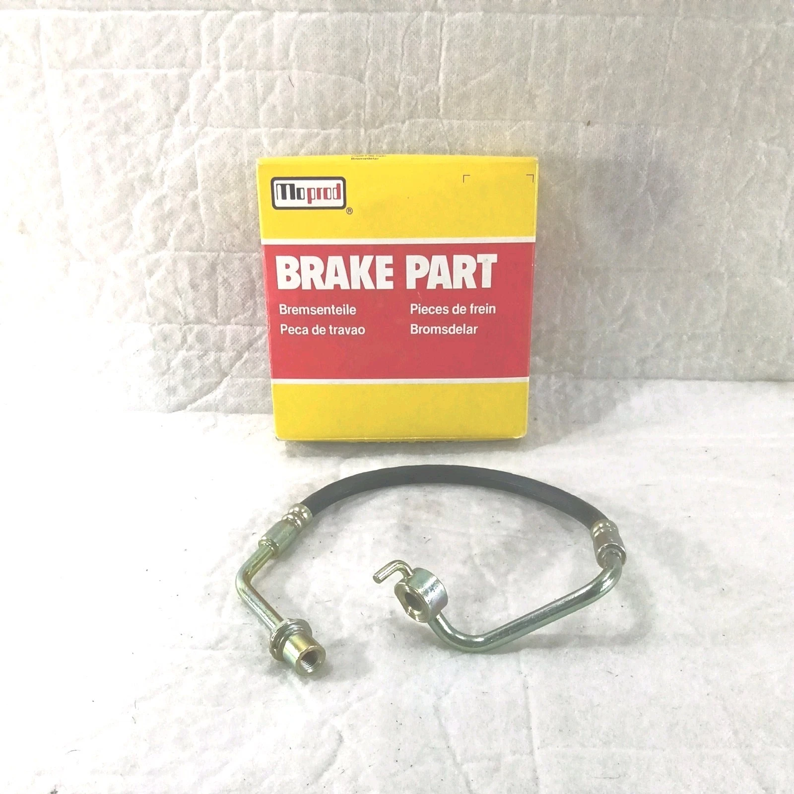

Just saying --the mk2's seem to have a bent into a shape metal pipe at each end that is 3-4 inches long .. this is for a reason .. so maybe putting any hose on will result in it rubbing on something

Yep bends are there for a reason.
Hydraulic specialist would be able to copy the original.
Braided would need a bit of fettling.
