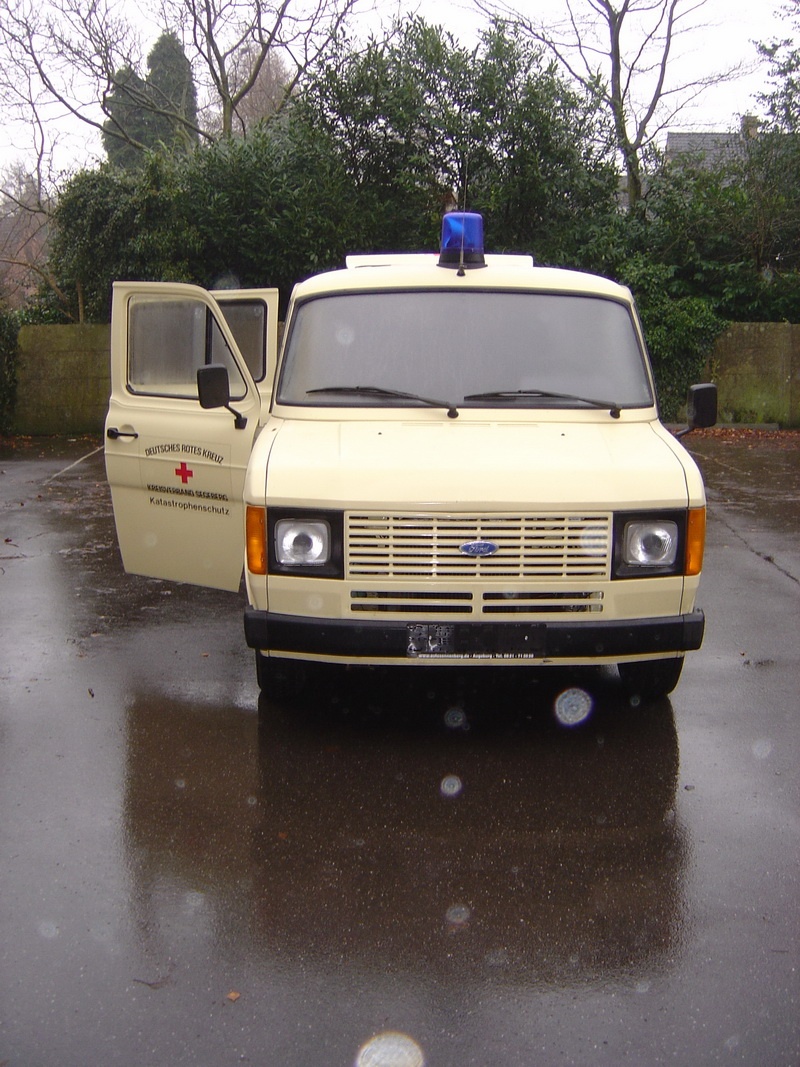

As I've written in the new member area I have just bought a 1983 Transit people carrier (ex German Red Cross) in mint condition with only 30.000 km on the clock. It is a beauty and we hope to be able to use it for many years to come.

I inspected the Van before I bought it and it is obvious it has been kept in a warm and (not too) dry place because all plastic and rubber parts of the interior and under the bonnet look great. I checked for traces of wax in the holes in the doors but did not see any so it probably has not been wax-treaded ever.
I don't have a garage to store the Transit and it will rarely be used. My motorcycle is my main means of transportation and my wife will only use the Transit if our (13 years old and @ 350.000 km) Audi A6 Avant 2.5 TDI is too small and when we go camping so I think it is wise to spend some money on rust proofing now rather than wait for the rust to come.
So my second question is: which kind of rust proofing would you advise at such a mint old-timer?

Congratulations with Your new van. When I bought my 1974 Mk1 Firevan it had been sleeping in garage for over two years. Sadly when the brakes are not used for such a long time the brake fluid can attract water and the brake cilinders will start to corrode. When the brakes are applied than after a long time the cilinders will start leaking. I had to replace all six wheel cilinders because one after the other failed. Soon after the wheel cilinders the master brake cilinder failed. Don't worry, all is still available and You may be lucky, but You should replace the brake fluid right away, bleed and check for leaks.
Furthermore check the king pins for play and grease them through the nipples. Also check the rear axle oil level or replace the oil.
Transits can be real rust buckets, but the German service vans are usualy well maintained.
Check for rust around the steering box attachment. Thouroughly clean the underside, remove existing rust and treat it with a rust converter or Hammerite and than coat it with a flexible bitumen underbody cover. Seal the all the hollow spots and chassis rails with a penetrating oil.
( I myself used Valvoline Tectyl ML, but ther are many other brands.)

waxoil in the chassis rails and underseal on the underside :D
have a read of this post :arrow: viewtopic.php?f=5&t=39539 it's in the mk6/7 section but waxoiling is the same no matter what transit :D

Getting the van registered was no problem, my mechanic checked everything and changed some hoses (both gasoline and break-fluid lines the last one was a bit hard to find the right type) and make the brake calipers work well again but apart from that it is in great condition.
Ordered a set of white-walls (I just had to do something to make the wheels show and the Cooper whitewalls were cheaper as the other brands of standard tyres they could supply) and in a few weeks time the van is going to be Dinitrol'd to perfection 8)
Now the question: before it is Dinitrol'd I'd like to add a towing hook but my garage says they (Brink) can't provide towing hooks for a MK2 anymore. My garage does not like the idea of using a second hand towing hook (if I could find one) and I see www.oldcars.de has one in the catalog but it is expensive and I think P&P for a towing hook will be sky high :cry:
So my question is: any idea's where I can get a new towing hook that fits a Transit 100 Autocar SWB?

With a bit of handy-work from your mechanic a towbar designed for later build Transits can be made to fit! The width between the frame rails has remained the same for over 30 years.Ask Luke. :wink: By the way , matt glass windscreens suck :lol:
