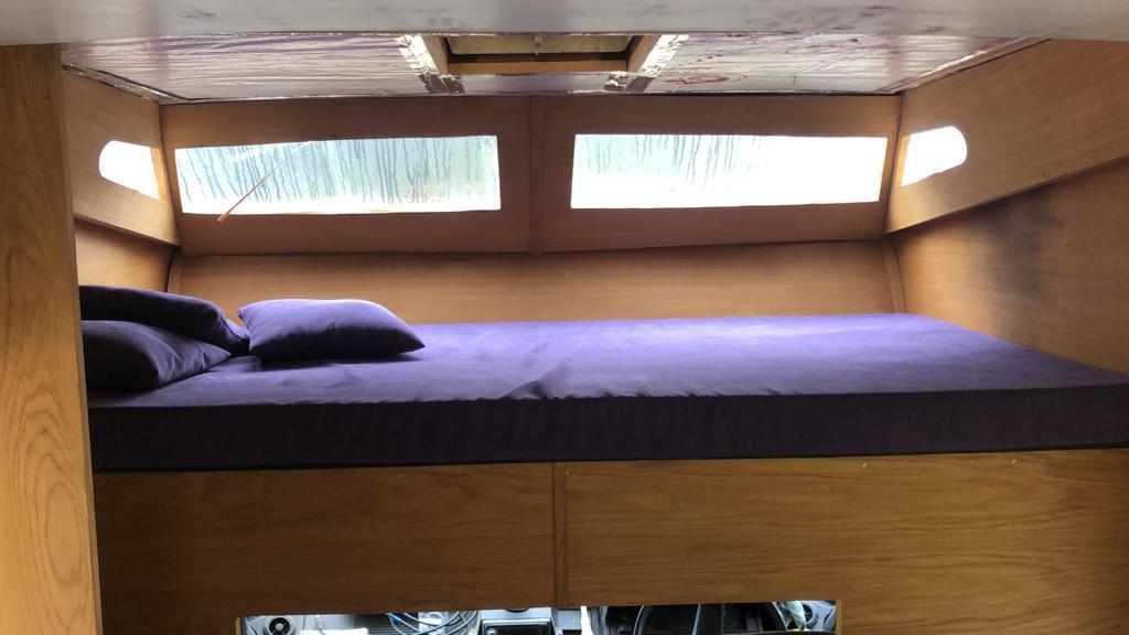

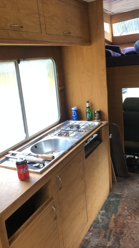

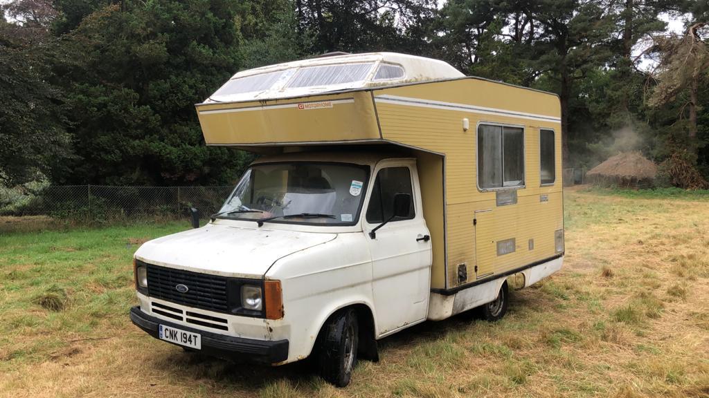

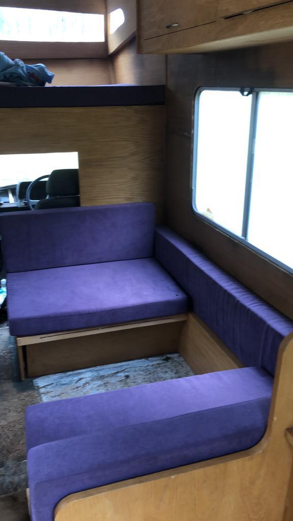

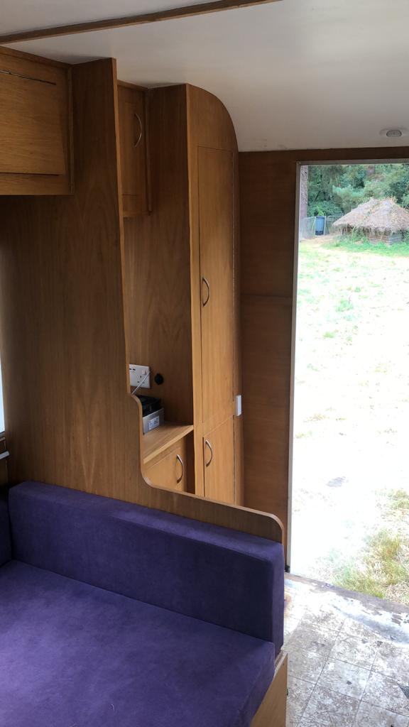

Postby jckm2000 » Sat Dec 19, 2020 10:09 am
Thanks for the replies!!!
Here's some pix,
Not sure if it's a 100 or 120, haven't got the v5 yet and it's in storage, in the dark ;)
I'll not be starting this until at least March but want to get plans sorted, parts sourced beforehand as much as is possible/sensible.

Postby Neil » Sat Dec 19, 2020 12:11 pm
lifting that up will give it excess sway

Postby Keef » Sat Dec 19, 2020 1:33 pm
It's got a revenue weight of 2375kg. I'm sure someone on here can tell you if it's a 120 or 100.
I'd look into getting firmer springs from Midland springs. They shouldn't give any increased sway over your current worn springs, they may even improve it.
