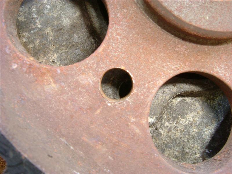

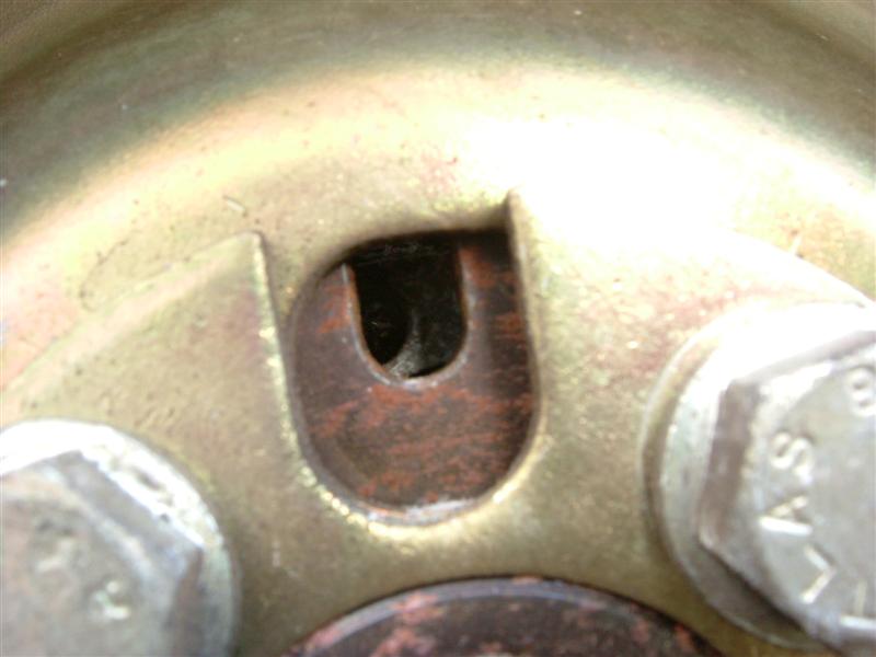

That's with the flywheel locked with a 12.5mm drill bit, perfect fit, no play in the crank pulley. It was exactly 1 tooth out (advanced)
Timed it back up with a new belt on this morning and I could tell it had sorted it without even driving, back to a nice quiet sound, could hear the turbo spool up properly. Just come back from a test drive and it's perfect again, pulling like a train!
