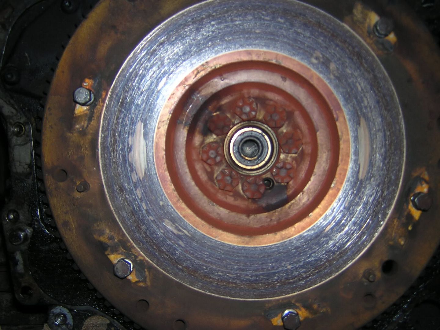

From what I remember when I was playing with the clutch and flywheel, there is only one hole big enough to accept the timing pin (oo-err), there are other holes of smaller diameter, so if you are using the correct pin size and its installed fully, then the timing is correct.
Here is a very bad pic of my flywheel http://i226.photobucket.com/albums/dd19 ... ywheel.jpg Timing hole bottom right.

yer guide is spot on, very clear and concise. it is the old style tensioner on it, pennies are tight so i thought i'd save on that. i repeated the steps from yer guide. set tensioner back, fit belt, undo tensioner nut to allow it to tighten up to the belt.
yep all bits/pins correct size and def. going fully in no way of mistaking it. so i'll take the timing as ok.
