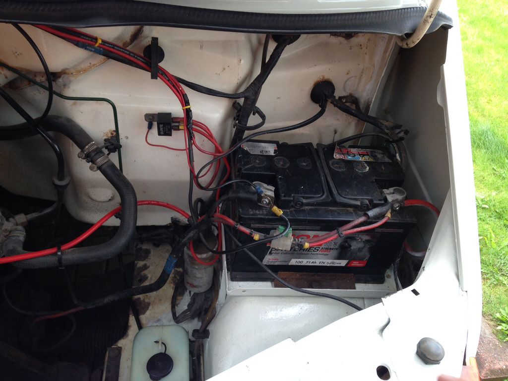

Have just removed this mess of split charge wiring and under spec relay with a far uprated system including 140a voltage sense relay and 16mm wiring. Didnt take an 'after' pic sorry, but it is far neater !
Also found that the leisure battery (dated 2011) is leaking - since the recent rebuild there is fresh corrosion/white powder/bare metal on the battery tray. So that is going to the skip. Bet that's what caused the inner wing to disintegrate in the first place - Grrrr ! New battery will get a proper vent tube.

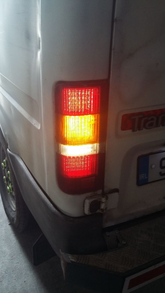

Built and fitted full L.E.D. rear lights behind the standard lens
Yes they look great at night
Yes they were dear
Yes, oh God Yes, they were a bitch and a half to make

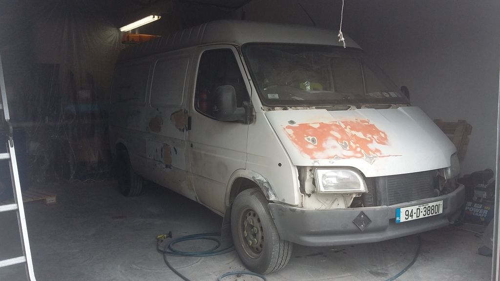

Then started the strip down, full rebuild and respray I've been promising the old girl since I bought her 5 years ago.
I'm hoping the fact that she's still taxed, tested and insured will encourage me to hurry up
